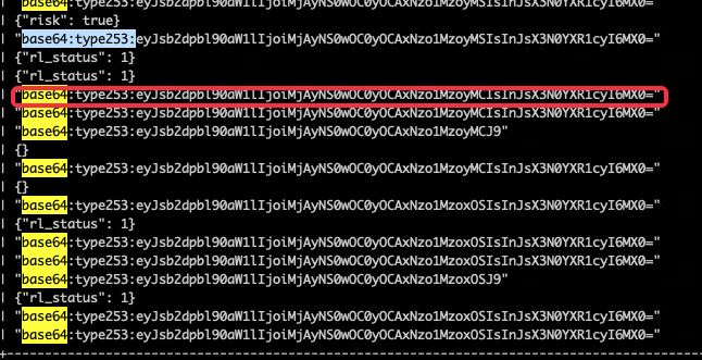

json格式 通过dm同步过来到tidb 字段的某些值变为了 base64:type253
【TiDB 使用环境】生产环境 /测试/ Poc
【TiDB 版本】7.5.6 dm版本 2.0
tidb的数据 需要解码才能看到(在mysql是没有问题的正常显示json格式),会是什么情况导致

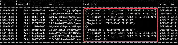

mysql数据(部分)

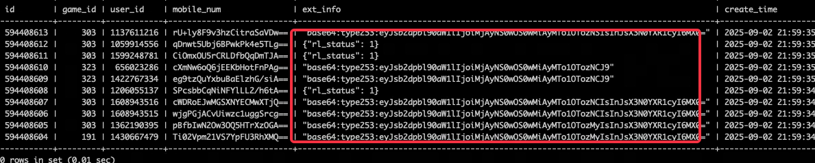

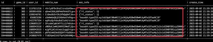

通过dm同步到tidb数据 部分转为base64 部分没有转(tidb)

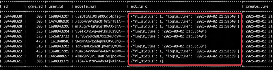

我用这个案例写 tidb 8.5.3,看内容是不变的。
(root@127.0.0.1) [test]>select * from user_bind;
| id        | game_id | user_id    | mobile_num                | ext_info                                              | create_time         | update_time         | db_updated |
| 594408321 |       1 | 1608939379 | 7l8t+HYNPwdsy5j4KiknAw==  | {"rl_status": 1}                                      | 2025-09-02 21:58:39 | 2025-09-02 21:58:39 | NULL       |
| 594408322 |       1 | 1544000657 | +tmx9y/JPTtu4ByLBjpo7w==  | {"login_time": "2025-09-02 21:58:39", "rl_status": 1} | 2025-09-02 21:58:39 | 2025-09-02 21:58:39 | NULL       |
| 594408323 |     425 |          1 | nGmrS4PVWfvFe+UNrFMBNw==  | {"login_time": "2025-09-02 21:58:39", "rl_status": 1} | 2025-09-02 21:58:39 | 2025-09-02 21:58:39 | NULL       |
| 594408324 |     425 | 1619498043 | 1gn7mwk7cn8zplMneIlQWo==  | {"login_time": "2025-09-02 21:58:39", "rl_status": 1} | 2025-09-02 21:58:39 | 2025-09-02 21:58:39 | NULL       |
| 594408325 |     475 | 1619498047 | MgMphAAG/ZdZepmcCKUv8hQ== | {"login_time": "2025-09-02 21:58:39"}                 | 2025-09-02 21:58:39 | 2025-09-02 21:58:39 | NULL       |
| 594408326 |     475 | 1619498046 | IrS9Yb6XbGUVexZMzqV4wA==  | {}                                                    | 2025-09-02 21:58:40 | 2025-09-02 21:58:40 | NULL       |
| 594408327 |     323 | 1608943205 | V5+JtHvkCqh+q4IDmtCz9QA== | {"login_time": "2025-09-02 21:58:40"}                 | 2025-09-02 21:58:40 | 2025-09-02 21:58:40 | NULL       |
| 594408328 |     323 | 1608943206 | mIKL9g4HgPuta6TMAXtxhAM== | {"login_time": "2025-09-02 21:58:40", "rl_status": 1} | 2025-09-02 21:58:40 | 2025-09-02 21:58:40 | NULL       |
| 594408329 |     303 | 1474386930 | tD9wy9VhUoC0fMn5rTBLA==   | {"login_time": "2025-09-02 21:58:40", "rl_status": 1} | 2025-09-02 21:58:40 | 2025-09-02 21:58:40 | NULL       |
| 594408330 |     303 | 1608943207 | u8zUTaAlUXfpKQGtq4pfSsg== | {"login_time": "2025-09-02 21:58:40", "rl_status": 1} | 2025-09-02 21:58:40 | 2025-09-02 21:58:40 | NULL       |
10 rows in set (0.00 sec)
