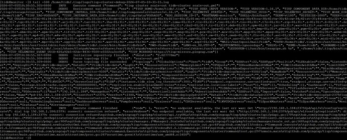

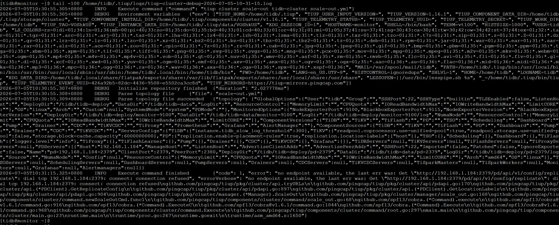

Error: no endpoint available, the last err was: Get “http://192.168.1.184:2379/pd/api/v1/config/replicate”: dial tcp 192.168.1.184:2379: connect: connection refused
Verbose debug logs has been written to /home/tidb/.tiup/logs/tiup-cluster-debug-2026-07-05-10-31-15.log.
请问这是什么问题引起的呢?防火墙都已经关闭,等效性已经配置过.
