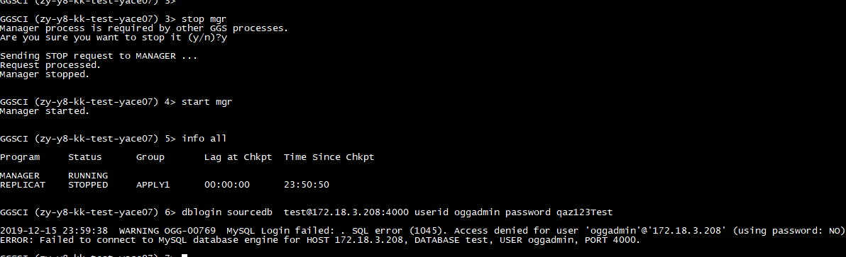

  • 【问题描述】:使用ogg 19无法登录 tidb 3.6
GGSCI (zy-y8-kk-test-yace07) 16> dblogin sourcedb test@172.18.3.208:4000 userid oggadmin password xxx 2019-12-15 20:36:36 WARNING OGG-00769 MySQL Login failed: . SQL error (1045). Access denied for user ‘oggadmin’@‘172.18.3.208’ (using password: NO). ERROR: Failed to connect to MySQL database engine for HOST 172.18.3.208, DATABASE test, USER oggadmin, PORT 4000.

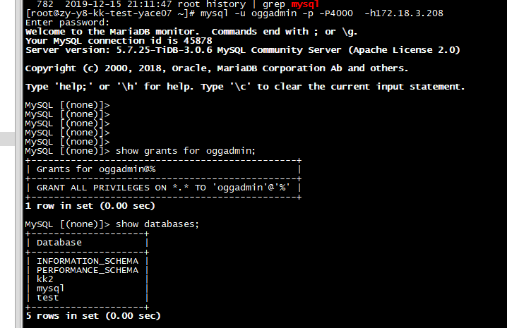

ogg账号权限没有任何问题 [root@zy-y8-kk-test-yace07 ~]# mysql -u oggadmin -p -P4000 -h172.18.3.208 Enter password: Welcome to the MariaDB monitor. Commands end with ; or \g. Your MySQL connection id is 45878 Server version: 5.7.25-TiDB-3.0.6 MySQL Community Server (Apache License 2.0)
Copyright © 2000, 2018, Oracle, MariaDB Corporation Ab and others.
Type ‘help;’ or ‘\h’ for help. Type ‘\c’ to clear the current input statement.
MySQL [(none)]>
确认一下该用户是否有 test 库的权限。另外需要在源端 mgr 增加允许访问目标端 ip 的规则 edit params mgr 增加以下内容: ACCESSRULE, PROG *, IPADDR *, ALLOW
源端是 mysql, 目标端是 tidb。我是在目标端上登录tidb 不行啊。难道我理解有问题。我先看看你的建议,谢谢!
依然不行啊
