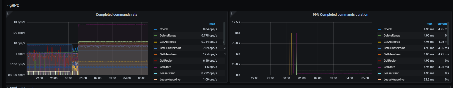

提问者为同事,我补充一下目前观察到的时间线
1) 2023/01/14 00:09:54
pd follower 61 和 63 报警报日志,连续十多次,每秒一次
[2023/01/14 00:09:54.890 +08:00] [WARN] [manager.go:102] ["failed to reload persist options"]
[2023/01/14 00:09:55.890 +08:00] [WARN] [manager.go:102] ["failed to reload persist options"]
[2023/01/14 00:09:56.890 +08:00] [WARN] [manager.go:102] ["failed to reload persist options"]
[2023/01/14 00:09:57.890 +08:00] [WARN] [manager.go:102] ["failed to reload persist options"]
[2023/01/14 00:09:58.890 +08:00] [WARN] [manager.go:102] ["failed to reload persist options"]
[2023/01/14 00:09:59.890 +08:00] [WARN] [manager.go:102] ["failed to reload persist options"]
[2023/01/14 00:10:00.890 +08:00] [WARN] [manager.go:102] ["failed to reload persist options"]

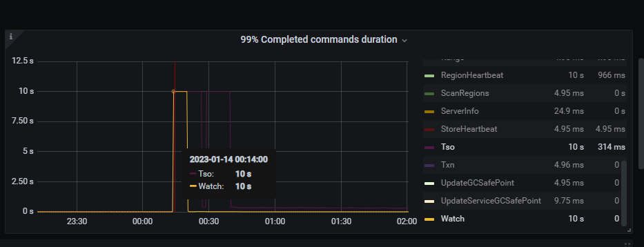

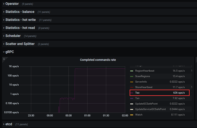

2)2023/01/14 00:14:00
pd leader监控 , grpc请求中 wait 和 tso 超10秒,同时tso开始量急剧变为500qps(之前都是0)
部分日志如下:

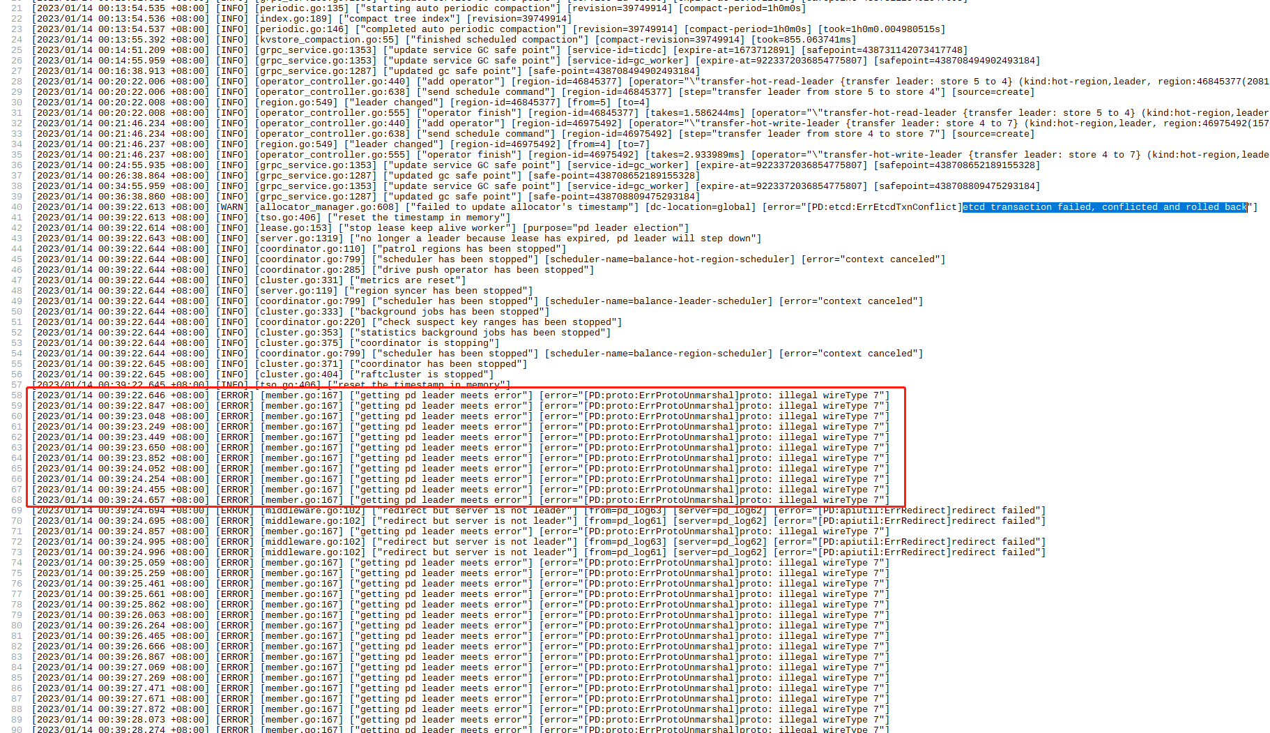

[2023/01/14 00:39:22.613 +08:00] [WARN] [allocator_manager.go:608] ["failed to update allocator's timestamp"] [dc-location=global] [error="[PD:etcd:ErrEtcdTxnConflict]etcd
transaction failed, conflicted and rolled back"]
[2023/01/14 00:39:22.613 +08:00] [INFO] [tso.go:406] ["reset the timestamp in memory"]
[2023/01/14 00:39:22.614 +08:00] [INFO] [lease.go:153] ["stop lease keep alive worker"] [purpose="pd leader election"]
[2023/01/14 00:39:22.643 +08:00] [INFO] [server.go:1319] ["no longer a leader because lease has expired, pd leader will step down"]
[2023/01/14 00:39:22.644 +08:00] [INFO] [coordinator.go:110] ["patrol regions has been stopped"]
[2023/01/14 00:39:22.644 +08:00] [INFO] [coordinator.go:799] ["scheduler has been stopped"] [scheduler-name=balance-hot-region-scheduler] [error="context canceled"]
[2023/01/14 00:39:22.644 +08:00] [INFO] [coordinator.go:285] ["drive push operator has been stopped"]
[2023/01/14 00:39:22.644 +08:00] [INFO] [cluster.go:331] ["metrics are reset"]
[2023/01/14 00:39:22.644 +08:00] [INFO] [server.go:119] ["region syncer has been stopped"]
[2023/01/14 00:39:22.644 +08:00] [INFO] [coordinator.go:799] ["scheduler has been stopped"] [scheduler-name=balance-leader-scheduler] [error="context canceled"]
[2023/01/14 00:39:22.644 +08:00] [INFO] [cluster.go:333] ["background jobs has been stopped"]
[2023/01/14 00:39:22.644 +08:00] [INFO] [coordinator.go:220] ["check suspect key ranges has been stopped"]
[2023/01/14 00:39:22.644 +08:00] [INFO] [cluster.go:353] ["statistics background jobs has been stopped"]
[2023/01/14 00:39:22.644 +08:00] [INFO] [cluster.go:375] ["coordinator is stopping"]
[2023/01/14 00:39:22.644 +08:00] [INFO] [coordinator.go:799] ["scheduler has been stopped"] [scheduler-name=balance-region-scheduler] [error="context canceled"]
[2023/01/14 00:39:22.645 +08:00] [INFO] [cluster.go:371] ["coordinator has been stopped"]
[2023/01/14 00:39:22.645 +08:00] [INFO] [cluster.go:404] ["raftcluster is stopped"]
[2023/01/14 00:39:22.645 +08:00] [INFO] [tso.go:406] ["reset the timestamp in memory"]
[2023/01/14 00:39:22.646 +08:00] [ERROR] [member.go:167] ["getting pd leader meets error"] [error="[PD:proto:ErrProtoUnmarshal]proto: illegal wireType 7"]
[2023/01/14 00:39:22.847 +08:00] [ERROR] [member.go:167] ["getting pd leader meets error"] [error="[PD:proto:ErrProtoUnmarshal]proto: illegal wireType 7"]
[2023/01/14 00:39:23.048 +08:00] [ERROR] [member.go:167] ["getting pd leader meets error"] [error="[PD:proto:ErrProtoUnmarshal]proto: illegal wireType 7"]
[2023/01/14 00:39:23.249 +08:00] [ERROR] [member.go:167] ["getting pd leader meets error"] [error="[PD:proto:ErrProtoUnmarshal]proto: illegal wireType 7"]
[2023/01/14 00:39:23.449 +08:00] [ERROR] [member.go:167] ["getting pd leader meets error"] [error="[PD:proto:ErrProtoUnmarshal]proto: illegal wireType 7"]

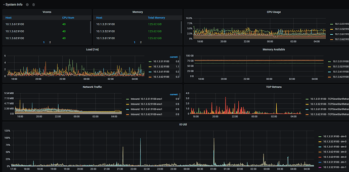

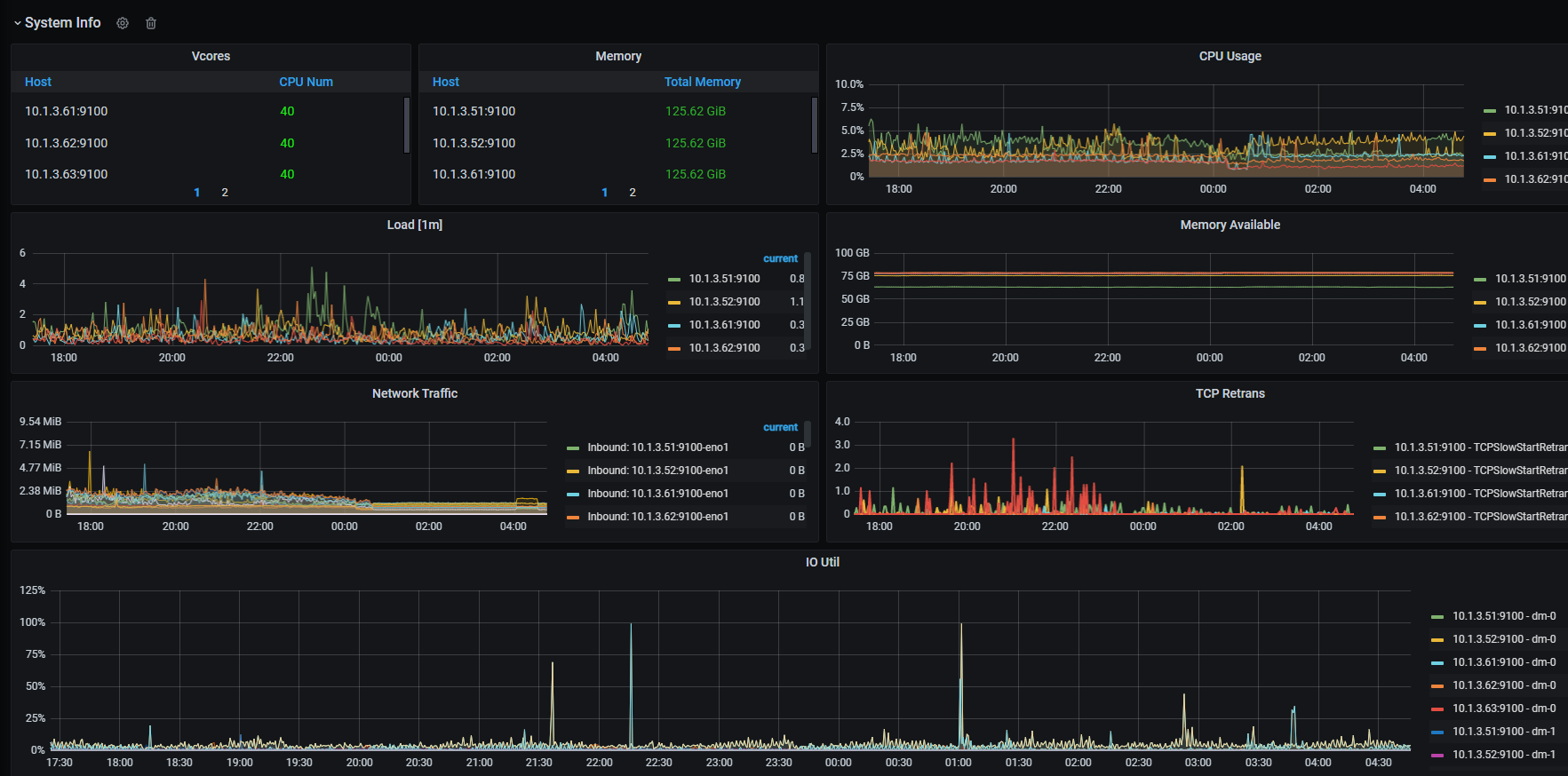

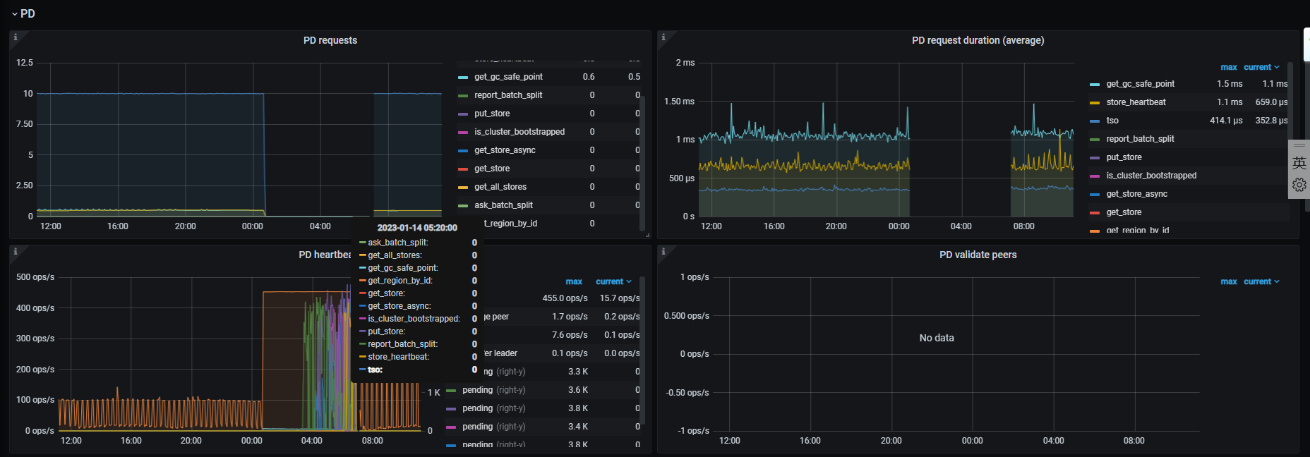

从提交的日志看来是 PD 的集群完全断连了,基本上就可以确认为 分布式无效了…
然后排查的话,应该有几个方向:

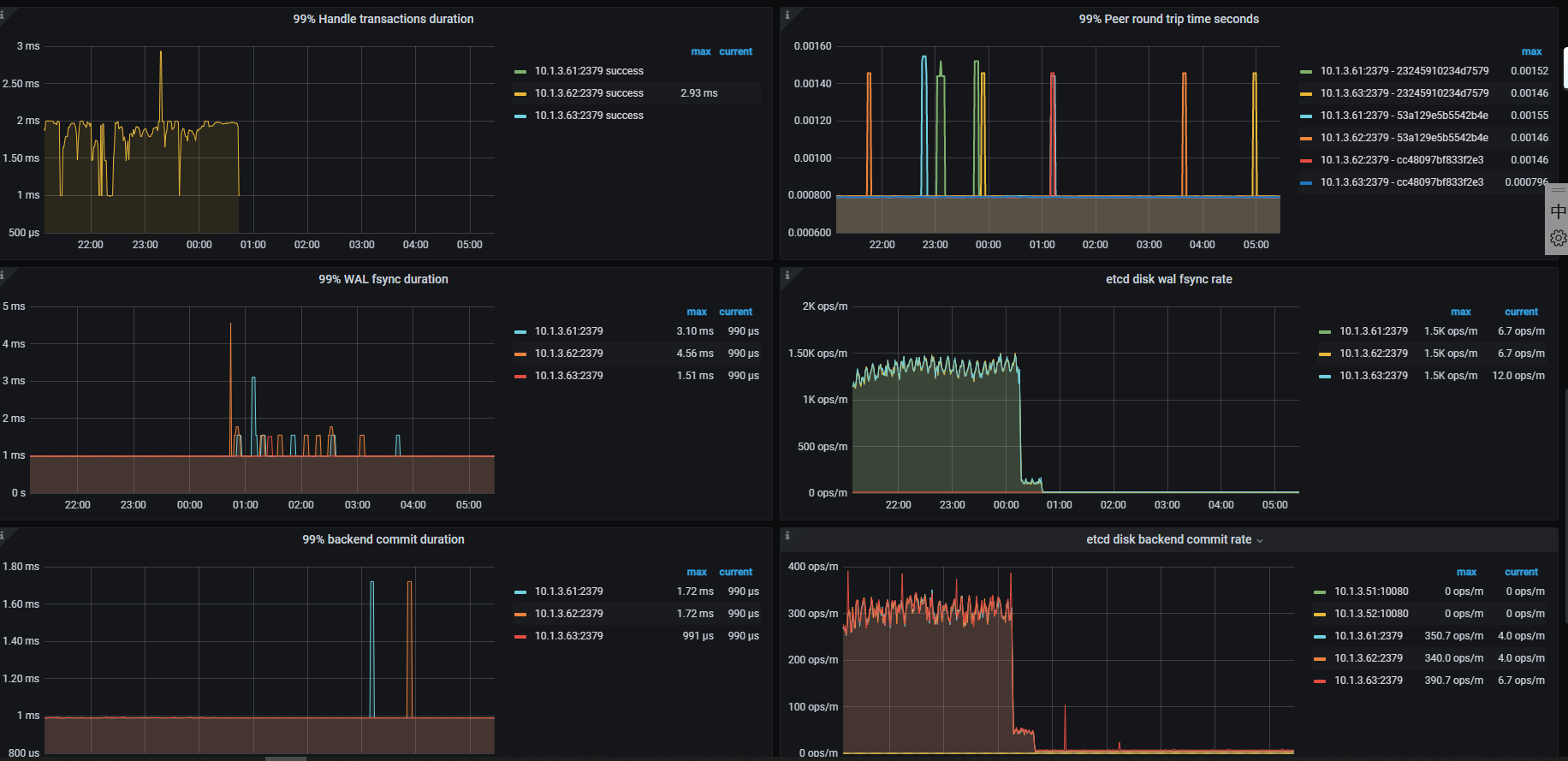

资源的IO 瓶颈,比如 cpu,内存,磁盘 (图中已经描述了cpu 和内存无瓶颈,可以查下磁盘的 IO)
网络瓶颈 (群集配置已经有描述,但是集群节点之间给的网络带宽是多少?)
节点之间网络的延迟 (通过 ganafa 观测 PD 节点的 gRPC 相关的网络信息)
我会优先考虑网络断连了…
参考提供的日志,从 39分开始起 就无 leader了…
[2023/01/14 00:39:24.694 +08:00] [ERROR] [middleware.go:102]
["redirect but server is not leader"]
[from=pd_log63] [server=pd_log62]
[error="[PD:apiutil:ErrRedirect]redirect failed"]
[2023/01/14 00:39:24.695 +08:00] [ERROR] [middleware.go:102]
[from=pd_log61] [server=pd_log62]
以上可以清楚的看到 所有的 PD 完全断链了…

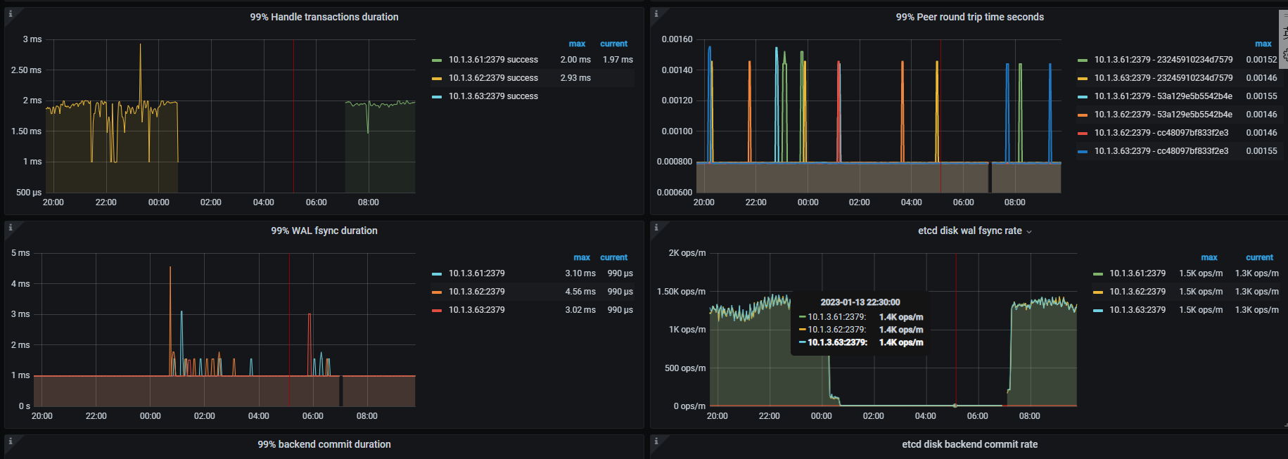

另外请考虑 ETCD 的默认配置:
etcd 默认超时时间是 7 秒(5 秒磁盘 IO 延时 +2*1 秒竞选超时
时间),如果一个请求超时未返回结果,则可能会出现你熟悉的 etcdserver: request timed out 错误。
查看tso慢查询原因 表妹文章,也没有说的Tso慢请求,有的只是无法连接pd,导致请求数陡降为0。
另外确认这个时期,网络确实没有问题,只是0:15的时候Tcp连接数降了(ticdc先行挂掉了?)
但是从tidb pd 的请求上看,一直到0:39,都是有在处理tso请求的。
