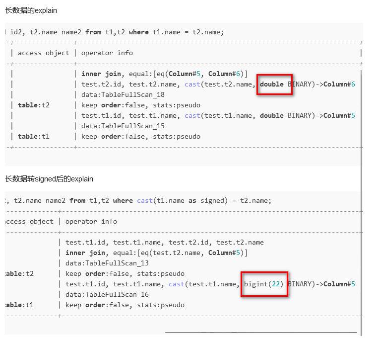

短数据的explain
mysql> explain select t1.id id1, t1.name name1, t2.id id2, t2.name name2 from t1,t2 where t1.name = t2.name;
| id                           | estRows  | task      | access object | operator info                                                         |
| HashJoin_12                  | 12500.00 | root      |               | inner join, equal:[eq(Column#5, Column#6)]                            |
| ├─Projection_17(Build)       | 10000.00 | root      |               | test.t2.id, test.t2.name, cast(test.t2.name, double BINARY)->Column#6 |
| │ └─TableReader_19           | 10000.00 | root      |               | data:TableFullScan_18                                                 |
| │   └─TableFullScan_18       | 10000.00 | cop[tikv] | table:t2      | keep order:false, stats:pseudo                                        |
| └─Projection_14(Probe)       | 10000.00 | root      |               | test.t1.id, test.t1.name, cast(test.t1.name, double BINARY)->Column#5 |
|   └─TableReader_16           | 10000.00 | root      |               | data:TableFullScan_15                                                 |
|     └─TableFullScan_15       | 10000.00 | cop[tikv] | table:t1      | keep order:false, stats:pseudo                                        |
7 rows in set (0.00 sec)
长数据的explain
7 rows in set (0.01 sec)
长数据转signed后的explain
mysql> explain select t1.id id1, t1.name name1, t2.id id2, t2.name name2 from t1,t2 where cast(t1.name as signed) = t2.name;
| Projection_10                 | 3.75    | root      |               | test.t1.id, test.t1.name, test.t2.id, test.t2.name                        |
| └─HashJoin_12                 | 3.75    | root      |               | inner join, equal:[eq(test.t2.name, Column#5)]                            |
|   ├─TableReader_14(Build)     | 3.00    | root      |               | data:TableFullScan_13                                                     |
|   │ └─TableFullScan_13        | 3.00    | cop[tikv] | table:t2      | keep order:false, stats:pseudo                                            |
|   └─Projection_15(Probe)      | 3.00    | root      |               | test.t1.id, test.t1.name, cast(test.t1.name, bigint(22) BINARY)->Column#5 |
|     └─TableReader_17          | 3.00    | root      |               | data:TableFullScan_16                                                     |
|       └─TableFullScan_16      | 3.00    | cop[tikv] | table:t1      | keep order:false, stats:pseudo                                            |
