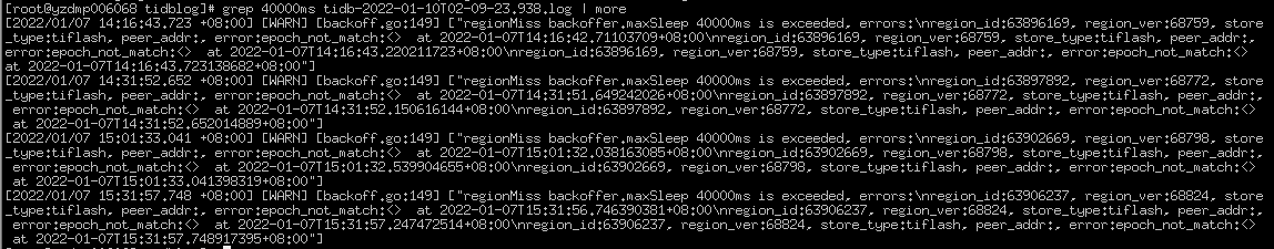

[2022/01/10 15:31:51.270 +08:00] [WARN] [backoff.go:149] [“regionMiss backoffer.maxSleep 40000ms is exceeded, errors:
region_id:64503303, region_ver:72300, store
_type:tiflash, peer_addr:, error:epoch_not_match:<> at 2022-01-10T15:31:50.263391753+08:00
region_id:64503303, region_ver:72300, store_type:tiflash, peer_addr:,
error:epoch_not_match:<> at 2022-01-10T15:31:50.764768481+08:00
region_id:64503303, region_ver:72300, store_type:tiflash, peer_addr:, error:epoch_not_match:<>
at 2022-01-10T15:31:51.270662518+08:00”]

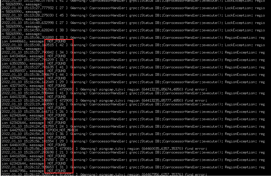

tiflash报错信息是什么,dumpling可能是去查询tiflash。
xxx.xx.17.188 | SUCCESS | rc=0 >>
2022.01.10 15:31:10.994648 [ 35 ] CoprocessorHandler: grpc::Status DB::CoprocessorHandler::execute(): RegionException: region 64503303, message: NOT_FOUND

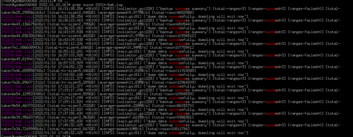

bak.log (96.9 KB)
