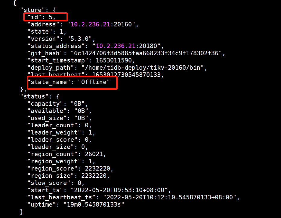

从日志看就是store id重复了,第9步删除store id成功了吗,看下现在的store有哪些
删除了
刚刚查询又有了,需要再删除一遍吗?

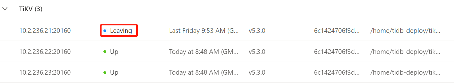

执行缩容,加了–force,故障节点已经消失。
监控面板显示Leaving,不影响扩容吧?

[2022/05/23 17:07:48.598 +08:00] [ERROR] [util.rs:460] [“request failed”] [err_code=KV:PD:gRPC] [err=“Grpc(RpcFailure(RpcStatus { code: 2-UNKNOWN, message: “duplicated store address: id:1151064 address:\“10.2.236.21:20160\” version:\“5.3.0\” status_address:\“10.2.236.21:20180\” git_hash:\“6c1424706f3d5885faa668233f34c9f178302f36\” start_timestamp:1653296863 deploy_path:\”/home/tidb-deploy/tikv-20160/bin\” , already registered by id:5 address:\“10.2.236.21:20160\” state:Offline version:\“5.3.0\” status_address:\“10.2.236.21:20180\” git_hash:\“6c1424706f3d5885faa668233f34c9f178302f36\” start_timestamp:1653011590 deploy_path:\"/home/tidb-deploy/tikv-20160/bin\" last_heartbeat:1653012730545870133 “, details: [] }))”]
[2022/05/23 17:07:48.598 +08:00] [FATAL] [server.rs:843] [“failed to start node: Grpc(RpcFailure(RpcStatus { code: 2-UNKNOWN, message: “duplicated store address: id:1151064 address:\“10.2.236.21:20160\” version:\“5.3.0\” status_address:\“10.2.236.21:20180\” git_hash:\“6c1424706f3d5885faa668233f34c9f178302f36\” start_timestamp:1653296863 deploy_path:\”/home/tidb-deploy/tikv-20160/bin\” , already registered by id:5 address:\“10.2.236.21:20160\” state:Offline version:\“5.3.0\” status_address:\“10.2.236.21:20180\” git_hash:\“6c1424706f3d5885faa668233f34c9f178302f36\” start_timestamp:1653011590 deploy_path:\"/home/tidb-deploy/tikv-20160/bin\" last_heartbeat:1653012730545870133 “, details: [] }))”]
执行 tiup cluster prune 了吗
