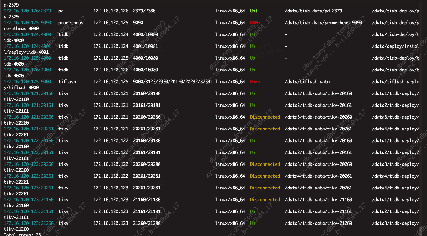

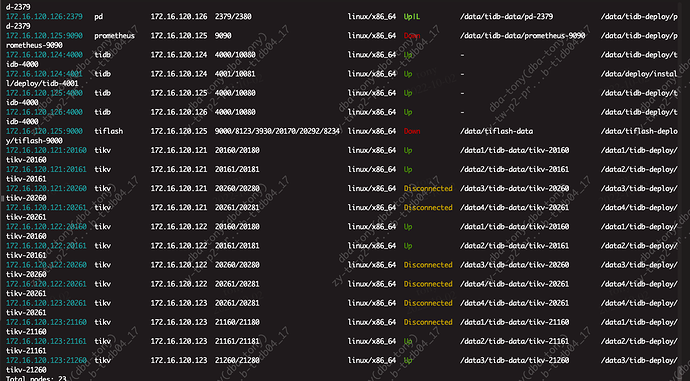

刚才有做了一遍,但是看到tidb起来了,但是原本正常的tikv有几个没有起来

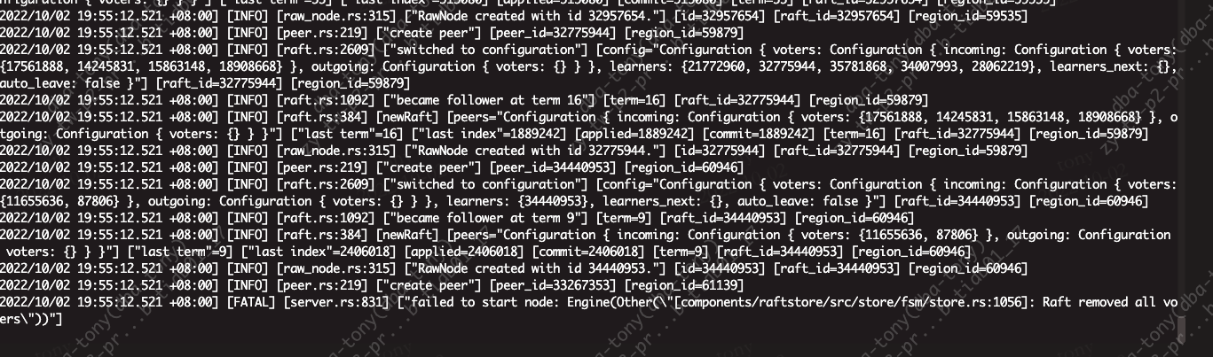

以前正常的tikv现在起不来,报这样的错误
image 也无法查询

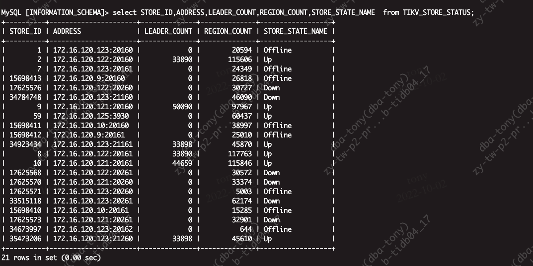

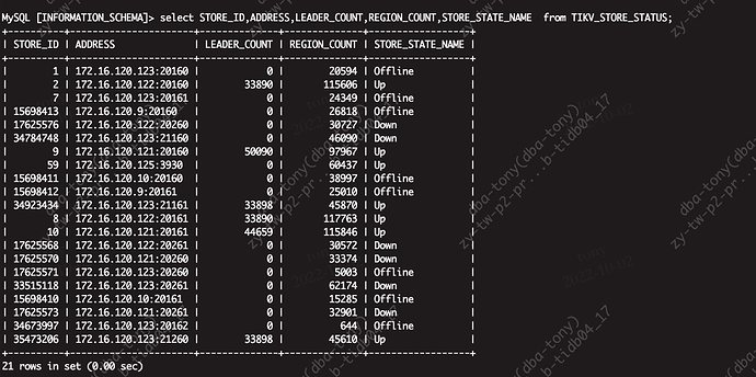

下面是我根据offline的机器,找到的region

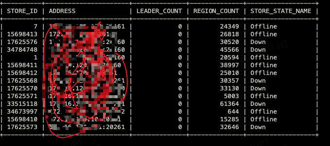

| STORE_ID | ADDRESS | LEADER_COUNT | REGION_COUNT | STORE_STATE_NAME |
| 15698410 | 172.16.120.10:20161 | 0 | 15285 | Offline |
| 34673997 | 172.16.120.123:20162 | 0 | 644 | Offline |
| 1 | 172.16.120.123:20160 | 0 | 20594 | Offline |
| 7 | 172.16.120.123:20161 | 0 | 24350 | Offline |
| 15698413 | 172.16.120.9:20160 | 0 | 26818 | Offline |
| 15698411 | 172.16.120.10:20160 | 0 | 39000 | Offline |
| 15698412 | 172.16.120.9:20161 | 0 | 25010 | Offline |
| 17625571 | 172.16.120.123:20260 | 0 | 5003 | Offline |
