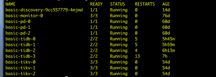

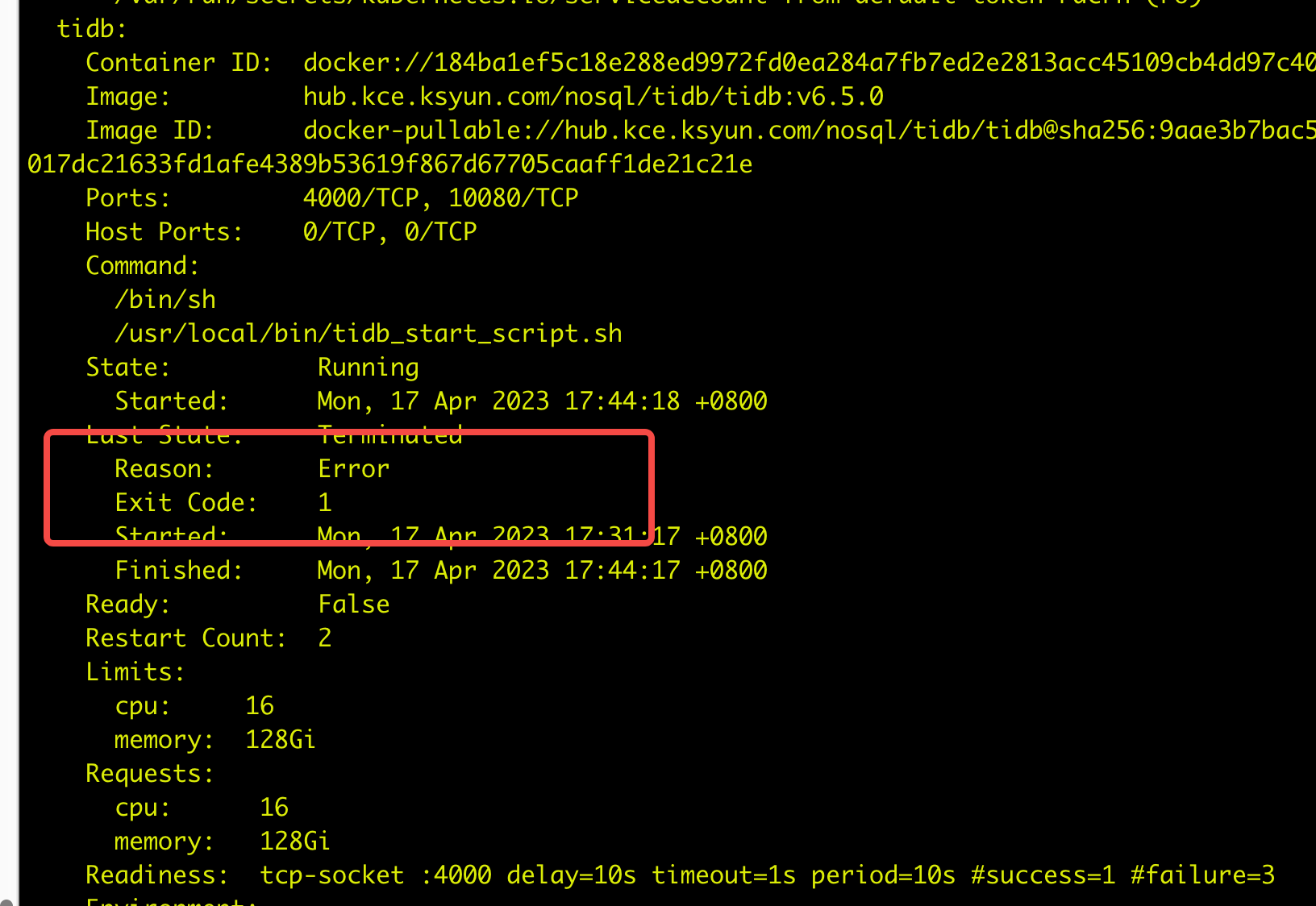

2、关闭pump服务所有的tidb节点的pod全部宕机,为什么会全部宕机

pump关闭时tidb节点pod状态
tidb节点pod启动日志:
[2023/04/17 18:25:13.422 +08:00] [INFO] [client.go:328] [“[pumps client] write binlog to available pumps all failed, will try unavailable pumps”]
[2023/04/17 18:25:13.422 +08:00] [WARN] [session.go:2218] [“run statement failed”] [conn=7929359001148457417] [schemaVersion=3496320] [error=“[global:3]critical error write binlog failed, the last error no available pump to write binlog”] [session=“{\n "currDBName": "mysql",\n "id": 7929359001148457417,\n "status": 2,\n "strictMode": true,\n "user": {\n "Username": "root",\n "Hostname": "100.64.32.201",\n "CurrentUser": false,\n "AuthUsername": "root",\n "AuthHostname": "%"\n }\n}”]
[2023/04/17 18:25:13.422 +08:00] [FATAL] [conn.go:1138] [“critical error, stop the server”] [conn=7929359001148457417] [error=“[global:3]critical error write binlog failed, the last error no available pump to write binlog”] [stack=“github.com/pingcap/tidb/server.(*clientConn).Run\n\t/home/jenkins/agent/workspace/build-common/go/src/github.com/pingcap/tidb/server/conn.go:1138\ngithub.com/pingcap/tidb/server.(*Server).onConn\n\t/home/jenkins/agent/workspace/build-common/go/src/github.com/pingcap/tidb/server/server.go:625”]

全部宕机是因为你关闭pump,但是tidb的binlog相关参数没有做调整,所以才会宕机,因为tidb会有个检测,把binlog参数关了就行了
tidb 配置下 ignore error
配置文件是否开启binlog?pump 是如何设置的
看上去是操作错误,要先关闭binlog,然后再重启pump
