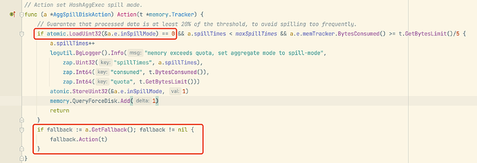

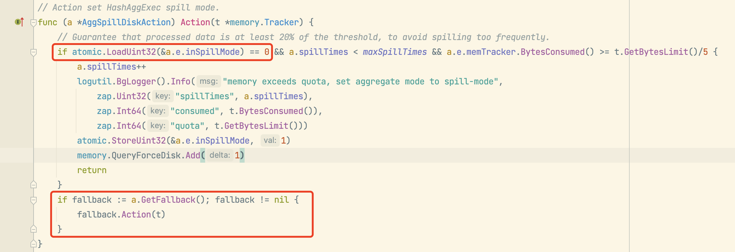

可以看到在做hashAgg时候最大溢出到磁盘的次数为:spillTimes=1,只有一次。在其落盘行为定义中需要超过10次落盘(maxSpillTimes)才会回退到oom-action=cancel(DefPanicPriority最低优先级),否则会优先进行落盘(DefSpillPriority)。相关代码:
https://github.com/pingcap/tidb/blob/7eff8ce629d00cf4ab1eeda82a1ecd5a4e394b02/executor/aggregate.go#L1945
// Action set HashAggExec spill mode.
func (a *AggSpillDiskAction) Action(t *memory.Tracker) {
// Guarantee that processed data is at least 20% of the threshold, to avoid spilling too frequently.
if atomic.LoadUint32(&a.e.inSpillMode) == 0 && a.spillTimes < maxSpillTimes && a.e.memTracker.BytesConsumed() >= t.GetBytesLimit()/5 {
a.spillTimes++
logutil.BgLogger().Info("memory exceeds quota, set aggregate mode to spill-mode",
zap.Uint32("spillTimes", a.spillTimes),
zap.Int64("consumed", t.BytesConsumed()),
zap.Int64("quota", t.GetBytesLimit()))
atomic.StoreUint32(&a.e.inSpillMode, 1)
memory.QueryForceDisk.Add(1)
return
if fallback := a.GetFallback(); fallback != nil {
fallback.Action(t)
既然只做一次落盘,为什么还是会被cancel掉呢(问题4)?
