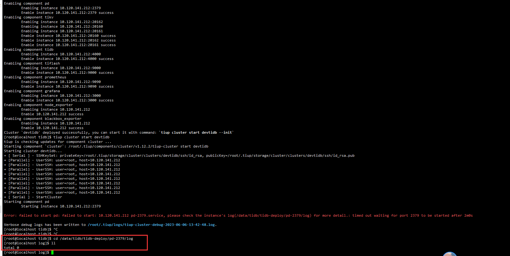

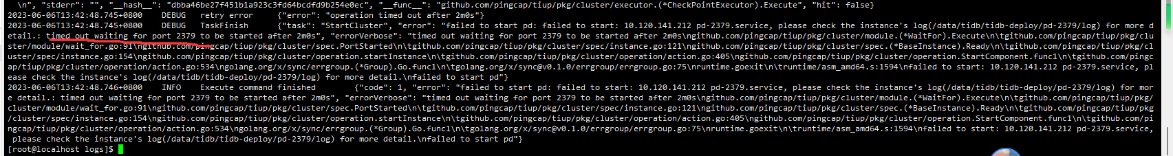

【遇到的问题:问题现象及影响】测试环境搭建单机模拟部署生产环境集群,创建集群成功,在启动集群时报错。failed to start pd: failed to start: 10.120.141.212 pd-2379.service, please check the instance’s log(/data/tidb/tidb-deploy/pd-2379/log) for more detail.: timed out waiting for port 2379 to be started after 2m0s
pd日志为空 部署日志下显示超时
