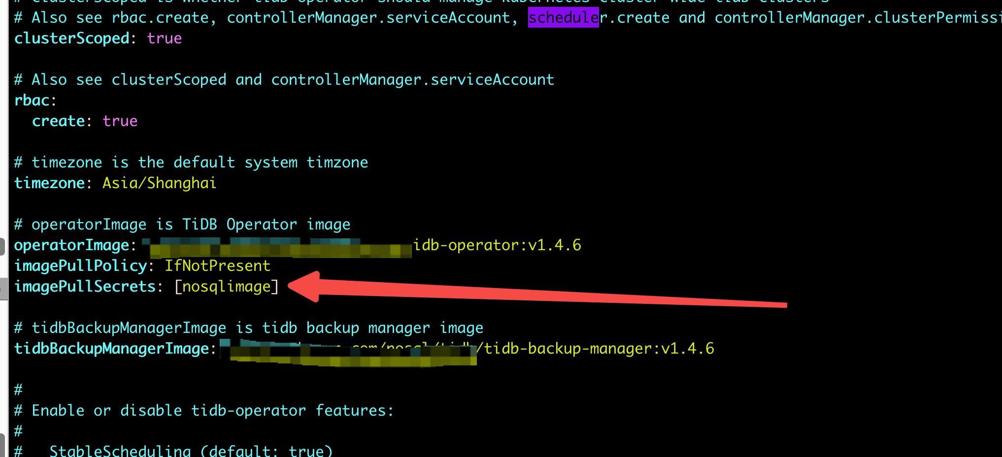

将1.3.3版本operator升级到1.4.6配置报错,
配置如下:
升级命令:
/root/helm/linux-amd64/helm upgrade tidb-operator ./tidb-operator --namespace=tidb-admin
报错内容如下:
Error: UPGRADE FAILED: error validating “”: error validating data: ValidationError(Deployment.spec.template.spec.imagePullSecrets[0]): invalid type for io.k8s.api.core.v1.LocalObjectReference: got “string”, expected “map”

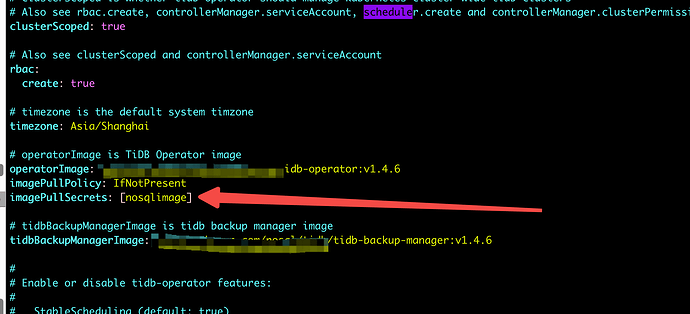

直接上示例吧
这行注释掉就行
在 v1.3.3 也会报错,之前是怎么部署成功的
➜  ~ helm install tidb-operator pingcap/tidb-operator --namespace tidb-admin --version v1.3.3 -f values.yaml
Error: INSTALLATION FAILED: unable to build kubernetes objects from release manifest: error validating "": error validating data: ValidationError(Deployment.spec.template.spec.imagePullSecrets[0]): invalid type for io.k8s.api.core.v1.LocalObjectReference: got "string", expected "map"
