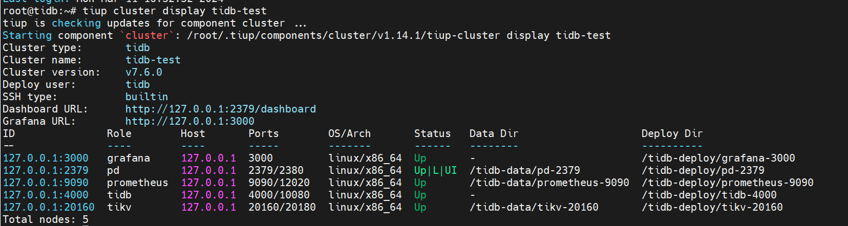

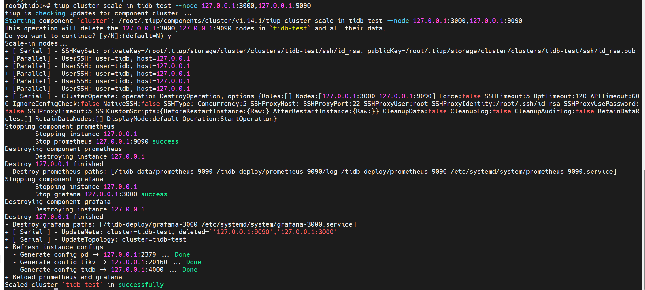

为啥要手动部署,监控没装直接scale-out下,监控可以缩容扩容的

扩容监控:
vi scale-out.yml
monitored:
node_exporter_port: 9100
blackbox_exporter_port: 9115
monitoring_servers:
- host: 127.0.0.1
grafana_servers:
- host: 127.0.0.1
扩容
root@tidb:~# tiup cluster scale-out tidb-test scale-out.yml -u root -p
tiup is checking updates for component cluster ...
Starting component `cluster`: /root/.tiup/components/cluster/v1.14.1/tiup-cluster scale-out tidb-test scale-out.yml -u root -p
You have one or more of ["global", "monitored", "server_configs"] fields configured in
the scale out topology, but they will be ignored during the scaling out process.
If you want to use configs different from the existing cluster, cancel now and
set them in the specification fileds for each host.
Do you want to continue? [y/N]: (default=N) y
Input SSH password:
+ Detect CPU Arch Name
- Detecting node 127.0.0.1 Arch info ... Done
+ Detect CPU OS Name
- Detecting node 127.0.0.1 OS info ... Done
Please confirm your topology:
Cluster type: tidb
Cluster name: tidb-test
Cluster version: v7.6.0
Role Host Ports OS/Arch Directories
prometheus 127.0.0.1 9090/12020 linux/x86_64 /tidb-deploy/prometheus-9090,/tidb-data/prometheus-9090
grafana 127.0.0.1 3000 linux/x86_64 /tidb-deploy/grafana-3000
Attention:
1. If the topology is not what you expected, check your yaml file.
2. Please confirm there is no port/directory conflicts in same host.
+ [ Serial ] - SSHKeySet: privateKey=/root/.tiup/storage/cluster/clusters/tidb-test/ssh/id_rsa, publicKey=/root/.tiup/storage/cluster/clusters/tidb-test/ssh/id_rsa.pub
+ [Parallel] - UserSSH: user=tidb, host=127.0.0.1
+ Download TiDB components
- Download prometheus:v7.6.0 (linux/amd64) ... Done
- Download grafana:v7.6.0 (linux/amd64) ... Done
+ Initialize target host environments
+ Deploy TiDB instance
- Deploy instance prometheus -> 127.0.0.1:9090 ... Done
- Deploy instance grafana -> 127.0.0.1:3000 ... Done
+ Copy certificate to remote host
+ Generate scale-out config
- Generate scale-out config prometheus -> 127.0.0.1:9090 ... Done
- Generate scale-out config grafana -> 127.0.0.1:3000 ... Done
+ Init monitor config
Enabling component prometheus
Enabling instance 127.0.0.1:9090
Enable instance 127.0.0.1:9090 success
Enabling component grafana
Enabling instance 127.0.0.1:3000
Enable instance 127.0.0.1:3000 success
Enabling component node_exporter
Enable 127.0.0.1 success
Enabling component blackbox_exporter
+ [ Serial ] - Save meta
+ [ Serial ] - Start new instances
Starting component prometheus
Starting instance 127.0.0.1:9090
Start instance 127.0.0.1:9090 success
Starting component grafana
Starting instance 127.0.0.1:3000
Start instance 127.0.0.1:3000 success
Starting component node_exporter
Start 127.0.0.1 success
Starting component blackbox_exporter
+ Refresh components conifgs
- Generate config pd -> 127.0.0.1:2379 ... Done
- Generate config tikv -> 127.0.0.1:20160 ... Done
- Generate config tidb -> 127.0.0.1:4000 ... Done
- Generate config prometheus -> 127.0.0.1:9090 ... Done
- Generate config grafana -> 127.0.0.1:3000 ... Done
+ Reload prometheus and grafana
+ [ Serial ] - UpdateTopology: cluster=tidb-test
Scaled cluster `tidb-test` out successfully
