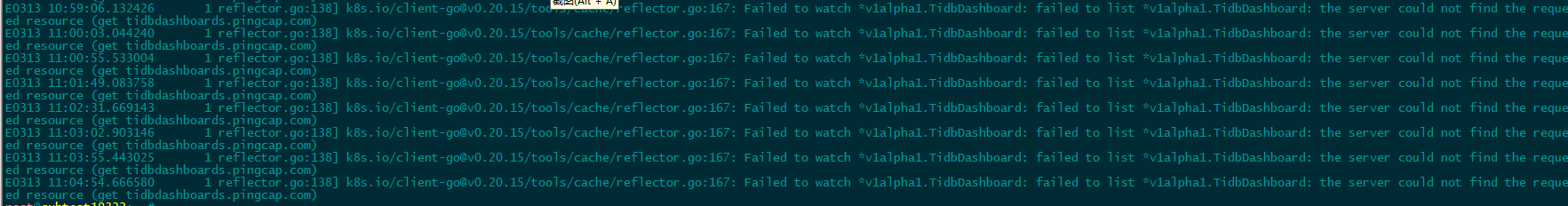

tidb-operator的pod日志:
E0313 06:17:24.355669 1 reflector.go:138] k8s.io/client-go@v0.20.15/tools/cache/reflector.go:167: Failed to watch *v1alpha1.TidbDashboard: failed to list *v1alpha1.TidbDashboard: the server could not find the requested resource (get tidbdashboards.pingcap.com)
E0313 06:18:09.206798 1 reflector.go:138] k8s.io/client-go@v0.20.15/tools/cache/reflector.go:167: Failed to watch *v1alpha1.TidbDashboard: failed to list *v1alpha1.TidbDashboard: the server could not find the requested resource (get tidbdashboards.pingcap.com)
E0313 06:19:03.449916 1 reflector.go:138] k8s.io/client-go@v0.20.15/tools/cache/reflector.go:167: Failed to watch *v1alpha1.TidbDashboard: failed to list *v1alpha1.TidbDashboard: the server could not find the requested resource (get tidbdashboards.pingcap.com)
E0313 06:19:52.099712 1 reflector.go:138] k8s.io/client-go@v0.20.15/tools/cache/reflector.go:167: Failed to watch *v1alpha1.TidbDashboard: failed to list *v1alpha1.TidbDashboard: the server could not find the requested resource (get tidbdashboards.pingcap.com)

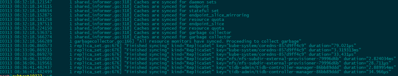

log 一下operator的日志,controlmanager那个,然后过滤这个ns。贴一段看看。
tidb-controller-manager和kube-controller-manager-node日志都没有匹配的日志。
多次删除重新apply yaml,kube-controller-manager-node日志都没有变化的
