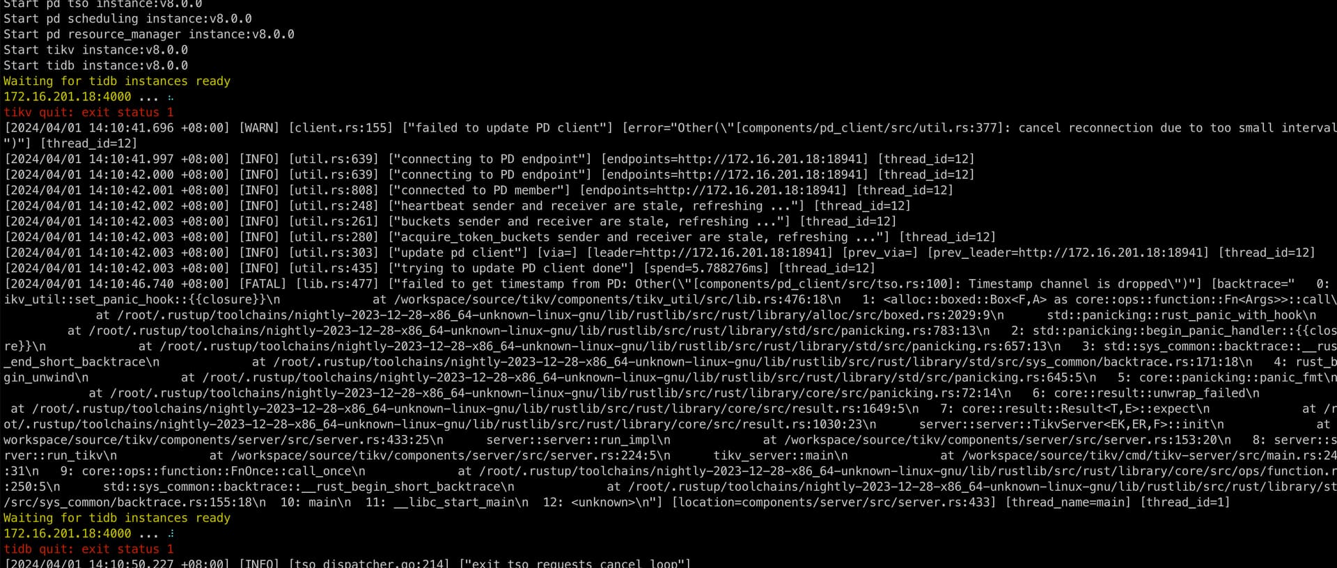

停止后,再次启动,报错
[tidb@shawnyan ~ 14:54:43]$ tiup playground v8.0.0 --tag v8 --pd.mode ms --pd.api 1 --pd.tso 1 --pd.scheduling 1 --without-monitor
Start pd api instance:v8.0.0
Start pd tso instance:v8.0.0
Start pd scheduling instance:v8.0.0
Start pd resource_manager instance:v8.0.0
Start tikv instance:v8.0.0
Start tidb instance:v8.0.0
Waiting for tidb instances ready
127.0.0.1:4000 ... ⠹
tikv quit: exit status 1
[2024/03/28 14:54:53.575 +08:00] [WARN] [client.rs:155] ["failed to update PD client"] [error="Other(\"[components/pd_client/src/util.rs:377]: cancel reconnection due to too small interval\")"] [thread_id=12]
[2024/03/28 14:54:53.876 +08:00] [INFO] [util.rs:639] ["connecting to PD endpoint"] [endpoints=http://127.0.0.1:2379] [thread_id=12]
[2024/03/28 14:54:53.877 +08:00] [INFO] [util.rs:639] ["connecting to PD endpoint"] [endpoints=http://127.0.0.1:2379] [thread_id=12]
[2024/03/28 14:54:53.877 +08:00] [INFO] [util.rs:808] ["connected to PD member"] [endpoints=http://127.0.0.1:2379] [thread_id=12]
[2024/03/28 14:54:53.877 +08:00] [INFO] [util.rs:248] ["heartbeat sender and receiver are stale, refreshing ..."] [thread_id=12]
[2024/03/28 14:54:53.877 +08:00] [INFO] [util.rs:261] ["buckets sender and receiver are stale, refreshing ..."] [thread_id=12]
[2024/03/28 14:54:53.877 +08:00] [INFO] [util.rs:280] ["acquire_token_buckets sender and receiver are stale, refreshing ..."] [thread_id=12]
[2024/03/28 14:54:53.877 +08:00] [INFO] [util.rs:303] ["update pd client"] [via=] [leader=http://127.0.0.1:2379] [prev_via=] [prev_leader=http://127.0.0.1:2379] [thread_id=12]
[2024/03/28 14:54:53.877 +08:00] [INFO] [util.rs:435] ["trying to update PD client done"] [spend=1.787786ms] [thread_id=12]
[2024/03/28 14:54:59.338 +08:00] [FATAL] [lib.rs:477] ["failed to get timestamp from PD: Other(\"[components/pd_client/src/tso.rs:100]: Timestamp channel is dropped\")"] [backtrace=" 0: tikv_util::set_panic_hook::{{closure}}\n at /workspace/source/tikv/components/tikv_util/src/lib.rs:476:18\n 1: <alloc::boxed::Box<F,A> as core::ops::function::Fn<Args>>::call\n at /root/.rustup/toolchains/nightly-2023-12-28-x86_64-unknown-linux-gnu/lib/rustlib/src/rust/library/alloc/src/boxed.rs:2029:9\n std::panicking::rust_panic_with_hook\n at /root/.rustup/toolchains/nightly-2023-12-28-x86_64-unknown-linux-gnu/lib/rustlib/src/rust/library/std/src/panicking.rs:783:13\n 2: std::panicking::begin_panic_handler::{{closure}}\n at /root/.rustup/toolchains/nightly-2023-12-28-x86_64-unknown-linux-gnu/lib/rustlib/src/rust/library/std/src/panicking.rs:657:13\n 3: std::sys_common::backtrace::__rust_end_short_backtrace\n at /root/.rustup/toolchains/nightly-2023-12-28-x86_64-unknown-linux-gnu/lib/rustlib/src/rust/library/std/src/sys_common/backtrace.rs:171:18\n 4: rust_begin_unwind\n at /root/.rustup/toolchains/nightly-2023-12-28-x86_64-unknown-linux-gnu/lib/rustlib/src/rust/library/std/src/panicking.rs:645:5\n 5: core::panicking::panic_fmt\n at /root/.rustup/toolchains/nightly-2023-12-28-x86_64-unknown-linux-gnu/lib/rustlib/src/rust/library/core/src/panicking.rs:72:14\n 6: core::result::unwrap_failed\n at /root/.rustup/toolchains/nightly-2023-12-28-x86_64-unknown-linux-gnu/lib/rustlib/src/rust/library/core/src/result.rs:1649:5\n 7: core::result::Result<T,E>::expect\n at /root/.rustup/toolchains/nightly-2023-12-28-x86_64-unknown-linux-gnu/lib/rustlib/src/rust/library/core/src/result.rs:1030:23\n server::server::TikvServer<EK,ER,F>::init\n at /workspace/source/tikv/components/server/src/server.rs:433:25\n server::server::run_impl\n at /workspace/source/tikv/components/server/src/server.rs:153:20\n 8: server::server::run_tikv\n at /workspace/source/tikv/components/server/src/server.rs:224:5\n tikv_server::main\n at /workspace/source/tikv/cmd/tikv-server/src/main.rs:249:31\n 9: core::ops::function::FnOnce::call_once\n at /root/.rustup/toolchains/nightly-2023-12-28-x86_64-unknown-linux-gnu/lib/rustlib/src/rust/library/core/src/ops/function.rs:250:5\n std::sys_common::backtrace::__rust_begin_short_backtrace\n at /root/.rustup/toolchains/nightly-2023-12-28-x86_64-unknown-linux-gnu/lib/rustlib/src/rust/library/std/src/sys_common/backtrace.rs:155:18\n 10: main\n 11: __libc_start_main\n 12: <unknown>\n"] [location=components/server/src/server.rs:433] [thread_name=main] [thread_id=1]
127.0.0.1:4000 ... ⠋
tidb quit: exit status 1
