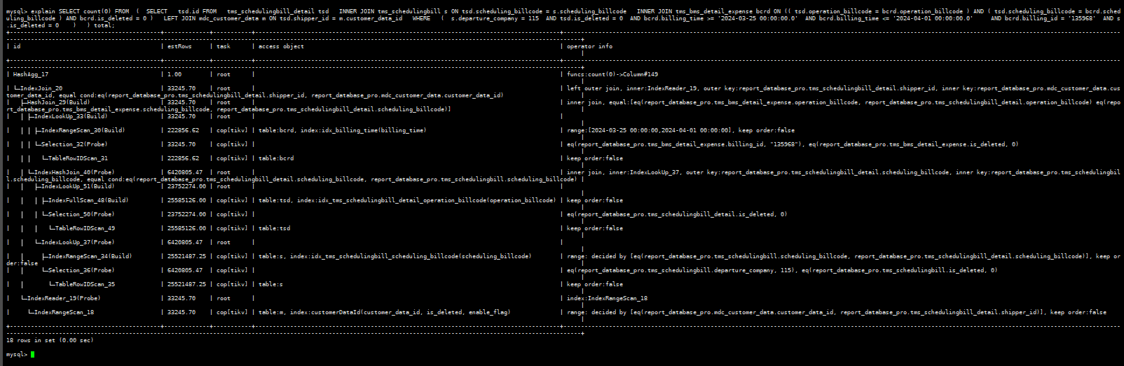

绑定执行,没有起效。
除了上面新建的 binding, 有没有其他相关 binding 创建呢。 根据目前的信息,怀疑之前本来就已经有其它 binding 了,加了括号的影响是让它匹配不上 binding 导致的

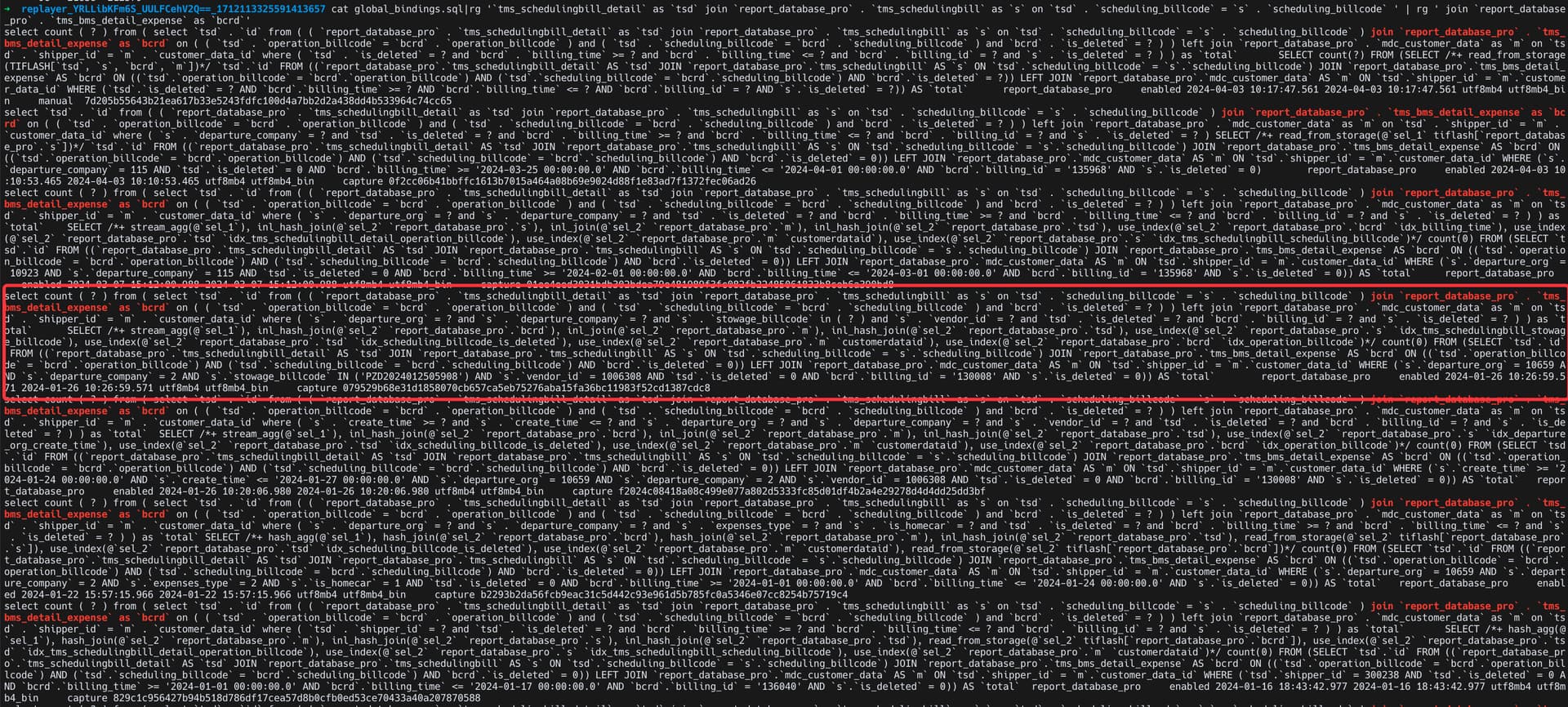

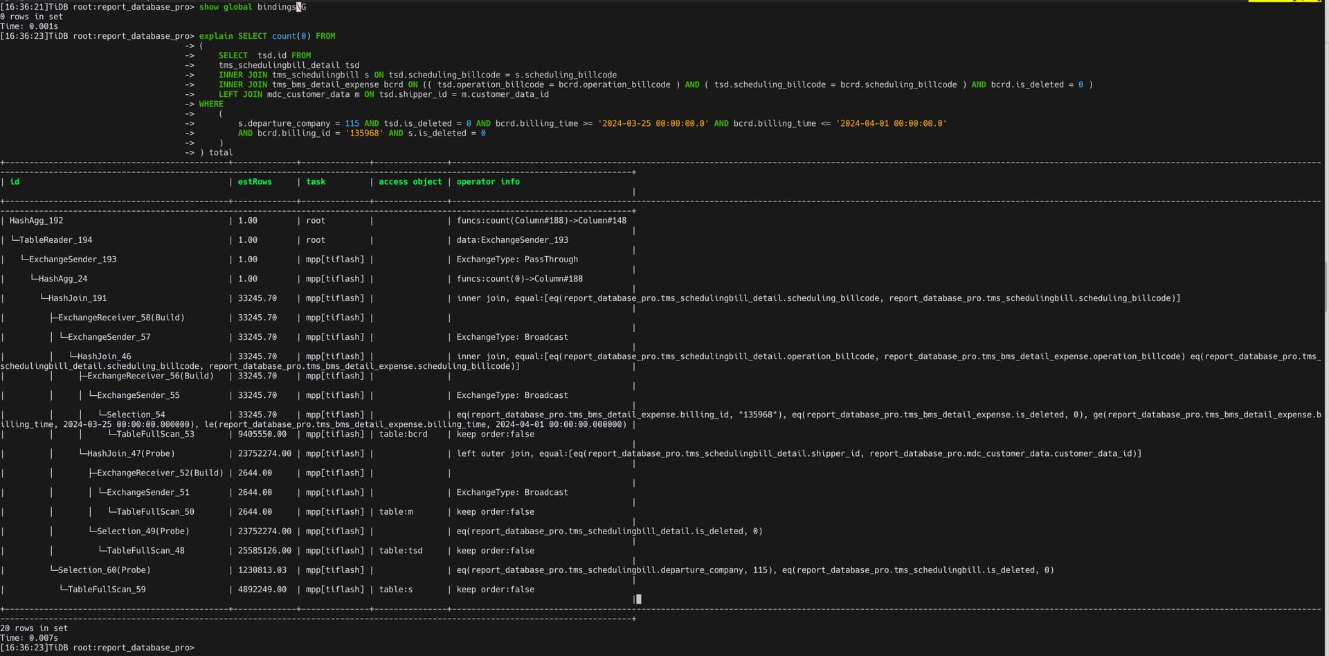

当 Global binding 为空的情况下,可以看到使用括号的时候还是走 tiflash
通过导处的 global binding,可以看出这里有一些自动捕获的 global binding 是没有走 tiflash 的

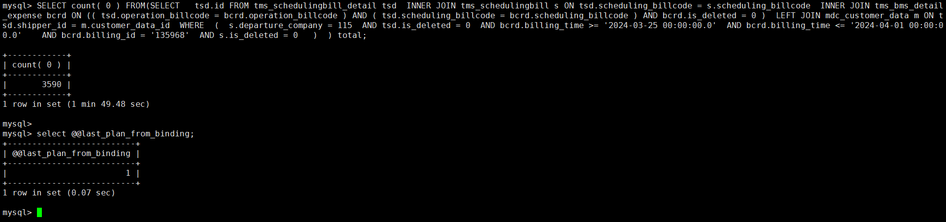

你可以使用
select @@last_plan_from_binding
来看看你的执行计划是否来自于 binding

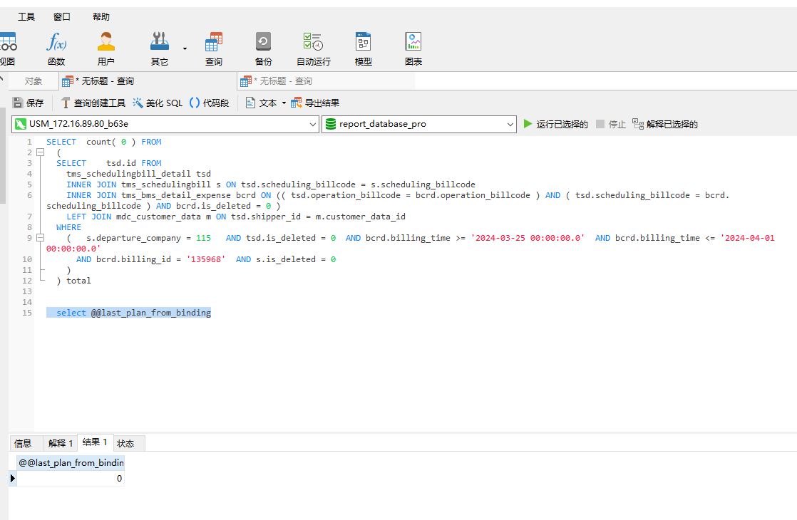

请问 navicat 上的查询也是走 tikv 么。麻烦把这条 global binding 删掉试试呢。
select count ( ? ) from ( select `tsd` . `id` from ( ( `report_database_pro` . `tms_schedulingbill_detail` as `tsd` join `report_database_pro` . `tms_schedulingbill` as `s` on `tsd` . `scheduling_billcode` = `s` . `scheduling_billcode` ) join `report_database_pro` . `tms_bms_detail_expense` as `bcrd` on ( ( `tsd` . `operation_billcode` = `bcrd` . `operation_billcode` ) and ( `tsd` . `scheduling_billcode` = `bcrd` . `scheduling_billcode` ) and `bcrd` . `is_deleted` = ? ) ) left join `report_database_pro` . `mdc_customer_data` as `m` on `tsd` . `shipper_id` = `m` . `customer_data_id` where ( `s` . `departure_company` = ? and `tsd` . `is_deleted` = ? and `bcrd` . `billing_time` >= ? and `bcrd` . `billing_time` <= ? and `bcrd` . `billing_id` = ? and `s` . `is_deleted` = ? ) ) as `total` SELECT /*+ hash_agg(@`sel_1`), inl_hash_join(@`sel_2` `report_database_pro`.`s`), inl_join(@`sel_2` `report_database_pro`.`m`), inl_hash_join(@`sel_2` `report_database_pro`.`tsd`), use_index(@`sel_2` `report_database_pro`.`bcrd` `idx_billing_time`), use_index(@`sel_2` `report_database_pro`.`tsd` `idx_tms_schedulingbill_detail_operation_billcode`), use_index(@`sel_2` `report_database_pro`.`m` `customerdataid`), use_index(@`sel_2` `report_database_pro`.`s` `idx_tms_schedulingbill_scheduling_billcode`)*/ count(0) FROM (SELECT `tsd`.`id` FROM ((`report_database_pro`.`tms_schedulingbill_detail` AS `tsd` JOIN `report_database_pro`.`tms_schedulingbill` AS `s` ON `tsd`.`scheduling_billcode` = `s`.`scheduling_billcode`) JOIN `report_database_pro`.`tms_bms_detail_expense` AS `bcrd` ON ((`tsd`.`operation_billcode` = `bcrd`.`operation_billcode`) AND (`tsd`.`scheduling_billcode` = `bcrd`.`scheduling_billcode`) AND `bcrd`.`is_deleted` = 0)) LEFT JOIN `report_database_pro`.`mdc_customer_data` AS `m` ON `tsd`.`shipper_id` = `m`.`customer_data_id` WHERE (`s`.`departure_company` = 115 AND `tsd`.`is_deleted` = 0 AND `bcrd`.`billing_time` >= '2023-11-23 00:00:00.0' AND `bcrd`.`billing_time` <= '2023-11-24 00:00:00.0' AND `bcrd`.`billing_id` = '135968' AND `s`.`is_deleted` = 0)) AS `total` report_database_pro enabled 2023-11-23 17:01:02.443 2023-11-23 17:01:02.443 utf8mb4 utf8mb4_bin capture ac3a0c9e329ea37d0bb8565dc1b860ae4e46e4f423e7805e4f51664b0de059af
Navicat上查询也是走tikv.

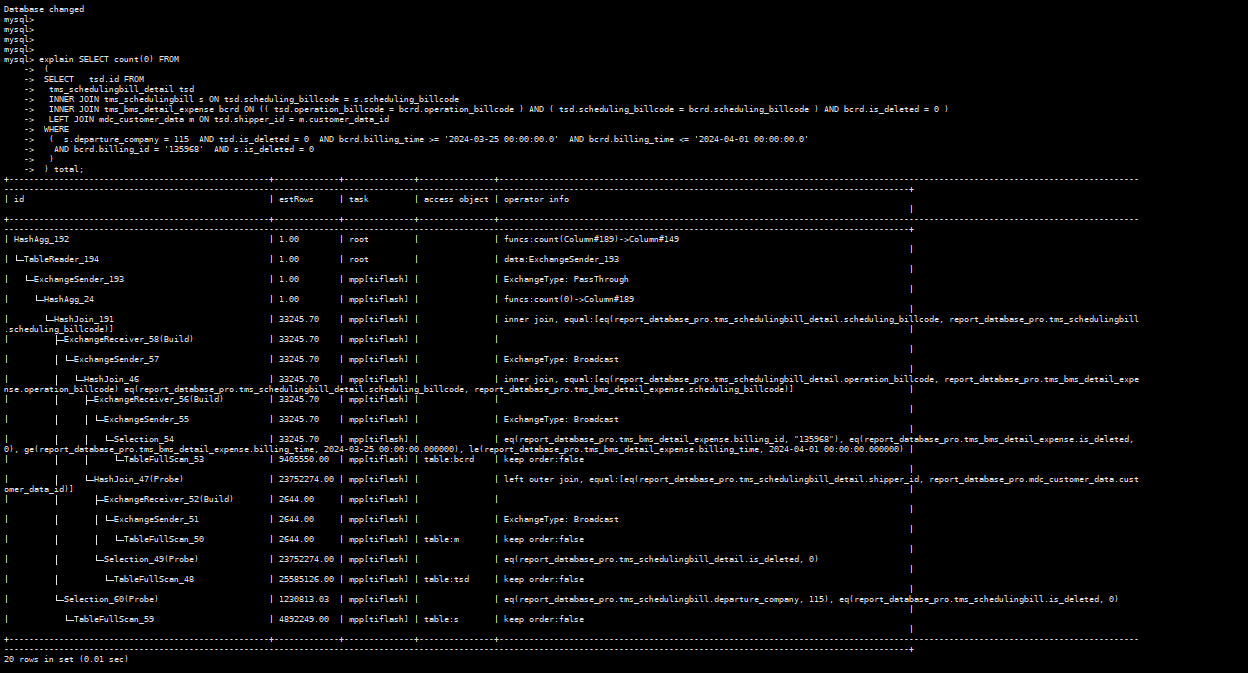

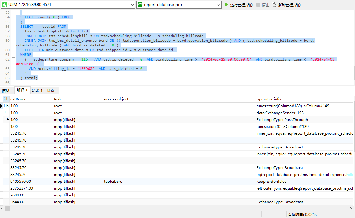

删除这两个binding后,Navicat 和命令行都走tiflash了。 ![]()

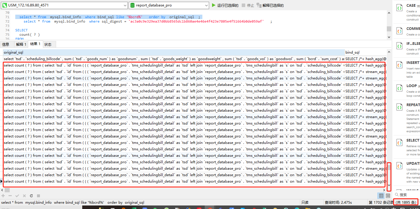

请问如何自行定位错误的binding呢?
在一望无际的binding大海中,如何捞到这个“sql_digest ”的呢? (SQL 执行后,如何查找它的sql_digest )
select * from mysql.bind_info where sql_digest = ‘ac3a0c9e329ea37d0bb8565dc1b860ae4e46e4f423e7805e4f51664b0de059af’ ;
删除掉原来的binding后,已经生成新的binding.
SELECT /+ hash_agg(@
sel_1), read_from_storage(@sel_1 tiflash[report_database_pro.s])/ count(0) FROM (SELECT tsd.id FROM ((report_database_pro.tms_schedulingbill_detail AS tsd JOIN report_database_pro.tms_schedulingbill AS s ON tsd.scheduling_billcode = s.scheduling_billcode) JOIN report_database_pro.tms_bms_detail_expense AS bcrd ON ((tsd.operation_billcode = bcrd.operation_billcode) AND (tsd.scheduling_billcode = bcrd.scheduling_billcode) AND bcrd.is_deleted = 0)) LEFT JOIN report_database_pro.mdc_customer_data AS m ON tsd.shipper_id = m.customer_data_id WHERE (s.departure_company = 115 AND tsd.is_deleted = 0 AND bcrd.billing_time >= ‘2024-03-25 00:00:00.0’ AND bcrd.billing_time <= ‘2024-04-01 00:00:00.0’ AND bcrd.billing_id = ‘135968’ AND s.is_deleted = 0)) AS total
这是因为你开启了自动捕获功能, 可以通过添加黑名单的方式过滤是否捕获新的 binding https://docs.pingcap.com/zh/tidb/v6.5/sql-plan-management#自动捕获绑定-baseline-capturing
