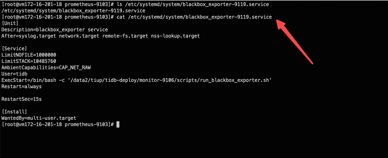

【遇到的问题:问题现象及影响】使用tiup关闭集群,其它组件关闭完成,blackbox未关闭;之后单独手动执行关闭blackbox完成。
Error: failed to stop: 10.10.0.1 node exporter-9100.service, please check the instance’s log() for more detail.: timed out waiting for port 9100 to e stopped after 2m0s
2024-06-12T16:57:17.026+0800 INFO Execute command finished {“code”: 1, “error”: “failed to stop: 10.10.0.1 node_exporter-9100.service, please check the instance’s log() for more detail.: timed out waiting for port 9100 to be stopped after 2m0s”, “errorVerbose”: “timed out waiting for port 9100 to be stopped after 2m0s\ngithub.com/pingcap/tiup/pkg/cluster/module.(*WaitFor).Execute\n\tgithub.com/pingcap/tiup/pkg/cluster/module/wait_for.go:91\ngithub.com/pingcap/tiup/pkg/cluster/spec.PortStopped\n\tgithub.com/pingcap/tiup/pkg/cluster/spec/instance.go:130\ngithub.com/pingcap/tiup/pkg/cluster/operation.systemctlMonitor.func1\n\tgithub.com/pingcap/tiup/pkg/cluster/operation/action.go:338\ngolang.org/x/sync/errgroup.(*Group).Go.func1\n\tgolang.org/x/sync@v0.0.0-20220819030929-7fc1605a5dde/errgroup/errgroup.go:75\nruntime.goexit\n\truntime/asm_amd64.s:1594\nfailed to stop: 10.10.0.1 node_exporter-9100.service, please check the instance’s log() for more detail.”}
