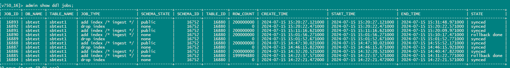

分布式DDL时间变的更长

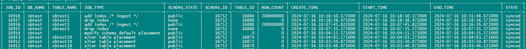

一张2亿表建索引测试
不使用分布式ddl时 执行时间和CPU如下

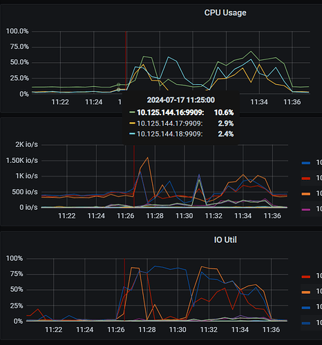

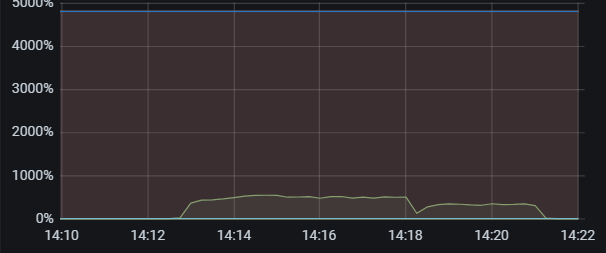

当通过调整tidb_service_scope tidb_enable_dist_task 开启并行DDL后 建索引时间反而变的更长,3个tidb节点是时间如下

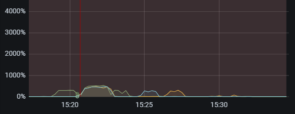

从tidb cpu上看 每个tidb执行是并不像单tidb一样一直持续的执行的

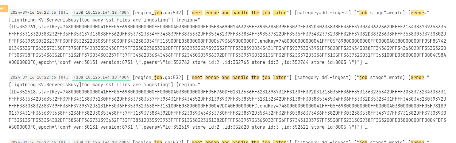

[2024/07/15 15:25:32.518 +08:00] [WARN] [region_job.go:532] ["meet error and handle the job later"] [category=ddl-ingest] ["job stage"=wrote] [error="[Lightning:KV:ServerIsBusy]too many sst files are ingesting"] [region="{ID=122161,startKey=7480000000000041FFF05F698000000000FF0000080380000000FF0708A84D01383530FF3830373139FF3531FF392D37303934FF36FF3133323630392DFFFF3830353338343437FFFF3337342D383237FF37FF343239323435FF352DFF3633303434FF323437FF3637342DFF35393239FF393032FF383330352DFF3638FF353932323935FF36FF37352D31303135FFFF333235383831302DFFFF34323136343631FF35FF3433302D3139FF3832FF3239323839FF383900FE03800000FF00012BBB6D000000FC,endKey=7480000000000041FFF05F698000000000FF0000080380000000FF0745460E01393533FF3433303233FF3338FF332D34303735FF32FF3936313434372DFFFF3831303532353432FFFF3230382D393339FF30FF303539353039FF312DFF3731393134FF313737FF3531392DFF38323736FF393238FF313334342DFF3334FF323930333634FF34FF30312D38313839FFFF373134323732382DFFFF34333034383236FF37FF3230352D3835FF3033FF3433383032FF313100FE03800000FF00090B61F7000000FC,epoch=\"conf_ver:30125 version:8670 \",peers=\"id:122163 store_id:1 ,id:122299 store_id:3 ,id:122300 store_id:8007 \"}"] [start=7480000000000041F05F69800000000000000803800000000708A84D013835303830373139FF3531392D37303934FF363133323630392DFF3830353338343437FF3337342D38323737FF343239323435352DFF3633303434323437FF3637342D35393239FF393032383330352DFF3638353932323935FF3637352D31303135FF333235383831302DFF3432313634363135FF3433302D31393832FF3239323839383900FE0380000000012BBB6D] [end=7480000000000041F05F6980000000000000080380000000071AC7EB013939353232353837FF3836392D30393234FF383831373634372DFF3231363932383931FF3236362D38313731FF353430343735372DFF3530323634333937FF3633392D31333639FF313234343636332DFF3037353836323438FF3837312D37323532FF343334363233372DFF3538353930383036FF3834342D34363939FF3633373530313300FE038000000009DD3F84]
[2024/07/15 15:25:32.518 +08:00] [INFO] [local.go:1461] ["put job back to jobCh to retry later"] [category=ddl-ingest] [startKey=7480000000000041F05F69800000000000000803800000000708A84D013835303830373139FF3531392D37303934FF363133323630392DFF3830353338343437FF3337342D38323737FF343239323435352DFF3633303434323437FF3637342D35393239FF393032383330352DFF3638353932323935FF3637352D31303135FF333235383831302DFF3432313634363135FF3433302D31393832FF3239323839383900FE0380000000012BBB6D] [endKey=7480000000000041F05F6980000000000000080380000000071AC7EB013939353232353837FF3836392D30393234FF383831373634372DFF3231363932383931FF3236362D38313731FF353430343735372DFF3530323634333937FF3633392D31333639FF313234343636332DFF3037353836323438FF3837312D37323532FF343334363233372DFF3538353930383036FF3834342D34363939FF3633373530313300FE038000000009DD3F84] [stage=wrote] [retryCount=1] [waitUntil=2024/07/15 15:25:34.518 +08:00]

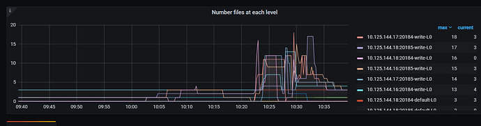

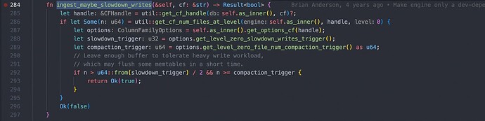

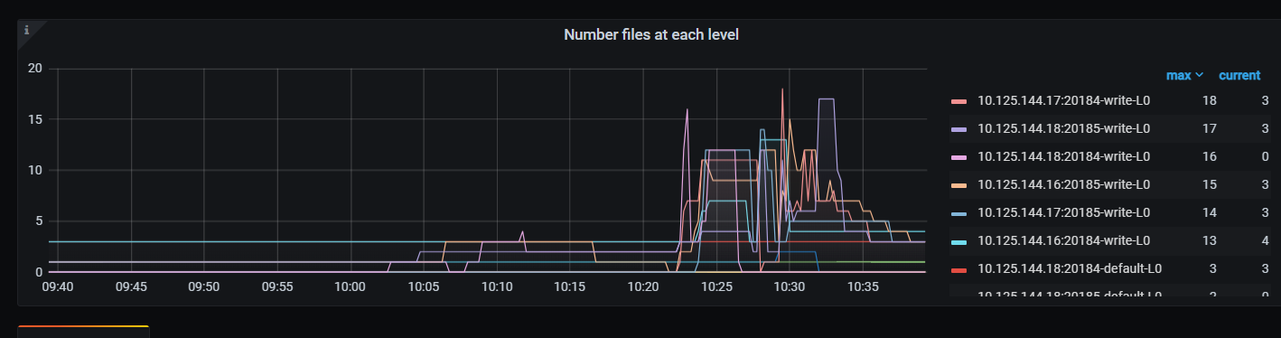

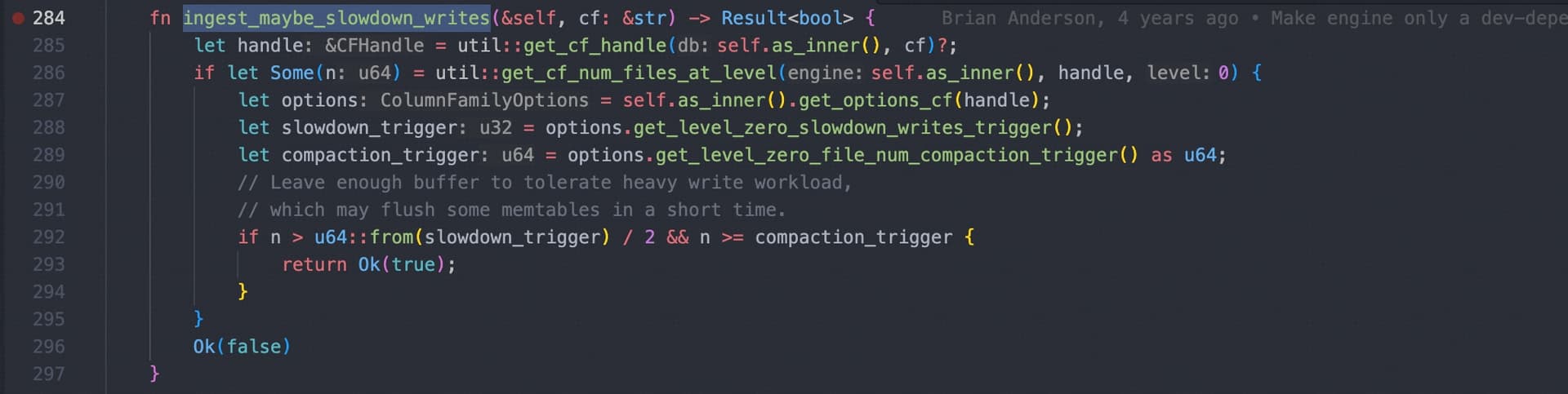

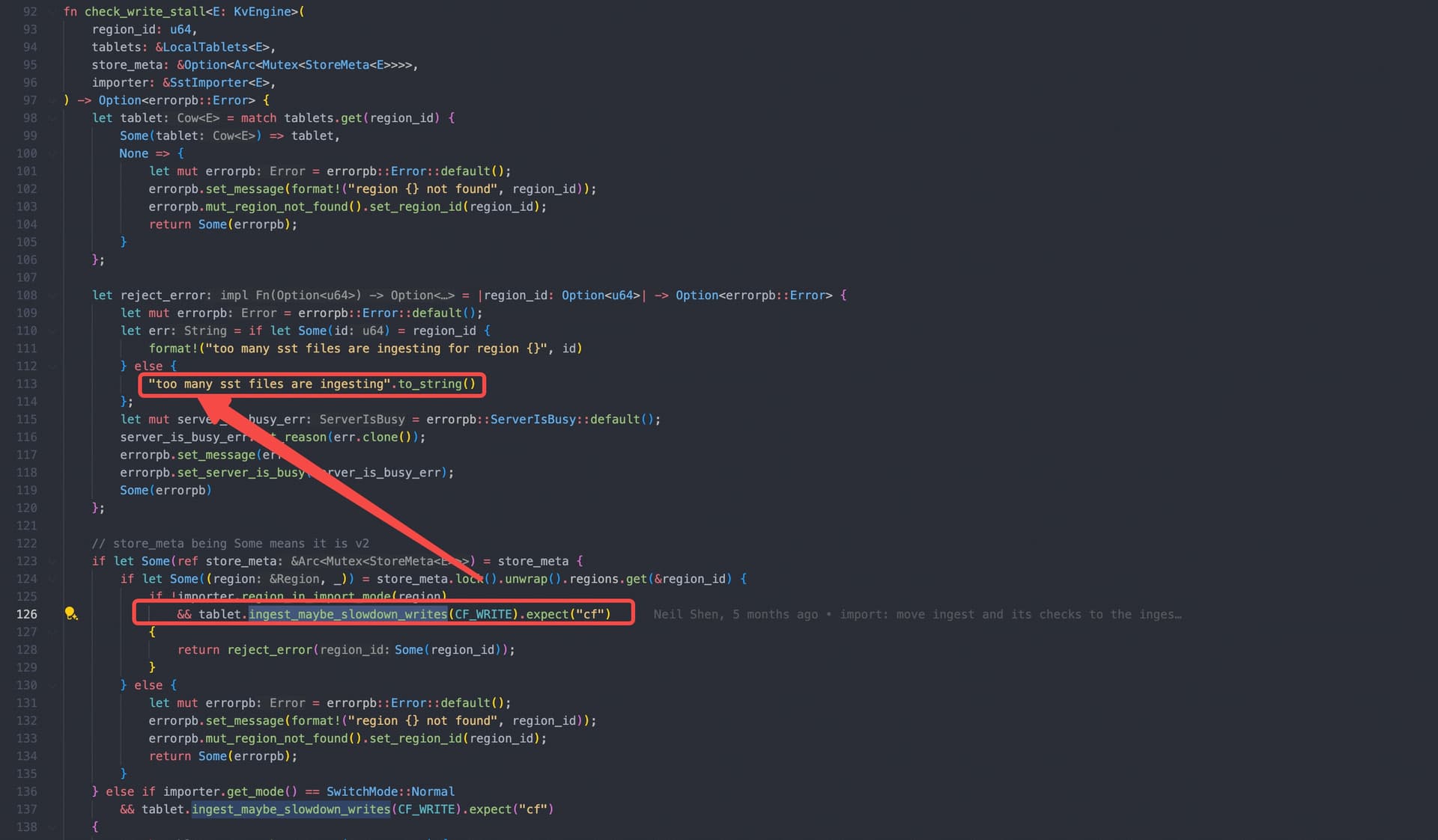

inject sst 失败的原因是写的太快导致了 L0 的文件太多了,然后 inject 就失败了,
相关的 tikv 代码如下:
建议适当的降低 tidb_ddl_reorg_worker_cnt 和 tidb_ddl_reorg_batch_size 减少写压力来减少 retry。
另外,如果瓶颈在 tikv 上,分布是 ddl 并不比非分布 ddl 快,这个符合理论预期的。

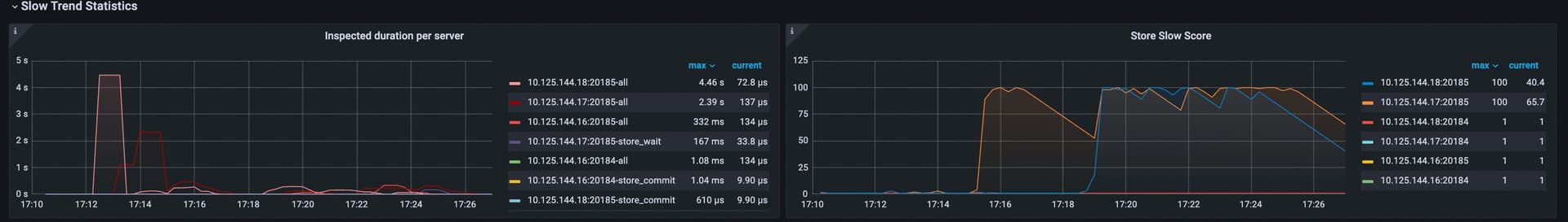

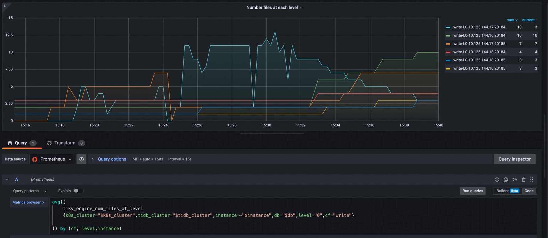

@h5n1 另外从监控可以看 inject sst 到各个 tikv 是不均衡的,如下监控可以看,热点集中在 10.125.144.17:20184
因此可以查一下这个 table index 的在各个 tikv 上分布,然后可以尝试参考文档打散这个 table,这样可以降低上述错误发生的概率, https://docs.pingcap.com/zh/tidb/stable/pd-scheduling-best-practices#热点分布不均匀

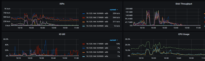

刚才检查region分布 发现这个表之前有placement 都放到17这个节点了(3tidb 6tikv ssd盘,目前就这1个表有数据)。取消placement 自动均衡后测试发现速度比之前还慢,单tidb 8 min 40.27 sec ,3tidb分布式 12 min 58.50 sec 。
从监控看L0达到的数据量比之前还要多
资源还是比较充足

当前你遇到的这个问题出现的原因是,多个 tidb 各自处理一部分 table range,将里面的索引列抽取出来编码成一组索引 kv,因为索引数据的顺序是不确定的,所以每个 tidb 只能通过本地排序保证自己的那一组索引 kv 有序,而 tidb 之间不同组 kv 可能有 overlap,这种 overlap 导致了 tikv rocksdb L0 文件太多,写入被限流 https://docs.pingcap.com/zh/tidb/stable/tikv-configuration-file#l0-files-threshold 。
解决方法是启动 global sort,参考文档 https://docs.pingcap.com/zh/tidb/stable/tidb-global-sort,global sort 依赖一个外部的存储,在外部存储上排好序然后再分给 tikv,这样写入就没有 overlap,所以并行导入效率就会变高。
不过,考虑到配置外部存储也要成本,像几亿这个量级的数据,单机一趟就能完成的话还是建议用单机模式。
另外,默认单机本地盘空间是 100GB,如果要加的索引数据超过了 100GB,还使用单机 DDL 的话需要改大 tidb_ddl_disk_quota 到 n * 100GB。

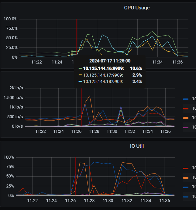

用s3排序跑了下,执行了10 min 27.84 sec,因为minio和tikv在同一个盘上 ,不知道资源争用能影响多少,不过tidb里到是没有ingest那种失败了

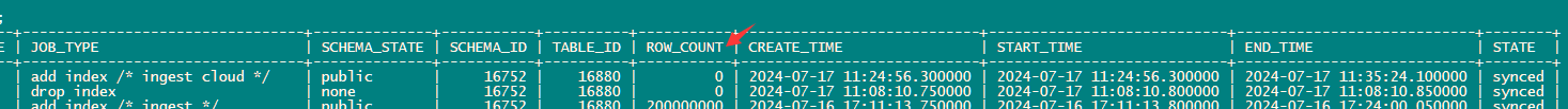

另外有个问题 admin show ddl 这里不显示行数进度

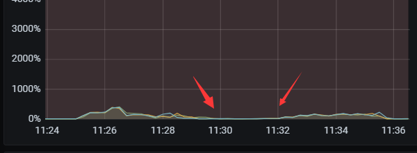

看tidb CPU 中间有段时间 貌似处于了暂停状态

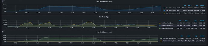

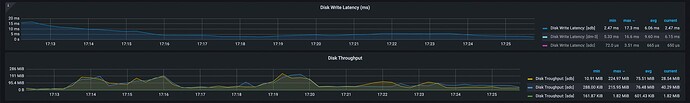

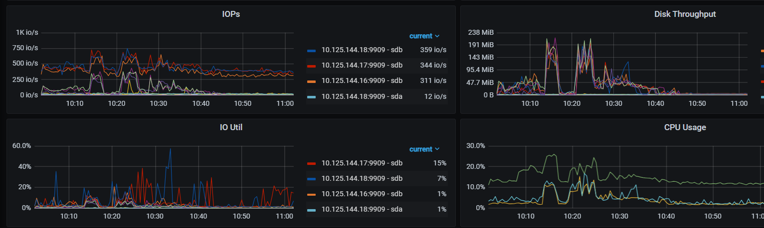

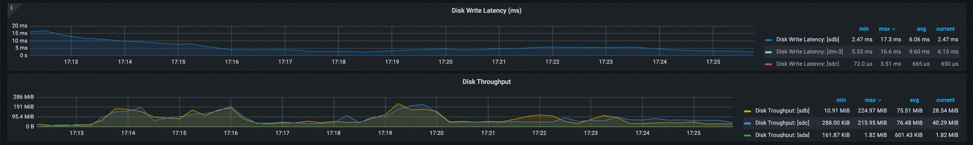

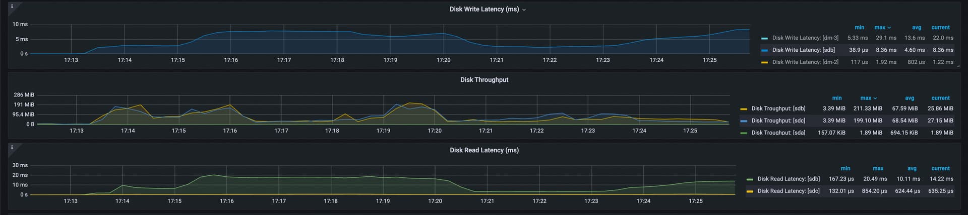

问题 2: 本质是调参导致 tikv 写压力更大,叠加上盘慢,触发了流控和 slow store evict.
这个是 18 上 sdb和 17 上 sdb 磁盘监控的 write latency 可以看到:

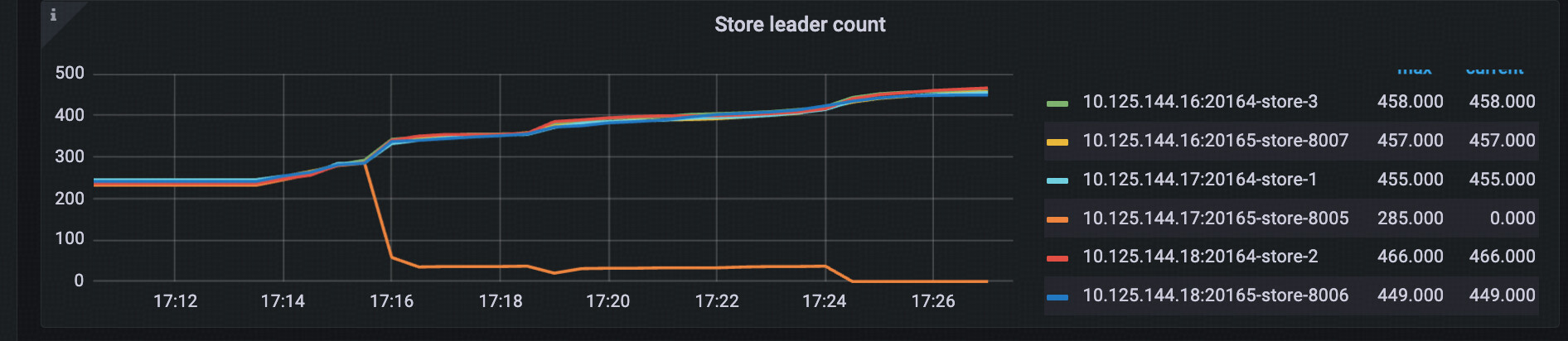

调大 L0 threshhold 后,tikv 压力也就更大了,写入变慢,触发了 slow store 检测,
region leader 的变更,导致 ddl 遇到大量如下的报错:
[2024/07/16 17:17:58.310 +08:00] [WARN] [region_job.go:532] ["meet error and handle the job later"] [category=ddl-ingest] ["job stage"=needRescan] [error="[Lightning:KV:NotLeader]peer is not leader for region 361501, leader may Some(id: 361503 store_id: 2)"] [] [start=7480000000000041F05F69800000000000000B038000000005FE40AF013039373938373139FF3338312D33393734FF343531303636372DFF3436313535383633FF3331352D34383332FF373031373733372DFF3235313432343438FF3536342D35333533FF383136313239332DFF3631373431373135FF3532392D38393231FF383630353432312DFF3537393037383531FF3130382D34313437FF3832373836323800FE03800000000685F601] [end=7480000000000041F05F69800000000000000B038000000005FE44D8013436353533363337FF3034352D38383134FF323234323632302DFF3239323535383535FF3836392D34313130FF343433383235352DFF3734363537393834FF3338302D35373535FF373239333330392DFF3035303239313130FF3136372D34313634FF393332303134332DFF3830363033313036FF3934362D31363536FF3735303937323200FE0380000000096FA99A]
