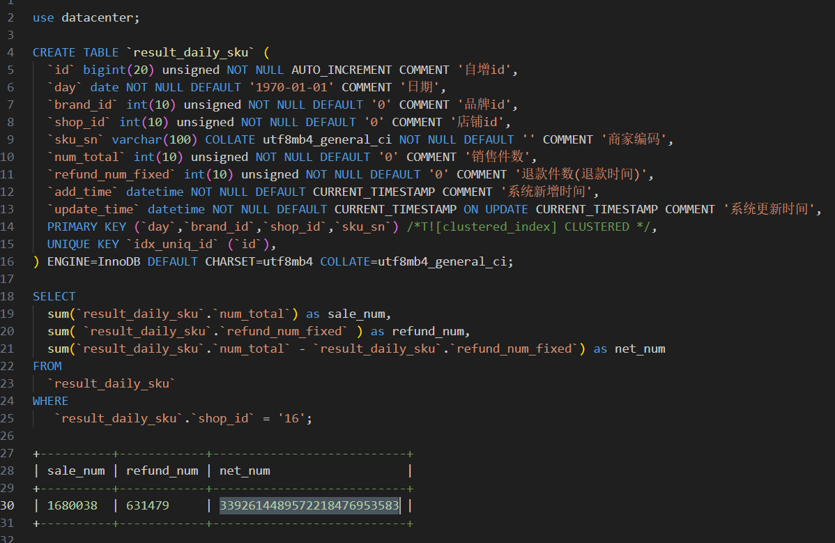

字段都是非负整数,但是sum(a-b)的查询结果很大很大
贴个文本怎么样
CREATE TABLE result_daily_sku (
id bigint(20) unsigned NOT NULL AUTO_INCREMENT COMMENT ‘自增id’,
day date NOT NULL DEFAULT ‘1970-01-01’ COMMENT ‘日期’,
brand_id int(10) unsigned NOT NULL DEFAULT ‘0’ COMMENT ‘品牌id’,
shop_id int(10) unsigned NOT NULL DEFAULT ‘0’ COMMENT ‘店铺id’,
sku_sn varchar(100) COLLATE utf8mb4_general_ci NOT NULL DEFAULT ‘’ COMMENT ‘商家编码’,
num_total int(10) unsigned NOT NULL DEFAULT ‘0’ COMMENT ‘销售件数’,
refund_num_fixed int(10) unsigned NOT NULL DEFAULT ‘0’ COMMENT ‘退款件数(退款时间)’,
add_time datetime NOT NULL DEFAULT CURRENT_TIMESTAMP COMMENT ‘系统新增时间’,
update_time datetime NOT NULL DEFAULT CURRENT_TIMESTAMP ON UPDATE CURRENT_TIMESTAMP COMMENT ‘系统更新时间’,
PRIMARY KEY (day,brand_id,shop_id,sku_sn) /*T![clustered_index] CLUSTERED */,
UNIQUE KEY idx_uniq_id (id),
) ENGINE=InnoDB DEFAULT CHARSET=utf8mb4 COLLATE=utf8mb4_general_ci;
SELECT
sum(result_daily_sku.num_total) as sale_num,
sum( result_daily_sku.refund_num_fixed ) as refund_num,
sum(result_daily_sku.num_total - result_daily_sku.refund_num_fixed) as net_num
FROM
result_daily_sku
WHERE
result_daily_sku.shop_id = ‘16’;
| sale_num | refund_num | net_num |
| 1680038 | 631479 | 3392614489572218476953583 |

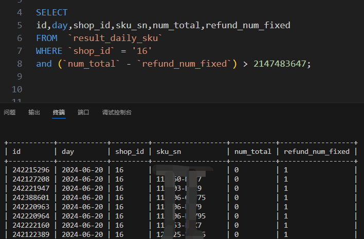

猜测是因为 result_daily_sku.num_total - result_daily_sku.refund_num_fixed 有负数,但是这就溢出了也不好呀
加个where a-b>值,找找异常数据
试了一下,没有 a-b 小于0 的记录
