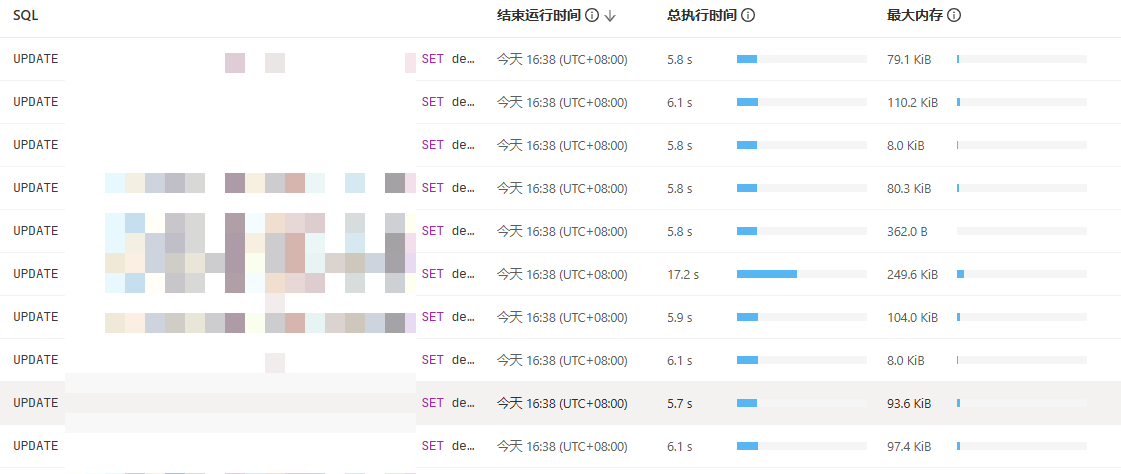

tidb update操作很慢,请求协助
【资源配置】tikv 32C128G

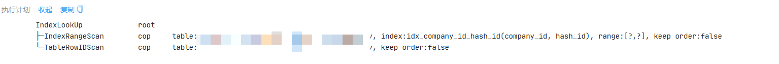

发一下执行计划呢

insert的方式也很慢
| id | estRows | estCost | actRows | task | access object | execution info | operator info | memory | disk |
| Insert_1 | 0.00 | 0.00 | 0 | root | | time:9.77s, loops:39, prepare: 2m23.6s, check_insert: {total_time: 6.46s, mem_insert_time: 4.34ms, prefetch: 6.45s, rpc:{BatchGet:{num_rpc:90, total_time:695.3ms},ResolveLock:{num_rpc:50, total_time:414.8ms},txnNotFound_backoff:{num:1, total_time:2ms},txnLockFast_backoff:{num:49, total_time:5.33s}, time_detail: {total_wait_time: 31ns, total_kv_read_wall_time: 37.2ms, tikv_wall_time: 37.8ms}, scan_detail: {total_process_keys: 8, total_process_keys_size: 22256, total_keys: 21, get_snapshot_time: 35.6ms, rocksdb: {key_skipped_count: 9, block: {cache_hit_count: 138}}}}}, commit_txn: {prewrite:783.5µs, region_num:3, write_keys:12, write_byte:21868, txn_retry:1}, lock_keys: {time:1.67ms, region:2, keys:8, slowest_rpc: {total: 0.001s, region_id: 1138422, store: 10.50.124.84:20160, time_detail: {tikv_wall_time: 633.4µs}, scan_detail: {get_snapshot_time: 6.37µs, rocksdb: {key_skipped_count: 68, block: {cache_hit_count: 176}}}, }, lock_rpc:1.625044ms, rpc_count:2} | N/A | 24.1 KB | N/A |

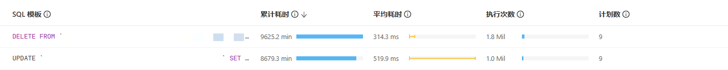

什么版本的
感觉有锁冲突
8.1.1
这个咋解决呀
https://docs.pingcap.com/zh/tidb/stable/troubleshoot-lock-conflicts#处理乐观锁冲突问题
获取最近发生的死锁错误的信息看看:select * from information_schema.deadlocks; 以及 少数热点 key 造成锁排队:select key, count(*) as count from information_schema.data_lock_waits group by key order by count desc;
操作数据的时候,尽量不要怼着同一个 ID 发起并发更新,
insert 不会导致lock 的,一般是 update
