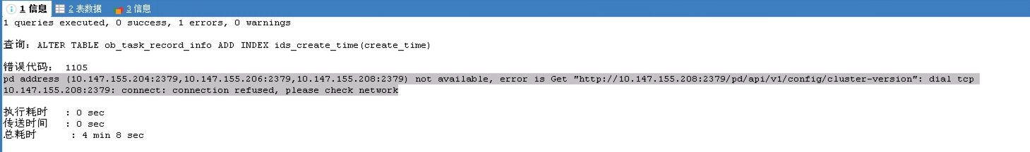

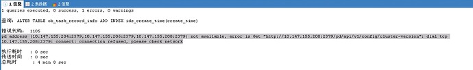

问题描述:添加索引卡住不动,报错退出
错误信息:
pd address (10.147.155.204:2379,10.147.155.206:2379,10.147.155.208:2379) not available, error is Get “http://10.147.155.208:2379/pd/api/v1/config/cluster-version”: dial tcp 10.147.155.208:2379: connect: connection refused, please check network
