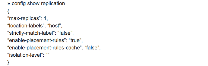

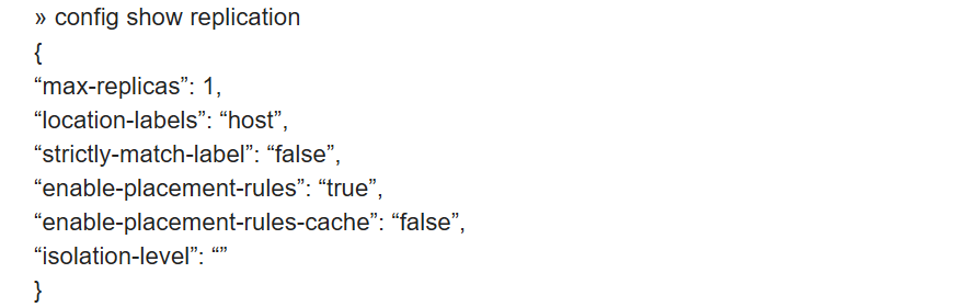

操作步骤如下:
(1)使用pd_ctl修改3副本为单副本
tiup ctl:v7.5.0 pd -i -u http://127.0.0.1:2379
» config show replication
“max-replicas”: 3,
“location-labels”: “host”,
“strictly-match-label”: “false”,
“enable-placement-rules”: “true”,
“enable-placement-rules-cache”: “false”,
“isolation-level”: “”
» config set max-replicas 1
Success!
“max-replicas”: 1,

默认3副本,我已经修改成1副本啦
去看 PD 监控,看看调度正常不,看你前边发的就剩 3 个没迁移走,不行手工加下 operator,用 pd-ctl 命令
你怎么改的,生效了吗
show config where name like ‘replication.max-replicas’

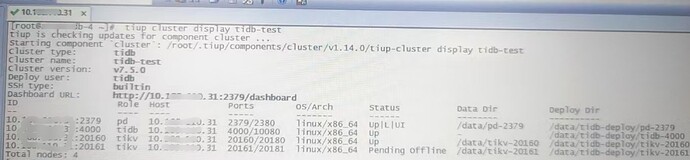

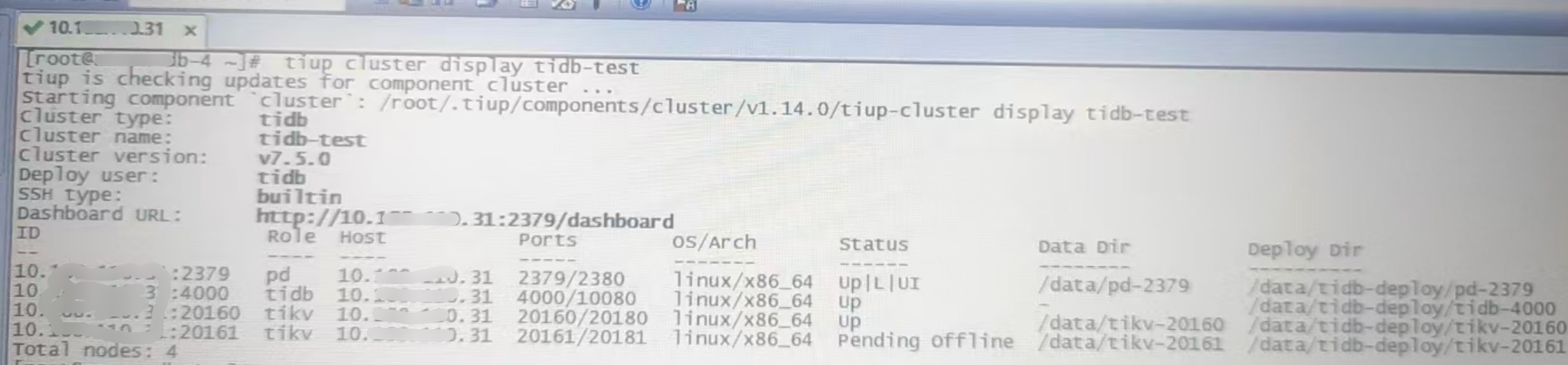

[root@zz-pw-db-4 ~]# tiup cluster display tidb-test
tiup is checking updates for component cluster ...
Starting component `cluster`: /root/.tiup/components/cluster/v1.14.0/tiup-cluster display tidb-test
Cluster type: tidb
Cluster name: tidb-test
Cluster version: v7.5.0
Deploy user: tidb
SSH type: builtin
Dashboard URL: http://10.188.110.31:2379/dashboard
10.188.110.31:2379 pd 10.188.110.31 2379/2380 linux/x86_64 Up|L|UI /data/pd-2379 /data/tidb-deploy/pd-2379
10.188.110.31:4000 tidb 10.188.110.31 4000/10080 linux/x86_64 Up - /data/tidb-deploy/tidb-4000
10.188.110.31:20160 tikv 10.188.110.31 20160/20180 linux/x86_64 Up /data/tikv-20160 /data/tidb-deploy/tikv-20160
10.188.110.31:20161 tikv 10.188.110.31 20161/20181 linux/x86_64 Pending Offline /data/tikv-20161 /data/tidb-deploy/tikv-20161

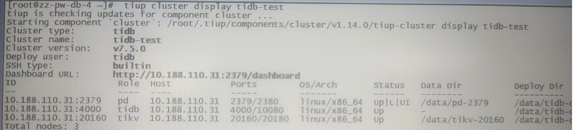

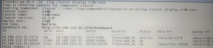

Cluster type: tidb
Deploy user: tidb
SSH type: builtin
Total nodes: 3
