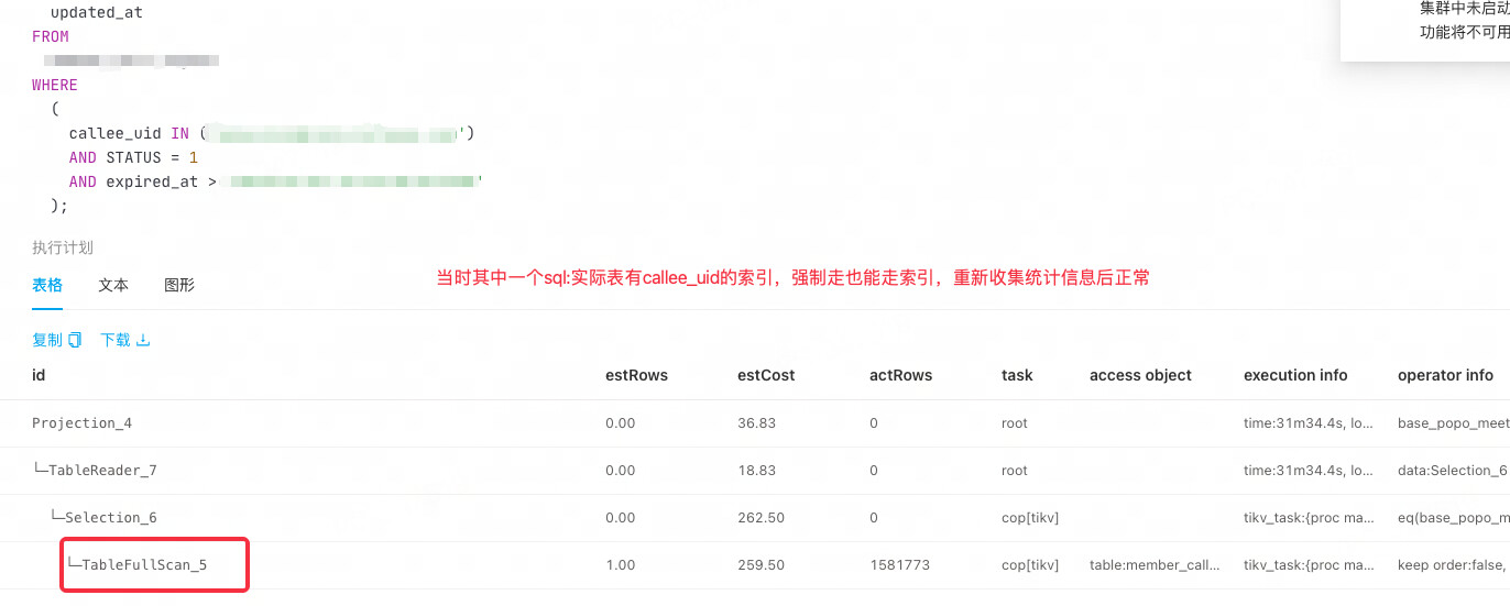

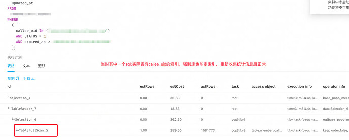

这次问题体现是:
升级到7.5.6之后发现很多请求全部卡住,拿sql看了一下 发现全部走了全表扫描
如下:

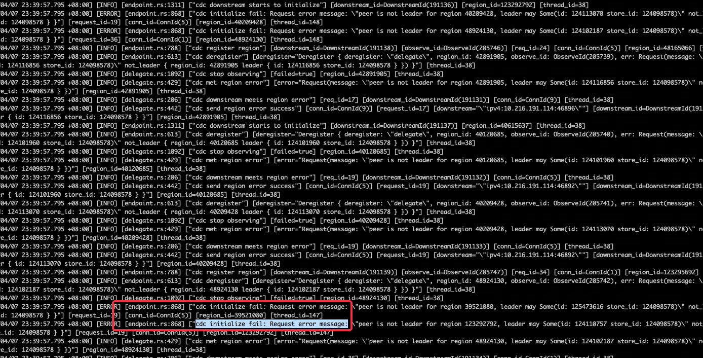

tikv日志报大量的 cdc相关的错误,我们确实也存在cdc服务,

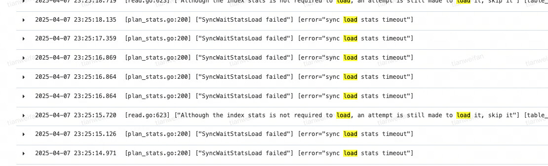

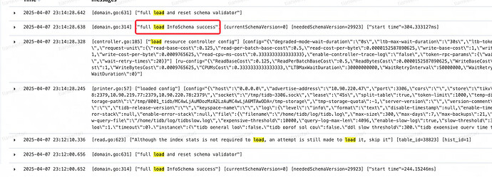

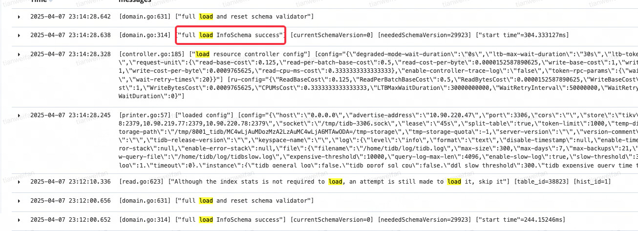

整个过程中,升级tikv也没有问题,看起来是升级tidb-server之后开始有问题
怀疑是tidb server没有加载到统计信息
从升级过程中的日志来看 tidb server成功加载了 schema
但是stats 看着是加载失败了
还有一个这个错误
[handle_hist.go:125] [“SyncWaitStatsLoad meets error”] [errors="["sync load took too long to return","sync load took too long to return","sync load took too long to return","sync load took too long to return","sync load took too long to return","sync load took too long to return","sync load took too long to return","sync load took too long to return","sync load took too long to return","sync load took too long to return","sync load took too long to return","sync load took too long to return","sync load took too long to return","sync load took too long to return","sync load took too long to return","sync load took too long to return","sync load took too long to return","sync load took too long to return","sync load took too long to return","sync load took too long to return","sync load stats channel is full and timeout sending task to channel","sync load stats channel is full and timeout sending task to channel","sync load stats channel is full and timeout sending task to channel","sync load took too long to return","sync load stats channel is full and timeout

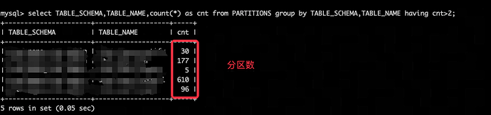

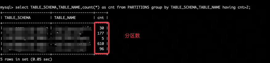

实例的有几个表有分区,分区数如下:

升级过程中出现超时导致的

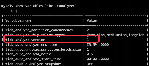

c从V5.3以后 tidb_analyze_version 默认值是2 呀,这里是修改过统计信息的一些参数吗?
估计是从低版本升上来的,这个参数会保持默认

还有可能是大量分区表的统计信息加载压力较大,可能加剧超时问题
