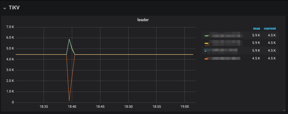

tidb 版本 4.0.13
业务反馈今天18:40左右业务报了一波超时,查看监控定位到有个tikv上的所有leader都切了一下,但是很快就恢复,查看pd leader日志再18:38:56开始刷了大量的leader change的日志,查看一场tikv节点也可以看到很多 not leader的日志,但是都没找到明确的原因。
pd leader的日志

[2025/04/22 18:38:56.839 +08:00] [INFO] [cluster.go:566] ["leader changed"] [region-id=912] [from=156469] [to=41493]

异常节点tikv的同期日志
[2025/04/22 18:24:58.524 +08:00] [INFO] [util.rs:226] ["heartbeat sender and receiver are stale, refreshing ..."]

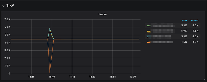

[2025/04/22 18:39:00.364 +08:00] [INFO] [raft.rs:1003] ["received a message with higher term from 186972"] ["msg type"=MsgAppendResponse] [message_term=14] [term=13] [from=186972] [raft_id=156544] [region_id=53051]
[2025/04/22 18:39:01.680 +08:00] [INFO] [raft.rs:783] ["became follower at term 14"] [term=14] [raft_id=156544] [region_id=53051]
[2025/04/22 18:39:02.247 +08:00] [INFO] [raft.rs:1192] ["[logterm: 13, index: 35, vote: 0] cast vote for 53054 [logterm: 13, index: 35] at term 14"] ["msg type"=MsgRequestPreVote] [term=14] [msg_index=35] [msg_term=13] [from=53054] [vote=0] [log_index=35] [log_term=13] [raft_id=156544] [region_id=53051]
[2025/04/22 18:39:02.747 +08:00] [INFO] [raft.rs:1192] ["[logterm: 13, index: 35, vote: 0] cast vote for 53054 [logterm: 13, index: 35] at term 14"] ["msg type"=MsgRequestVote] [term=14] [msg_index=35] [msg_term=13] [from=53054] [vote=0] [log_index=35] [log_term=13] [raft_id=156544] [region_id=53051]
[2025/04/22 18:39:03.904 +08:00] [INFO] [raft.rs:971] ["[logterm: 14, index: 32, vote: 157273] ignored vote from 51056 [logterm: 14, index: 32]: lease is not expired"] ["msg type"=MsgRequestPreVote] ["remaining ticks"=10] [term=14] [msg_index=32] [msg_term=14] [from=51056] [vote=157273] [log_index=32] [log_term=14] [raft_id=157273] [region_id=51053]
[2025/04/22 18:39:04.963 +08:00] [WARN] [apply.rs:546] ["[store 156469] handle ready 1 committed entries"] [takes=1001]
[2025/04/22 18:39:06.256 +08:00] [WARN] [process.rs:190] ["[region 3348] scheduler handle command: prewrite, ts: 457524728578441220"] [takes=2566]
[2025/04/22 18:39:08.721 +08:00] [INFO] [tracker.rs:241] [slow-query] [perf_stats.internal_delete_skipped_count=0] [perf_stats.internal_key_skipped_count=2] [perf_stats.block_read_byte=0] [perf_stats.block_read_count=0] [perf_stats.block_cache_hit_count=10] [scan.range.first="Some(start: 7480000000000000375F69800000000000000203806BFD3954C24E00 end: 7480000000000000375F69800000000000000203806BFD3954C24E01)"] [scan.ranges=1] [scan.total=3] [scan.processed=2] [scan.is_desc=false] [tag=index] [table_id=55] [txn_start_ts=457524728224546822] [total_suspend_time=0ns] [total_process_time=4.194s] [handler_build_time=94ms] [wait_time.snapshot=262ms] [wait_time.schedule=0ns] [wait_time=262ms] [total_lifetime=4.641s] [remote_host=ipv4:192.168.4.89:47098] [region_id=3072]
[2025/04/22 18:39:08.729 +08:00] [ERROR] [<unknown>] ["ipv4:192.168.4.89:47096: Keepalive watchdog fired. Closing transport."]
[2025/04/22 18:39:08.769 +08:00] [INFO] [raft.rs:971] ["[logterm: 17, index: 648150, vote: 157573] ignored vote from 101113 [logterm: 17, index: 648150]: lease is not expired"] ["msg type"=MsgRequestPreVote] ["remaining ticks"=4] [term=17] [msg_index=648150] [msg_term=17] [from=101113] [vote=157573] [log_index=648150] [log_term=17] [raft_id=157573] [region_id=77188]
[2025/04/22 18:39:08.770 +08:00] [INFO] [raft.rs:971] ["[logterm: 6, index: 6, vote: 169165] ignored vote from 169164 [logterm: 6, index: 6]: lease is not expired"] ["msg type"=MsgRequestPreVote] ["remaining ticks"=2] [term=6] [msg_index=6] [msg_term=6] [from=169164] [vote=169165] [log_index=6] [log_term=6] [raft_id=169165] [region_id=169163]
[2025/04/22 18:39:08.770 +08:00] [INFO] [raft.rs:971] ["[logterm: 6, index: 6, vote: 169165] ignored vote from 169164 [logterm: 6, index: 6]: lease is not expired"] ["msg type"=MsgRequestVote] ["remaining ticks"=2] [term=6] [msg_index=6] [msg_term=6] [from=169164] [vote=169165] [log_index=6] [log_term=6] [raft_id=169165] [region_id=169163]
[2025/04/22 18:39:08.770 +08:00] [INFO] [raft.rs:1003] ["received a message with higher term from 169164"] ["msg type"=MsgAppend] [message_term=7] [term=6] [from=169164] [raft_id=169165] [region_id=169163]
[2025/04/22 18:39:08.770 +08:00] [INFO] [raft.rs:783] ["became follower at term 7"] [term=7] [raft_id=169165] [region_id=169163]
[2025/04/22 18:39:08.770 +08:00] [INFO] [raft.rs:971] ["[logterm: 10, index: 4970022, vote: 157679] ignored vote from 103264 [logterm: 10, index: 4970022]: lease is not expired"] ["msg type"=MsgRequestPreVote] ["remaining ticks"=10] [term=10] [msg_index=4970022] [msg_term=10] [from=103264] [vote=157679] [log_index=4970022] [log_term=10] [raft_id=157679] [region_id=69524]
[2025/04/22 18:39:08.770 +08:00] [INFO] [raft.rs:971] ["[logterm: 10, index: 4970022, vote: 157679] ignored vote from 103264 [logterm: 10, index: 4970022]: lease is not expired"] ["msg type"=MsgRequestVote] ["remaining ticks"=10] [term=10] [msg_index=4970022] [msg_term=10] [from=103264] [vote=157679] [log_index=4970022] [log_term=10] [raft_id=157679] [region_id=69524]
[2025/04/22 18:39:08.770 +08:00] [INFO] [raft.rs:1003] ["received a message with higher term from 103264"] ["msg type"=MsgAppend] [message_term=11] [term=10] [from=103264] [raft_id=157679] [region_id=69524]
[2025/04/22 18:39:08.770 +08:00] [INFO] [raft.rs:783] ["became follower at term 11"] [term=11] [raft_id=157679] [region_id=69524]
[2025/04/22 18:39:08.782 +08:00] [INFO] [raft.rs:971] ["[logterm: 16, index: 3985828, vote: 157909] ignored vote from 91839 [logterm: 16, index: 3985828]: lease is not expired"] ["msg type"=MsgRequestPreVote] ["remaining ticks"=4] [term=16] [msg_index=3985828] [msg_term=16] [from=91839] [vote=157909] [log_index=3985828] [log_term=16] [raft_id=157909] [region_id=60239]
[2025/04/22 18:39:08.782 +08:00] [INFO] [raft.rs:971] ["[logterm: 16, index: 3985828, vote: 157909] ignored vote from 91839 [logterm: 16, index: 3985828]: lease is not expired"] ["msg type"=MsgRequestVote] ["remaining ticks"=4] [term=16] [msg_index=3985828] [msg_term=16] [from=91839] [vote=157909] [log_index=3985828] [log_term=16] [raft_id=157909] [region_id=60239]
[2025/04/22 18:39:08.782 +08:00] [INFO] [raft.rs:1003] ["received a message with higher term from 91839"] ["msg type"=MsgAppend] [message_term=17] [term=16] [from=91839] [raft_id=157909] [region_id=60239]
[2025/04/22 18:39:08.782 +08:00] [INFO] [raft.rs:783] ["became follower at term 17"] [term=17] [raft_id=157909] [region_id=60239]
[2025/04/22 18:39:08.782 +08:00] [INFO] [raft.rs:971] ["[logterm: 14, index: 576972, vote: 159582] ignored vote from 98580 [logterm: 14, index: 576972]: lease is not expired"] ["msg type"=MsgRequestPreVote] ["remaining ticks"=5] [term=14] [msg_index=576972] [msg_term=14] [from=98580] [vote=159582] [log_index=576972] [log_term=14] [raft_id=159582] [region_id=77306]
[2025/04/22 18:39:08.782 +08:00] [INFO] [raft.rs:971] ["[logterm: 14, index: 576972, vote: 159582] ignored vote from 98580 [logterm: 14, index: 576972]: lease is not expired"] ["msg type"=MsgRequestVote] ["remaining ticks"=5] [term=14] [msg_index=576972] [msg_term=14] [from=98580] [vote=159582] [log_index=576972] [log_term=14] [raft_id=159582] [region_id=77306]
[2025/04/22 18:39:08.782 +08:00] [INFO] [raft.rs:1003] ["received a message with higher term from 98580"] ["msg type"=MsgAppend] [message_term=15] [term=14] [from=98580] [raft_id=159582] [region_id=77306]
[2025/04/22 18:39:08.782 +08:00] [INFO] [raft.rs:783] ["became follower at term 15"] [term=15] [raft_id=159582] [region_id=77306]
[2025/04/22 18:39:08.784 +08:00] [INFO] [raft.rs:971] ["[logterm: 10, index: 23, vote: 159429] ignored vote from 131976 [logterm: 10, index: 23]: lease is not expired"] ["msg type"=MsgRequestPreVote] ["remaining ticks"=1] [term=10] [msg_index=23] [msg_term=10] [from=131976] [vote=159429] [log_index=23] [log_term=10] [raft_id=159429] [region_id=131975]
[2025/04/22 18:39:08.784 +08:00] [INFO] [raft.rs:971] ["[logterm: 10, index: 23, vote: 159429] ignored vote from 131976 [logterm: 10, index: 23]: lease is not expired"] ["msg type"=MsgRequestVote] ["remaining ticks"=1] [term=10] [msg_index=23] [msg_term=10] [from=131976] [vote=159429] [log_index=23] [log_term=10] [raft_id=159429] [region_id=131975]
[2025/04/22 18:39:08.784 +08:00] [INFO] [raft.rs:1003] ["received a message with higher term from 131976"] ["msg type"=MsgAppend] [message_term=11] [term=10] [from=131976] [raft_id=159429] [region_id=131975]
[2025/04/22 18:39:08.784 +08:00] [INFO] [raft.rs:783] ["became follower at term 11"] [term=11] [raft_id=159429] [region_id=131975]
