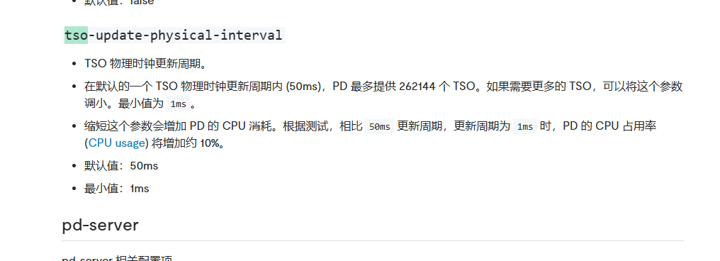

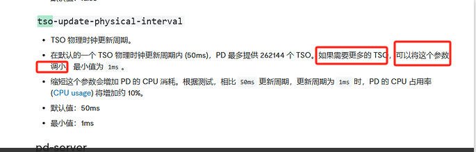

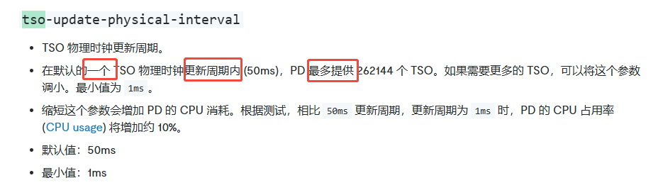

官方文档如下:
描述中说减小tso-update-physical-interval 可以获取超过262144个tso,但是从代码中来看如果超过了262144时会一直失败,代码如下:
tso/tso.go line 354 fn:func (t *timestampOracle) getTS(ctx context.Context, count uint32) (pdpb.Timestamp, error)
if resp.GetLogical() >= maxLogical {
log.Warn("logical part outside of max logical interval, please check ntp time, or adjust config item `tso-update-physical-interval`",
logutil.CondUint32("keyspace-group-id", t.keyspaceGroupID, t.keyspaceGroupID > 0),
zap.Reflect("response", resp),
zap.Int("retry-count", i), errs.ZapError(errs.ErrLogicOverflow))
t.metrics.logicalOverflowEvent.Inc()
time.Sleep(t.updatePhysicalInterval)
continue
// In case lease expired after the first check.
if !t.member.IsLeader() {
return pdpb.Timestamp{}, errs.ErrGenerateTimestamp.FastGenByArgs(fmt.Sprintf("requested %s anymore", errs.NotLeaderErr))
return resp, nil
如果超过了1 << 18个tso resp.GetLogical() >= maxLogical 总是会失败,所以无论tso刷新时间是多少,获取总会失败,有大佬看看这个是个bug吗
