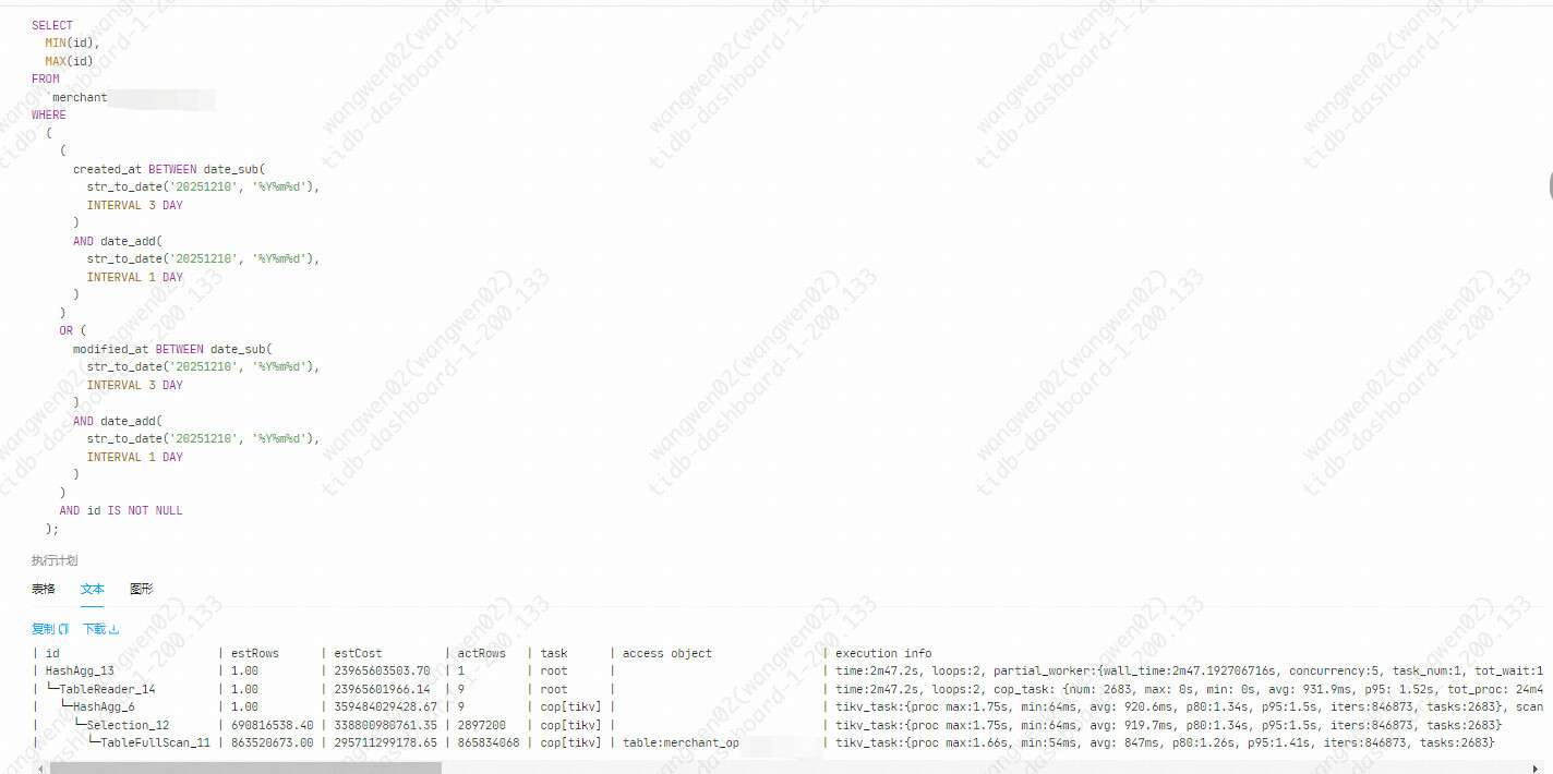

v7.5.7版本集群查询语句包含or id is not null等条件走全表扫描
【TiDB 使用环境】生产环境
【TiDB 版本】v7.5.7
研发存在抽数业务,需要先获取id的最大值和最小值。由于抽数平台限制,默认所有的SQL都会自带id is not null条件。
表中存在相关索引 KEY idx_created_at (created_at), KEY idx_modified_at (modified_at)
如果把id is not null去掉,可以用到created_at和modified_at索引。
如果把or去掉,modified_at 或created_at去掉一个,也可以走正常的索引。
对于现有SQL,如何调整可以命中时间索引,而不是走全表扫描。
| id                       | estRows      | estCost         | actRows   | task      | access object                | execution info                                                                                                                                                                                                                                                                                                                                                                                                 | operator info                                                                                                                                                                                                                                                                                      | memory    | disk  |
| HashAgg_13               | 1.00         | 23965603503.70  | 1         | root      |                              | time:2m47.2s, loops:2, partial_worker:{wall_time:2m47.192706716s, concurrency:5, task_num:1, tot_wait:13m55.963418873s, tot_exec:3.839µs, tot_time:13m55.963427182s, max:2m47.19268925s, p95:2m47.19268925s}, final_worker:{wall_time:2m47.192733223s, concurrency:5, task_num:1, tot_wait:13m55.963523287s, tot_exec:16.025µs, tot_time:13m55.963541185s, max:2m47.192715165s, p95:2m47.192715165s}           | funcs:min(Column#20)->Column#18, funcs:max(Column#21)->Column#19                                                                                                                                                                                                                                   | 13.6 KB   | N/A   |
| └─TableReader_14         | 1.00         | 23965601966.14  | 9         | root      |                              | time:2m47.2s, loops:2, cop_task: {num: 2683, max: 0s, min: 0s, avg: 931.9ms, p95: 1.52s, tot_proc: 24m43.6s, tot_wait: 16.6s, copr_cache_hit_ratio: 0.00, build_task_duration: 25.4ms, max_distsql_concurrency: 15}, rpc_info:{Cop:{num_rpc:2683, total_time:41m40.2s}}                                                                                                                                        | data:HashAgg_6                                                                                                                                                                                                                                                                                     | 475 Bytes | N/A   |
|   └─HashAgg_6            | 1.00         | 359484029428.67 | 9         | cop[tikv] |                              | tikv_task:{proc max:1.75s, min:64ms, avg: 920.6ms, p80:1.34s, p95:1.5s, iters:846873, tasks:2683}, scan_detail: {total_process_keys: 865834068, total_process_keys_size: 210525438840, total_keys: 865836826, get_snapshot_time: 15.5s, rocksdb: {delete_skipped_count: 30161072, key_skipped_count: 982776463, block: {cache_hit_count: 36361, read_count: 6941199, read_byte: 19.6 GB, read_time: 1m59.8s}}} | funcs:min(dw_merchant_log.merchant_operation_log.id)->Column#20, funcs:max(dw_merchant_log.merchant_operation_log.id)->Column#21                                                                                                                                                                   | N/A       | N/A   |
|     └─Selection_12       | 690816538.40 | 338800980761.35 | 2897200   | cop[tikv] |                              | tikv_task:{proc max:1.75s, min:64ms, avg: 919.7ms, p80:1.34s, p95:1.5s, iters:846873, tasks:2683}                                                                                                                                                                                                                                                                                                              | or(and(ge(dw_merchant_log.merchant_operation_log.created_at, 2025-12-07), le(dw_merchant_log.merchant_operation_log.created_at, 2025-12-11)), and(ge(dw_merchant_log.merchant_operation_log.modified_at, 2025-12-07), and(le(dw_merchant_log.merchant_operation_log.modified_at, 2025-12-11), 1))) | N/A       | N/A   |
|       └─TableFullScan_11 | 863520673.00 | 295711299178.65 | 865834068 | cop[tikv] | table:merchant_operation_log | tikv_task:{proc max:1.66s, min:54ms, avg: 847ms, p80:1.26s, p95:1.41s, iters:846873, tasks:2683}                                                                                                                                                                                                                                                                                                               | keep order:false                                                                                                                                                                                                                                                                                   | N/A       | N/A   |

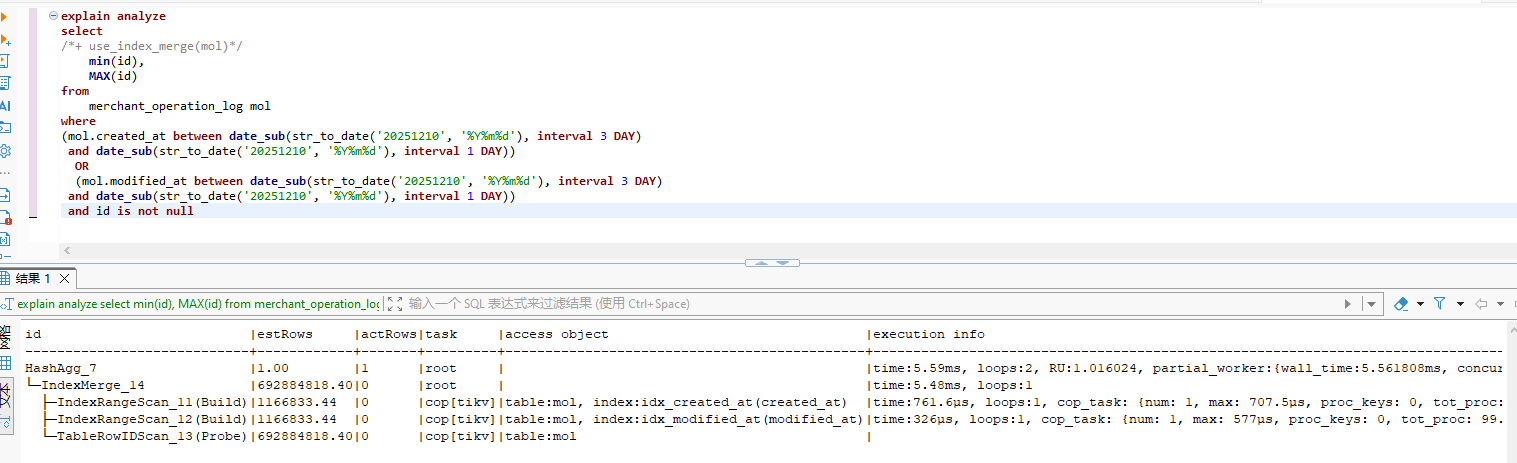

测试结果:

可以看到 hint 的时候:
Warning | 1105 | IndexMerge is inapplicable
优化器认为这个查询不适用 Index Merge
-- 括号内的 AND id IS NOT NULL
or(
  and(ge(...created_at...), le(...created_at...)),
  and(ge(...modified_at...), and(le(...modified_at...), 1))  -- 注意这里多了 and(..., 1)
这里的 and(..., 1) 实际上是 id IS NOT NULL 的谓词表达式(因为 id IS NOT NULL 总是为真,被转换为常量 1)。
Index Merge 不生效的根本原因是:
原因 说明
运算符优先级 括号内的 AND id IS NOT NULL 只绑定到 modified_at 条件
非对称的 OR 分支 左分支和右分支的过滤逻辑不一致
破坏 Index Merge 模型 Index Merge 要求各分支独立且对称,不能有分支特定的额外过滤
优化器判断不适用 Warning “IndexMerge is inapplicable” 明确说明无法使用

attached_condition 内容里面可以看到,id is not null 已经消除了(id 是主键,这个条件为 true)。

| Note    | 1105 | [merchant_operation_log,idx_created_at,idx_modified_at] remain after pruning paths for merchant_operation_log given Prop{SortItems: [], TaskTp: rootTask}          |
6 rows in set (0.00 sec)
想到一个 workround:
"where": "((created_at BETWEEN '2025-12-07' AND '2025-12-11') OR (modified_at BETWEEN '2025-12-07' AND '2025-12-11'))",
如果写的配置文件,还可以将条件多加个小括号解决。
explain format="verbose"
 SELECT
   MIN(id),
   MAX(id)
 FROM
   `merchant_operation_log`
 WHERE
       created_at BETWEEN date_sub(
         str_to_date('20251210', '%Y%m%d'),
         INTERVAL 3 DAY
       AND date_add(
         INTERVAL 1 DAY
     OR (
       modified_at BETWEEN date_sub(
         INTERVAL 3 DAY
       AND date_add(
         INTERVAL 1 DAY
     AND id IS NOT NULL
| id                               | estRows    | estCost       | task      | access object                                                    | operator info                                                                                                                    |
| HashAgg_7                        | 1.00       | 438273598.97  | root      |                                                                  | funcs:min(dw_merchant_log.merchant_operation_log.id)->Column#18, funcs:max(dw_merchant_log.merchant_operation_log.id)->Column#19 |
| └─IndexMerge_18                  | 5009732.80 | 288280691.26  | root      |                                                                  | type: union                                                                                                                      |
|   ├─IndexRangeScan_15(Build)     | 2508499.08 | 510479562.45  | cop[tikv] | table:merchant_operation_log, index:idx_created_at(created_at)   | range:[2025-12-07 00:00:00,2025-12-11 00:00:00], keep order:false                                                                |
|   ├─IndexRangeScan_16(Build)     | 2508499.08 | 510479562.45  | cop[tikv] | table:merchant_operation_log, index:idx_modified_at(modified_at) | range:[2025-12-07 00:00:00,2025-12-11 00:00:00], keep order:false                                                                |
|   └─TableRowIDScan_17(Probe)     | 5009732.80 | 1715247226.60 | cop[tikv] | table:merchant_operation_log                                     | keep order:false                                                                                                                 |
5 rows in set, 5 warnings (0.00 sec)
update 下 tidb index merge 失效原因:
对 tidb 来说原 query where 条件是 A or B and C 这种结构。IndexMerge 要么只能做 And, 要么只能做 OR, 是不能同时做 and 和 or 的。所以才导致了这个问题。
和对不对称关系不大
给 SQL 条件加外层括号统一绑定 id 条件,让 IndexMerge 生效,避开全表扫描
可以试试外层加括号
1、尝试给条件加外层括号统一绑定 id
2、 IndexMerge 生效一下,避开全表扫描
