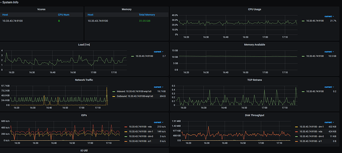

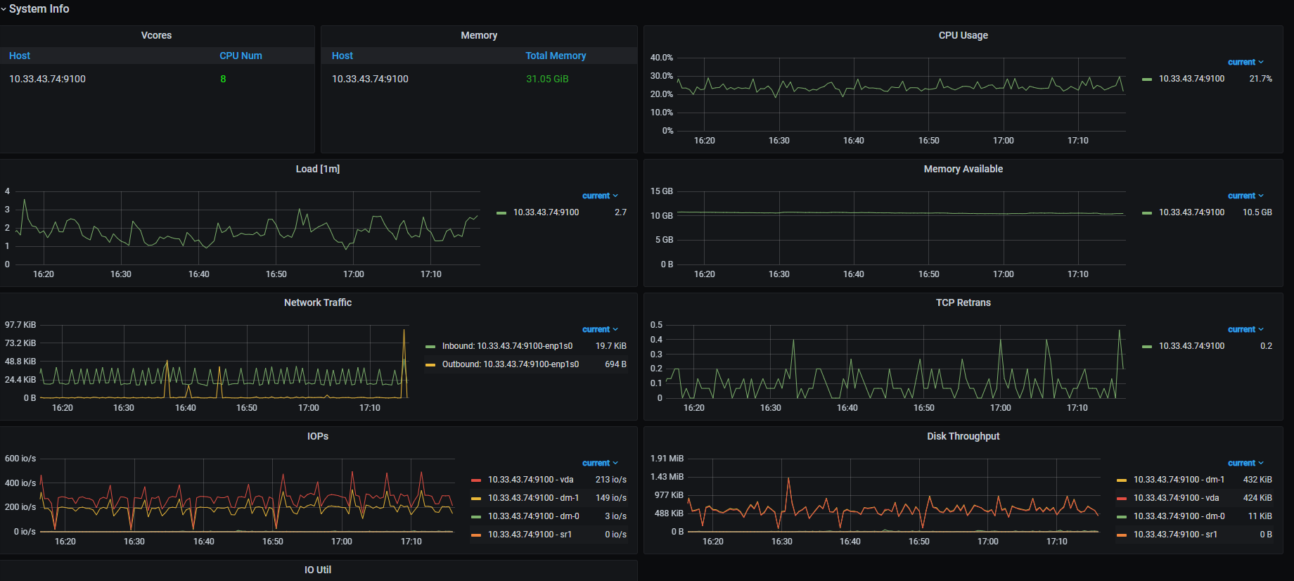

从库时间一致、有主键,资源占用情况如何?
[2025/12/25 16:59:18.176 +08:00] [INFO] [schema_store.go:134] [“handle a ddl job”] [schemaID=304] [schemaName=test] [tableID=306] [tableName=addr_info] [type=“drop table”] [DDL=“/* ApplicationName=DBeaver 6.2.0 - Main */ drop table addr_info”] [schemaVersion=2259] [jobFinishTs=463117525381808136] [storeSchemaVersion=2256] [storeFinishedDDLTS=463075052547211278]
[2025/12/25 16:59:18.200 +08:00] [INFO] [utils.go:78] [“transform ddl query to result”] [charset=] [collate=] [result=“DROP TABLE addr_info”]

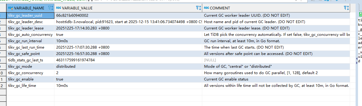

[2025/12/25 17:03:10.328 +08:00] [INFO] [persist_storage.go:621] [“gc is disabled”] [gcTs=463117339928035328]
gc明明是开启的,为啥会报gc不可用。
资源是空闲的
