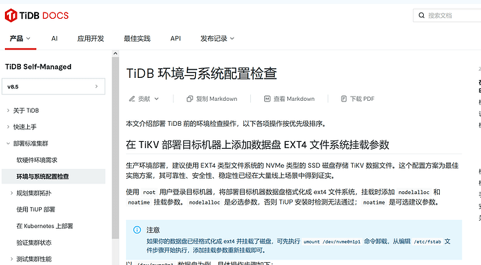

如下链接是安装前的环境准备,只需要按照官方要求调整下系统参数即可:https://docs.pingcap.com/zh/tidb/stable/check-before-deployment/
https://docs.pingcap.com/zh/tidb/stable/check-before-deployment/ 按照推荐手册
