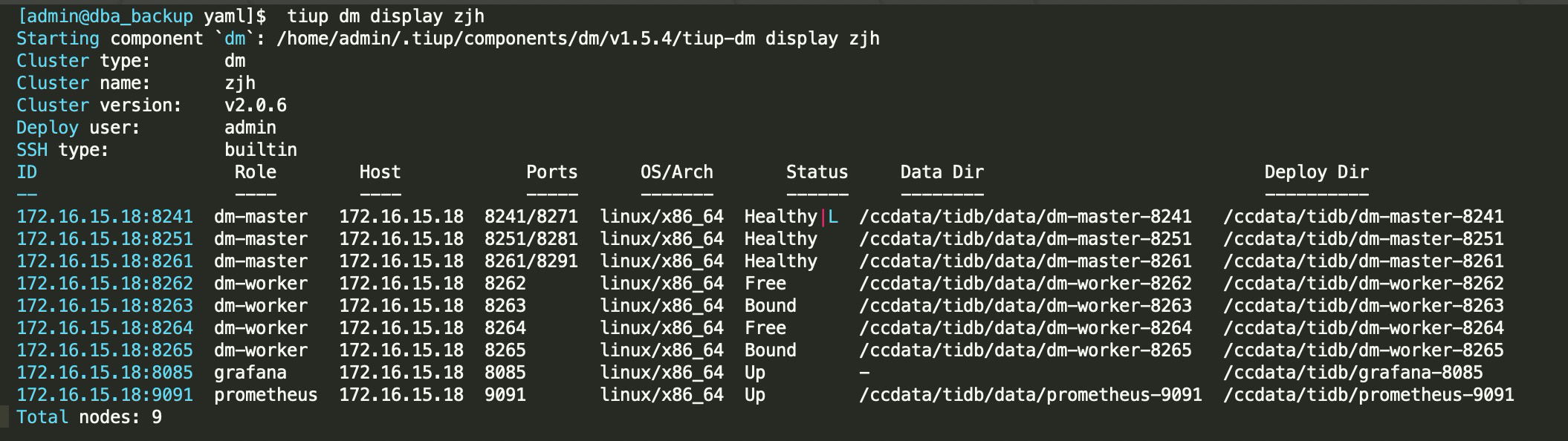

【环境】
DM v2.0.6
TiDB v4.0.13
dm部署情况:
【操作】

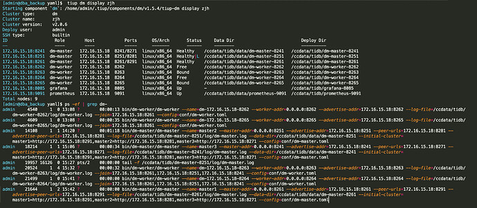

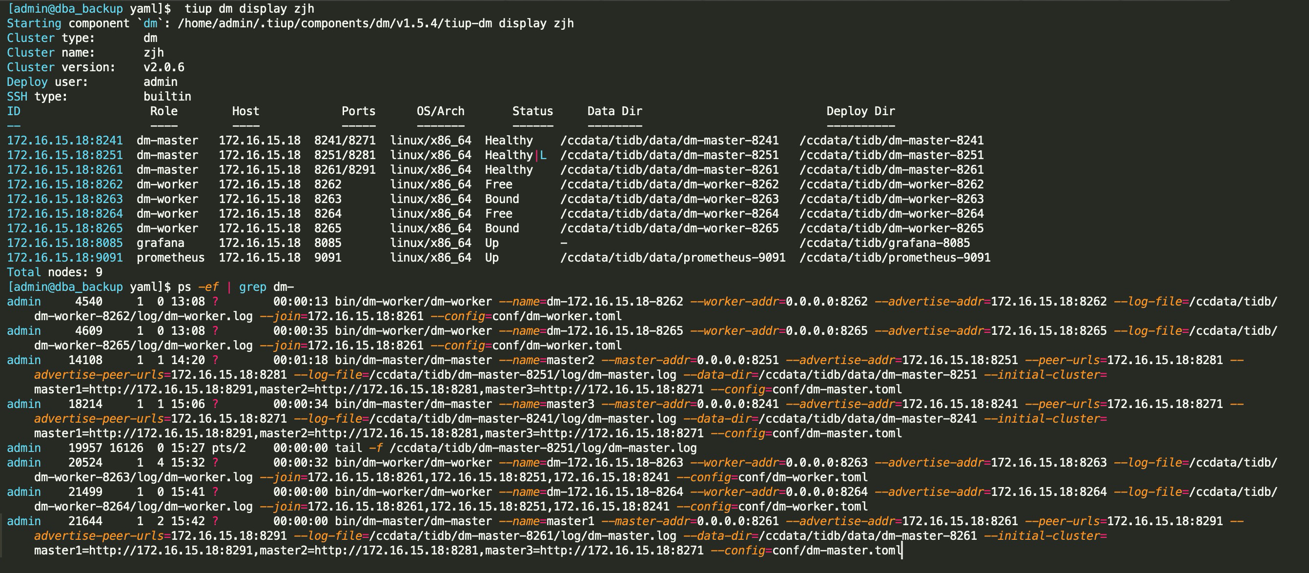

模拟dm-master和dm-worker同时宕机
命令如下:
kill -9 14108; kill -9 20524; mv /ccdata/tidb/dm-master-8251 /ccdata/tidb/dm-master-8251-1; mv /ccdata/tidb/dm-worker-8263 /ccdata/tidb/dm-worker-8263-1

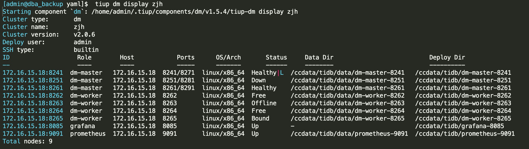

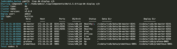

切换后集群状态:
dm-worker-8263上的同步任务一直未转移到其他空闲的dm-worker上,报错如下:
[2021/08/16 15:58:50.745 +08:00] [WARN] [grpclog.go:60] [“grpc: addrConn.createTransport failed to connect to {172.16.15.18:8263 0 }. Err :connection error: desc = "transport: Error wh ile dialing dial tcp 172.16.15.18:8263: connect: connection refused". Reconnecting…”][component=“embed etcd”]
具体日志:dm_master.log (237.2 KB)

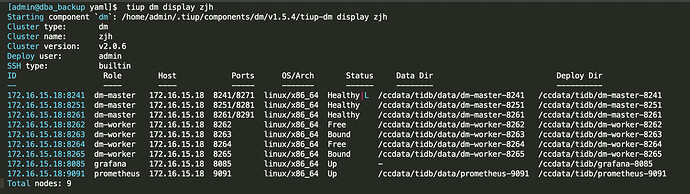

在dm-worker-8263重新启动之后,同步任务才恢复:
