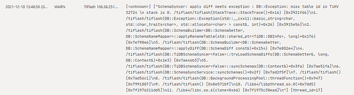

http://pd:2479/dashboard/#/search_logs/detail?id=14 找到相关错误日志:
[“SchemaSyncer: apply diff meets exception : DB::Exception: miss table id in TiKV 32724 \ stack is 0. /tiflash/tiflash(StackTrace::StackTrace()+0x16) [0x3921fd6]\ 1. /tiflash/tiflash(DB::Exception::Exception(std::__cxx11::basic_string<char, std::char_traits, std::allocator > const&, int)+0x26) [0x3915e56]\ 2. /tiflash/tiflash(DB::SchemaBuilder<DB::SchemaGetter, DB::SchemaNameMapper>::applyRenameTable(std::shared_ptrTiDB::DBInfo, long)+0x176) [0x7e798e6]\ 3. /tiflash/tiflash(DB::SchemaBuilder<DB::SchemaGetter, DB::SchemaNameMapper>::applyDiff(DB::SchemaDiff const&)+0x154) [0x7e802e4]\ 4. /tiflash/tiflash(DB::TiDBSchemaSyncer::tryLoadSchemaDiffs(DB::SchemaGetter&, long, DB::Context&)+0x1e3) [0x7ae46b3]\ 5. /tiflash/tiflash(DB::TiDBSchemaSyncer::syncSchemas(DB::Context&)+0x3fa) [0x7ae51fa]\ 6. /tiflash/tiflash(DB::SchemaSyncService::syncSchemas()+0x2f) [0x7ad2f5f]\ 7. /tiflash/tiflash() [0x7ad56c1]\ 8. /tiflash/tiflash(DB::BackgroundProcessingPool::threadFunction()+0x947) [0x7991807]\ 9. /tiflash/tiflash() [0x8e571bf]\ 10. /lib64/libpthread.so.0(+0x7dd5) [0x7f1976211dd5]\ 11. /lib64/libc.so.6(clone+0x6d) [0x7f1975c38ead]\ ”] [thread_id=17]

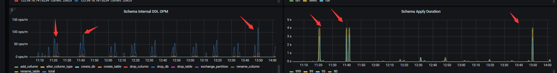

看截图, 三个箭头 是报警时间和监控图 对应
ddl 在第一个图 给出了, 就是 频繁的rename表

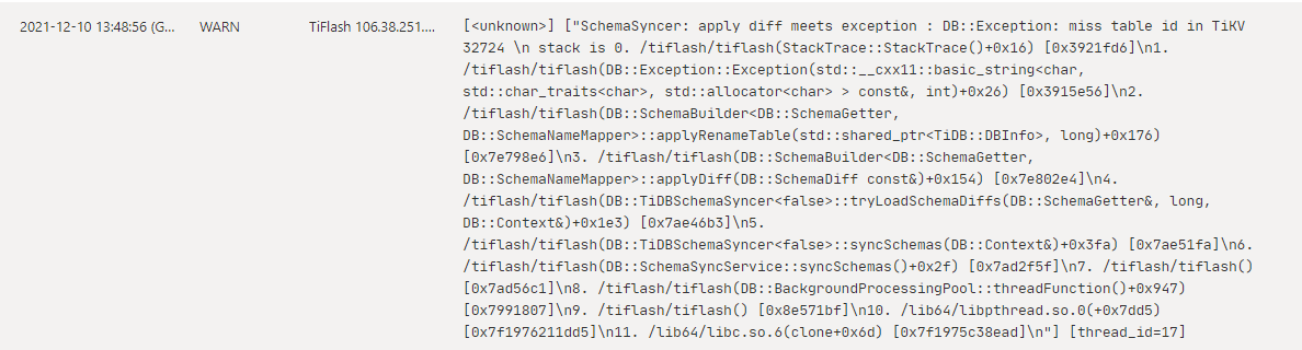

补充一个tiflash节点 日志
tiflash-server.log (6.4 MB)

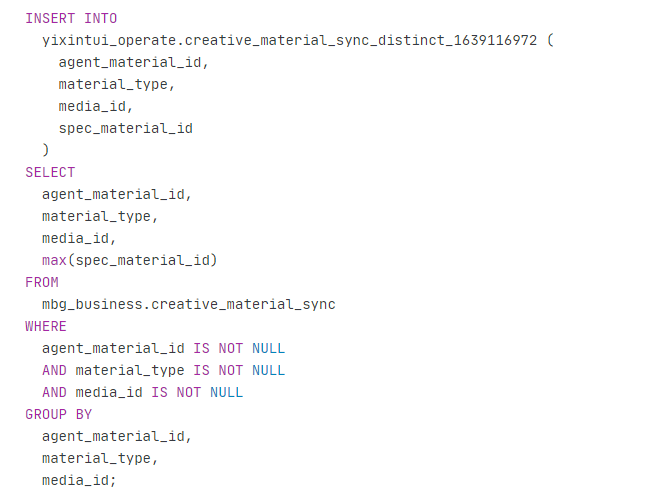

这是创建表的SQL
