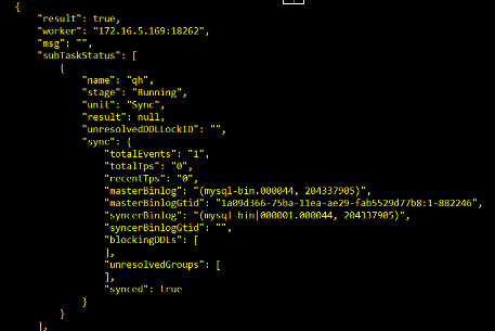

  • 解决本问题的基本思路就是统一上下游表结构,目前测试通过以下步骤可恢复同步:
  1. stop-task qh
  2. 下游 tidb 创建新的表解决 t_new
CREATE TABLE t_new (id INT (11) NOT NULL,name VARCHAR (20) DEFAULT NULL,time datetime DEFAULT NULL,new_column INT (11) DEFAULT NULL,PRIMARY KEY (id),KEY idx_new (new_column)) ENGINE=INNODB DEFAULT CHARSET=utf8mb4;
  1. 将旧数据导入新表结构中:
insert into t_new select * from t;
  1. 交换表名
alter table t rename to t_lod;
alter table t_new rename to t;
  1. start-task ./conf/a.yaml
  • 效果如下:
