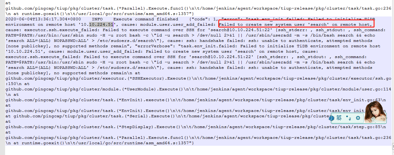

tiup deploy 执行报错,创建部署用户 search 失败
{“code”: 1, “error”: “task.env_init.failed: Failed to initialize TiDB environment on remote host ‘10.10.224.51’, cause: module.user.user_add_failed: Failed to create new system user ‘search’ on remote host, cause: executor.ssh.execute_failed: Failed to execute com mand over SSH for ‘search@10.10.224.51:22’ {ssh_stderr: , ssh_stdout: , ssh_command: PATH=$PATH:/usr/bin:/usr/sbin sudo -H -u root bash -c “id -u search > /dev/null 2> &1 || /usr/sbin/useradd -m -s /bin/bash search && echo ‘search ALL=(ALL) NOPASSWD:ALL’ > /etc/sudoers.d/search”}, cause: ssh: handshake failed: ssh: unable to authenti cate, attempted methods [none publickey], no supported methods remain”, “errorVerbose”: “task.env_init.failed: Failed to initialize TiDB environment on remote host ‘10. 10.224.51’, cause: module.user.user_add_failed: Failed to create new system user ‘search’ on remote host, cause: executor.ssh.execute_failed: Failed to execute command over SSH for ‘search@10.10.224.51:22’ {ssh_stderr: , ssh_stdout: , ssh_command: PATH=$PATH:/usr/bin:/usr/sbin sudo -H -u root bash -c “id -u search > /dev/null 2>&1 || /usr/sbin/useradd -m -s /bin/bash search && echo ‘search ALL=(ALL) NOPASSWD:ALL’ > /etc/sudoers.d/search”}, cause: ssh: handshake failed: ssh: unable to authenticate, attempted methods [none publickey], no supported methods remain\ at github.com/pingcap/tiup/pkg/cluster/executor.(*SSHExecutor).Execute()\ \t/home/jenkins/agent/works pace/tiup-release/pkg/cluster/executor/ssh.go:150\ at github.com/pingcap/tiup/pkg/cluster/module.(*UserModule).Execute()\ \t/home/jenkins/agent/workspace/tiup-release/ pkg/cluster/module/user.go:114\ at github.com/pingcap/tiup/pkg/cluster/task.(*EnvInit).execute()\ \t/home/jenkins/agent/workspace/tiup-release/pkg/cluster/task/env_ini t.go:63\ at github.com/pingcap/tiup/pkg/cluster/task.(*EnvInit).Execute()\ \t/home/jenkins/agent/workspace/tiup-release/pkg/cluster/task/env_init.go:44\ at github.com /pingcap/tiup/pkg/cluster/task.(*Serial).Execute()\ \t/home/jenkins/agent/workspace/tiup-release/pkg/cluster/task/task.go:183\ at github.com/pingcap/tiup/pkg/cluster/t ask.(*StepDisplay).Execute()\ \t/home/jenkins/agent/workspace/tiup-release/pkg/cluster/task/step.go:85\ at github.com/pingcap/tiup/pkg/cluster/task.(*Parallel).Execute .func1()\ \t/home/jenkins/agent/workspace/tiup-release/pkg/cluster/task/task.go:236\ at runtime.goexit()\ \t/usr/local/go/src/runtime/asm_amd64.s:1357”}

已截图!唯一的区别在于 我是直接用search用户登陆的crt。 用root登陆,在切换到search,再ssh是不行的
发下 debug 日志吧。。看下具体执行 deploy 语句是什么
tiup-cluster-debug-2020-06-04-13-36-17.log (82.0 KB)

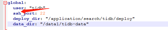

topology.yaml (5.2 KB)

topo 文件中显示运维用户为 tidb,与报错信息不符,可以注意下。
您好,这个是我备份版本。服务器上的 我已经修改为search了
