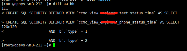

这两个视图基本上是一样的,如下,我们通过diff的对比
两个 视图的定义如下:
CREATE ALGORITHM=UNDEFINED SQL SECURITY DEFINER VIEW ccmc_view_tables_text_status_time AS select saas_cube_xyzphp.tables.code AS tables_code,saas_cube_xyzphp.tables.name AS name,saas_cube_xyzphp.tables.avatar AS avatar,reception.serving_user_num AS chat_busy,saas_cube_xyzphp.tables.chat_limit AS chat_limit,saas_cube_xyzphp.tables.queue_limit AS queue_limit,saas_cube_xyzphp.tables_infos.job_position AS job_position,tables_groups.name AS group_name,tables_status_time.now_status AS now_status,tables_status_time.now_keep_time AS now_keep_time,tables_status_time.online_time AS online_time,tables_status_time.offline_time AS offline_time,tables_status_time.hangup_time AS hangup_time,tables_status_time.acw_time AS acw_time,tables_status_time.acw_num AS acw_num,tables_status_time.callin_acw_time AS callin_acw_time,tables_status_time.callin_acw_num AS callin_acw_num,tables_status_time.callout_acw_time AS callout_acw_time,tables_status_time.callout_acw_num AS callout_acw_num,tables_status_time.hold_time AS hold_time,tables_status_time.rest_time AS rest_time,tables_status_time.rest_num AS rest_num,round((tables_status_time.rest_time / tables_status_time.login_time),4) AS rest_rate,tables_status_time.call_time AS call_time,tables_status_time.callin_time AS callin_time,tables_status_time.callout_time AS callout_time,tables_status_time.login_time AS login_time,tables_status_time.now_at AS now_at,tables_status_time.first_login_at AS first_login_at,tables_status_time.first_logout_at AS first_logout_at,tables_status_time.last_logout_at AS last_logout_at,tables_status_time.first_offline_at AS first_offline_at,tables_status_time.last_offline_at AS last_offline_at from ((((saas_cube_xyzphp.tables left join (select b.tables_code AS tables_code,(select a.current_status from saas_cube_xyzphp.tables_statuses a where (a.id = max(b.id))) AS now_status,(unix_timestamp(now()) - unix_timestamp(max(b.created_at))) AS now_keep_time,sum(if((b.current_status = ‘online’),if(isnull(b.continuous_time),(unix_timestamp(now()) - unix_timestamp(b.created_at)),b.continuous_time),0)) AS online_time,sum(if((b.current_status = ‘offline’),if(isnull(b.continuous_time),(unix_timestamp(now()) - unix_timestamp(b.created_at)),b.continuous_time),0)) AS offline_time,sum(if((b.current_status = ‘hangup’),if(isnull(b.continuous_time),(unix_timestamp(now()) - unix_timestamp(b.created_at)),b.continuous_time),0)) AS hangup_time,sum(if((b.current_status = ‘acw’),if(isnull(b.continuous_time),(unix_timestamp(now()) - unix_timestamp(b.created_at)),b.continuous_time),0)) AS acw_time,count(if((b.current_status = ‘acw’),TRUE,NULL)) AS acw_num,sum(if(((b.current_status = ‘acw’) and (b.last_status = ‘callin’)),if(isnull(b.continuous_time),(unix_timestamp(now()) - unix_timestamp(b.created_at)),b.continuous_time),0)) AS callin_acw_time,count(if(((b.current_status = ‘acw’) and (b.last_status = ‘callin’)),TRUE,NULL)) AS callin_acw_num,sum(if(((b.current_status = ‘acw’) and (b.last_status = ‘callout’)),if(isnull(b.continuous_time),(unix_timestamp(now()) - unix_timestamp(b.created_at)),b.continuous_time),0)) AS callout_acw_time,count(if(((b.current_status = ‘acw’) and (b.last_status = ‘callout’)),TRUE,NULL)) AS callout_acw_num,sum(if((b.current_status = ‘hold’),if(isnull(b.continuous_time),(unix_timestamp(now()) - unix_timestamp(b.created_at)),b.continuous_time),0)) AS hold_time,sum(if((b.current_status = ‘rest’),if(isnull(b.continuous_time),(unix_timestamp(now()) - unix_timestamp(b.created_at)),b.continuous_time),0)) AS rest_time,count(if((b.current_status = ‘rest’),TRUE,NULL)) AS rest_num,sum(if(((b.current_status = ‘callout’) or (b.current_status = ‘callin’)),if(isnull(b.continuous_time),(unix_timestamp(now()) - unix_timestamp(b.created_at)),b.continuous_time),0)) AS call_time,sum(if((b.current_status = ‘callin’),if(isnull(b.continuous_time),(unix_timestamp(now()) - unix_timestamp(b.created_at)),b.continuous_time),0)) AS callin_time,sum(if((b.current_status = ‘callout’),if(isnull(b.continuous_time),(unix_timestamp(now()) - unix_timestamp(b.created_at)),b.continuous_time),0)) AS callout_time,sum(if(((b.current_status = ‘online’) or (b.current_status = ‘acw’) or (b.current_status = ‘hold’) or (b.current_status = ‘hangup’) or (b.current_status = ‘rest’) or (b.current_status = ‘callout’) or (b.current_status = ‘callin’) or (b.current_status = ‘offline’)),if(isnull(b.continuous_time),(unix_timestamp(now()) - unix_timestamp(b.created_at)),b.continuous_time),0)) AS login_time,now() AS now_at,min(if((b.current_status = ‘login’),b.created_at,NULL)) AS first_login_at,min(if((b.current_status = ‘logout’),b.created_at,NULL)) AS first_logout_at,max(if((b.current_status = ‘logout’),b.created_at,NULL)) AS last_logout_at,min(if((b.current_status = ‘offline’),b.created_at,NULL)) AS first_offline_at,max(if((b.current_status = ‘offline’),b.created_at,NULL)) AS last_offline_at from saas_cube_xyzphp.tables_statuses b where ((b.created_at > if((curtime() < ‘09:00:00’),date_format((curdate() - interval 1 day),‘%Y-%m-%d 18:00:00’),date_format(curdate(),‘%Y-%m-%d 00:00:00’))) and (b.created_at < if((curtime() < ‘09:00:00’),date_format(curdate(),‘%Y-%m-%d 09:00:00’),date_format((curdate() + interval 1 day),‘%Y-%m-%d 00:00:00’))) and (b.type = 1)) group by b.tables_code) tables_status_time on((tables_status_time.tables_code = saas_cube_xyzphp.tables.code))) left join (select saas_cube_xyzphp.tables_reception_states.serving_user_num AS serving_user_num,saas_cube_xyzphp.tables_reception_states.tables_code AS tables_code from saas_cube_xyzphp.tables_reception_states where ((saas_cube_xyzphp.tables_reception_states.created_at > date_format(curdate(),‘%Y-%m-%d 00:00:00’)) and (saas_cube_xyzphp.tables_reception_states.created_at <= date_format(curdate(),‘%Y-%m-%d 23:59:59’)))) reception on((reception.tables_code = saas_cube_xyzphp.tables.code))) left join saas_cube_xyzphp.tables_infos on((saas_cube_xyzphp.tables_infos.code = saas_cube_xyzphp.tables.code))) left join (select saas_cube_xyzphp.tables_group.code AS code,saas_cube_xyzphp.groups.id AS id,saas_cube_xyzphp.groups.name AS name from (saas_cube_xyzphp.tables_group left join saas_cube_xyzphp.groups on((saas_cube_xyzphp.groups.id = saas_cube_xyzphp.tables_group.group_id)))) tables_groups on((tables_groups.code = saas_cube_xyzphp.tables.code)))
这个成功了
CREATE ALGORITHM=UNDEFINED SQL SECURITY DEFINER VIEW ccmc_view_tables_phone_status_time AS select saas_cube_xyzphp.tables.code AS tables_code,saas_cube_xyzphp.tables.name AS name,saas_cube_xyzphp.tables.avatar AS avatar,reception.serving_user_num AS chat_busy,saas_cube_xyzphp.tables.chat_limit AS chat_limit,saas_cube_xyzphp.tables.queue_limit AS queue_limit,saas_cube_xyzphp.tables_infos.job_position AS job_position,tables_groups.name AS group_name,tables_status_time.now_status AS now_status,tables_status_time.now_keep_time AS now_keep_time,tables_status_time.online_time AS online_time,tables_status_time.offline_time AS offline_time,tables_status_time.hangup_time AS hangup_time,tables_status_time.acw_time AS acw_time,tables_status_time.acw_num AS acw_num,tables_status_time.callin_acw_time AS callin_acw_time,tables_status_time.callin_acw_num AS callin_acw_num,tables_status_time.callout_acw_time AS callout_acw_time,tables_status_time.callout_acw_num AS callout_acw_num,tables_status_time.hold_time AS hold_time,tables_status_time.rest_time AS rest_time,tables_status_time.rest_num AS rest_num,round((tables_status_time.rest_time / tables_status_time.login_time),4) AS rest_rate,tables_status_time.call_time AS call_time,tables_status_time.callin_time AS callin_time,tables_status_time.callout_time AS callout_time,tables_status_time.login_time AS login_time,tables_status_time.now_at AS now_at,tables_status_time.first_login_at AS first_login_at,tables_status_time.first_logout_at AS first_logout_at,tables_status_time.last_logout_at AS last_logout_at,tables_status_time.first_offline_at AS first_offline_at,tables_status_time.last_offline_at AS last_offline_at from ((((saas_cube_xyzphp.tables left join (select b.tables_code AS tables_code,(select a.current_status from saas_cube_xyzphp.tables_statuses a where (a.id = max(b.id))) AS now_status,(unix_timestamp(now()) - unix_timestamp(max(b.created_at))) AS now_keep_time,sum(if((b.current_status = ‘online’),if(isnull(b.continuous_time),(unix_timestamp(now()) - unix_timestamp(b.created_at)),b.continuous_time),0)) AS online_time,sum(if((b.current_status = ‘offline’),if(isnull(b.continuous_time),(unix_timestamp(now()) - unix_timestamp(b.created_at)),b.continuous_time),0)) AS offline_time,sum(if((b.current_status = ‘hangup’),if(isnull(b.continuous_time),(unix_timestamp(now()) - unix_timestamp(b.created_at)),b.continuous_time),0)) AS hangup_time,sum(if((b.current_status = ‘acw’),if(isnull(b.continuous_time),(unix_timestamp(now()) - unix_timestamp(b.created_at)),b.continuous_time),0)) AS acw_time,count(if((b.current_status = ‘acw’),TRUE,NULL)) AS acw_num,sum(if(((b.current_status = ‘acw’) and (b.last_status = ‘callin’)),if(isnull(b.continuous_time),(unix_timestamp(now()) - unix_timestamp(b.created_at)),b.continuous_time),0)) AS callin_acw_time,count(if(((b.current_status = ‘acw’) and (b.last_status = ‘callin’)),TRUE,NULL)) AS callin_acw_num,sum(if(((b.current_status = ‘acw’) and (b.last_status = ‘callout’)),if(isnull(b.continuous_time),(unix_timestamp(now()) - unix_timestamp(b.created_at)),b.continuous_time),0)) AS callout_acw_time,count(if(((b.current_status = ‘acw’) and (b.last_status = ‘callout’)),TRUE,NULL)) AS callout_acw_num,sum(if((b.current_status = ‘hold’),if(isnull(b.continuous_time),(unix_timestamp(now()) - unix_timestamp(b.created_at)),b.continuous_time),0)) AS hold_time,sum(if((b.current_status = ‘rest’),if(isnull(b.continuous_time),(unix_timestamp(now()) - unix_timestamp(b.created_at)),b.continuous_time),0)) AS rest_time,count(if((b.current_status = ‘rest’),TRUE,NULL)) AS rest_num,sum(if(((b.current_status = ‘callout’) or (b.current_status = ‘callin’)),if(isnull(b.continuous_time),(unix_timestamp(now()) - unix_timestamp(b.created_at)),b.continuous_time),0)) AS call_time,sum(if((b.current_status = ‘callin’),if(isnull(b.continuous_time),(unix_timestamp(now()) - unix_timestamp(b.created_at)),b.continuous_time),0)) AS callin_time,sum(if((b.current_status = ‘callout’),if(isnull(b.continuous_time),(unix_timestamp(now()) - unix_timestamp(b.created_at)),b.continuous_time),0)) AS callout_time,sum(if(((b.current_status = ‘online’) or (b.current_status = ‘acw’) or (b.current_status = ‘hold’) or (b.current_status = ‘hangup’) or (b.current_status = ‘rest’) or (b.current_status = ‘callout’) or (b.current_status = ‘callin’) or (b.current_status = ‘offline’)),if(isnull(b.continuous_time),(unix_timestamp(now()) - unix_timestamp(b.created_at)),b.continuous_time),0)) AS login_time,now() AS now_at,min(if((b.current_status = ‘login’),b.created_at,NULL)) AS first_login_at,min(if((b.current_status = ‘logout’),b.created_at,NULL)) AS first_logout_at,max(if((b.current_status = ‘logout’),b.created_at,NULL)) AS last_logout_at,min(if((b.current_status = ‘offline’),b.created_at,NULL)) AS first_offline_at,max(if((b.current_status = ‘offline’),b.created_at,NULL)) AS last_offline_at from saas_cube_xyzphp.tables_statuses b where ((b.created_at > if((curtime() < ‘09:00:00’),date_format((curdate() - interval 1 day),‘%Y-%m-%d 18:00:00’),date_format(curdate(),‘%Y-%m-%d 00:00:00’))) and (b.created_at < if((curtime() < ‘09:00:00’),date_format(curdate(),‘%Y-%m-%d 09:00:00’),date_format((curdate() + interval 1 day),‘%Y-%m-%d 00:00:00’))) and (b.type = 2)) group by b.tables_code) tables_status_time on((tables_status_time.tables_code = saas_cube_xyzphp.tables.code))) left join (select saas_cube_xyzphp.tables_reception_states.serving_user_num AS serving_user_num,saas_cube_xyzphp.tables_reception_states.tables_code AS tables_code from saas_cube_xyzphp.tables_reception_states where ((saas_cube_xyzphp.tables_reception_states.created_at > date_format(curdate(),‘%Y-%m-%d 00:00:00’)) and (saas_cube_xyzphp.tables_reception_states.created_at <= date_format(curdate(),‘%Y-%m-%d 23:59:59’)))) reception on((reception.tables_code = saas_cube_xyzphp.tables.code))) left join saas_cube_xyzphp.tables_infos on((saas_cube_xyzphp.tables_infos.code = saas_cube_xyzphp.tables.code))) left join (select saas_cube_xyzphp.tables_group.code AS code,saas_cube_xyzphp.groups.id AS id,saas_cube_xyzphp.groups.name AS name from (saas_cube_xyzphp.tables_group left join saas_cube_xyzphp.groups on((saas_cube_xyzphp.groups.id = saas_cube_xyzphp.tables_group.group_id)))) tables_groups on((tables_groups.code = saas_cube_xyzphp.tables.code)))
这个不成功

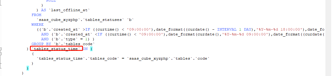

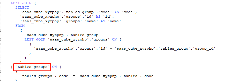

tables_groups这是一个别名,如下:
tables_status_time也是一个别名,如下:
