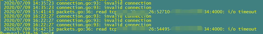

dm_worker 中异常报错 i/o timeout

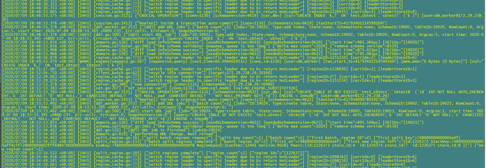

你好,如下是tidb-server 当时加索引时的日志:
[2020/07/09 18:48:53.375 +08:00] [INFO] [session.go:2121] [“CRUCIAL OPERATION”] [conn=1130] [schemaVersion=9619] [cur_db=] [sql=“CREATE INDEX k_7 ON test_sbtest.sbtest7 (k)”] [user=dm_worker@172.29.238.26]
[2020/07/09 18:48:53.376 +08:00] [INFO] [session.go:1413] [“NewTxn() inside a transaction auto commit”] [conn=1130] [schemaVersion=9619] [txnStartTS=417934012145991697]
[2020/07/09 18:48:53.378 +08:00] [INFO] [ddl_worker.go:253] ["[ddl] add DDL jobs"] [“batch count”=1] [jobs=“ID:19022, Type:add index, State:none, SchemaState:none, SchemaID:19002, TableID:19020, RowCount:0, ArgLen:5, start time: 2020-07-09 18:48:53.345 +0800 CST, Err:, ErrCount:0, SnapshotVersion:0; “]
[2020/07/09 18:48:53.378 +08:00] [INFO] [ddl.go:500] [”[ddl] start DDL job”] [job=“ID:19022, Type:add index, State:none, SchemaState:none, SchemaID:19002, TableID:19020, RowCount:0, ArgLen:5, start time: 2020-07-09 18:48:53.345 +0800 CST, Err:, ErrCount:0, SnapshotVersion:0”] [query=“CREATE INDEX k_7 ON test_sbtest.sbtest7 (k)”]
[2020/07/09 18:48:53.854 +08:00] [INFO] [domain.go:126] [“diff load InfoSchema success”] [usedSchemaVersion=9619] [neededSchemaVersion=9620] [“start time”=985.384µs] [tblIDs="[19020]"]
[2020/07/09 18:48:53.858 +08:00] [INFO] [schema_validator.go:246] [“the schema validator enqueue, queue is too long”] [“delta max count”=1024] [“remove schema version”=8529]
[2020/07/09 18:48:53.908 +08:00] [INFO] [domain.go:126] [“diff load InfoSchema success”] [usedSchemaVersion=9620] [neededSchemaVersion=9621] [“start time”=875.423µs] [tblIDs="[19020]"]
[2020/07/09 18:48:53.966 +08:00] [INFO] [domain.go:126] [“diff load InfoSchema success”] [usedSchemaVersion=9621] [neededSchemaVersion=9622] [“start time”=795.081µs] [tblIDs="[19020]"]
[2020/07/09 18:48:56.078 +08:00] [INFO] [region_cache.go:772] [“switch region leader to specific leader due to kv return NotLeader”] [regionID=1151234] [currIdx=2] [leaderStoreID=6]
[2020/07/09 18:49:53.470 +08:00] [WARN] [expensivequery.go:167] [expensive_query] [cost_time=60.094401951s] [conn_id=1130] [user=dm_worker] [txn_start_ts=417934012145991697] [mem_max=“0 Bytes (0 Bytes)”] [sql=“CREATE INDEX k_7 ON test_sbtest.sbtest7 (k)”]
[2020/07/09 18:51:17.067 +08:00] [INFO] [region_cache.go:772] [“switch region leader to specific leader due to kv return NotLeader”] [regionID=1138830] [currIdx=2] [leaderStoreID=1]
[2020/07/09 18:52:04.750 +08:00] [INFO] [client_batch.go:622] [“recycle idle connection”] [target=172.29.238.29:20160]
[2020/07/09 18:53:29.063 +08:00] [INFO] [region_cache.go:772] [“switch region leader to specific leader due to kv return NotLeader”] [regionID=27] [currIdx=1] [leaderStoreID=1]
[2020/07/09 18:53:29.070 +08:00] [INFO] [region_cache.go:772] [“switch region leader to specific leader due to kv return NotLeader”] [regionID=1151234] [currIdx=1] [leaderStoreID=1]
[2020/07/09 18:53:53.378 +08:00] [INFO] [server.go:388] [“new connection”] [conn=1131] [remoteAddr=172.29.238.26:56980]
[2020/07/09 18:53:53.383 +08:00] [INFO] [set.go:207] [“set session var”] [conn=1131] [name=sql_mode] [val=NO_ENGINE_SUBSTITUTION]
dm woker log 文本,完整上传一下吧,和一楼截图中 4000 端口对应 ip 的 tidb log

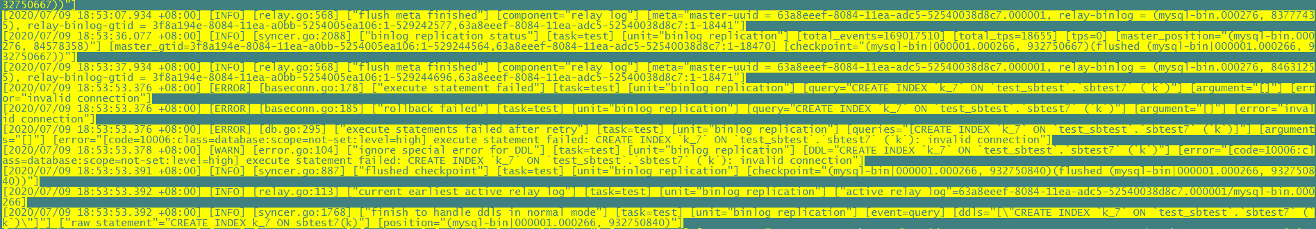

1.dm-worker-stderr.log 对应的信息如下:(26是worker ip,34是LB的地址)
18:53:53 packets.go:36: read tcp xxxx.238.26:45878->xxxxx.238.34:4000: i/o timeout

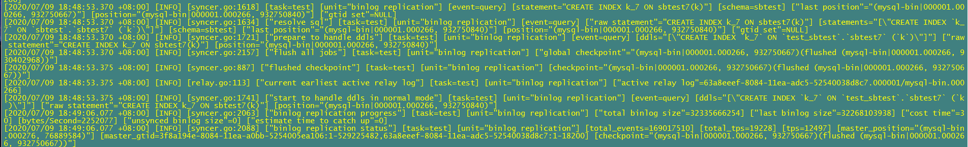

2.tidb-server 日志信息如下:
3.dm-worker.log 如下

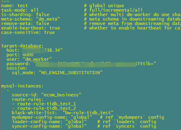

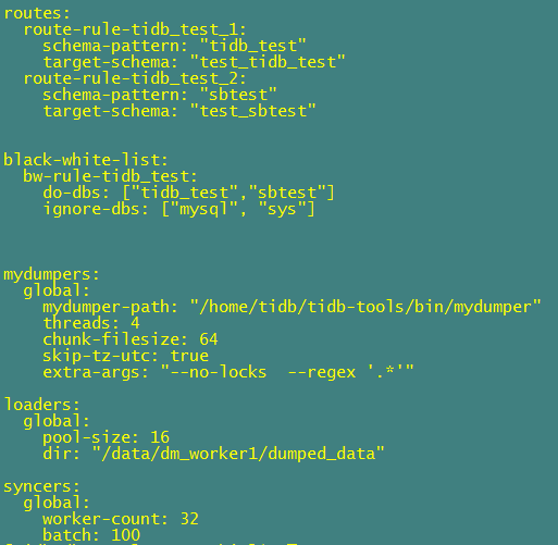

1.task 配置如下:未使用shard 模式
