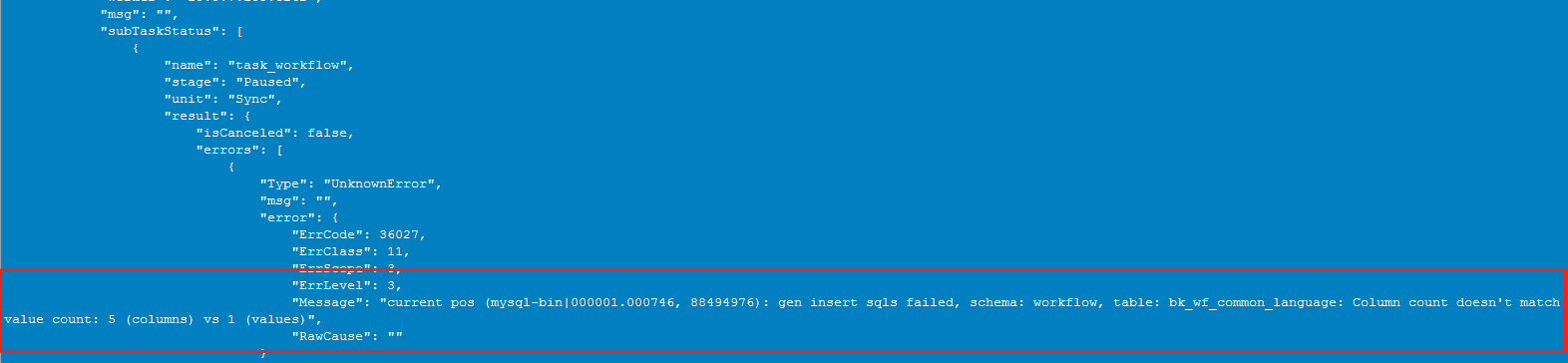

“subTaskStatus”: [
“name”: “task_workflow”,
“stage”: “Paused”,
“unit”: “Sync”,
“result”: {
“isCanceled”: false,
“errors”: [
“Type”: “UnknownError”,
“msg”: “”,
“error”: {
“ErrCode”: 36027,
“ErrClass”: 11,
“ErrScope”: 3,
“ErrLevel”: 3,
“Message”: “current pos (mysql-bin|000001.000746, 88494976): gen insert sqls failed, schema: workflow, table: bk_wf_common_language: Column count doesn’t match value count: 5 (columns) vs 1 (values)”,
“RawCause”: “”
bk_wf_common_language 表,看下上下游列数是否一致。

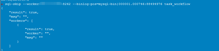

怎么跳过这张表
此为 task 文件检查,不建议跳过,此报错为上游列 > 下游列。容易引起其他报错
