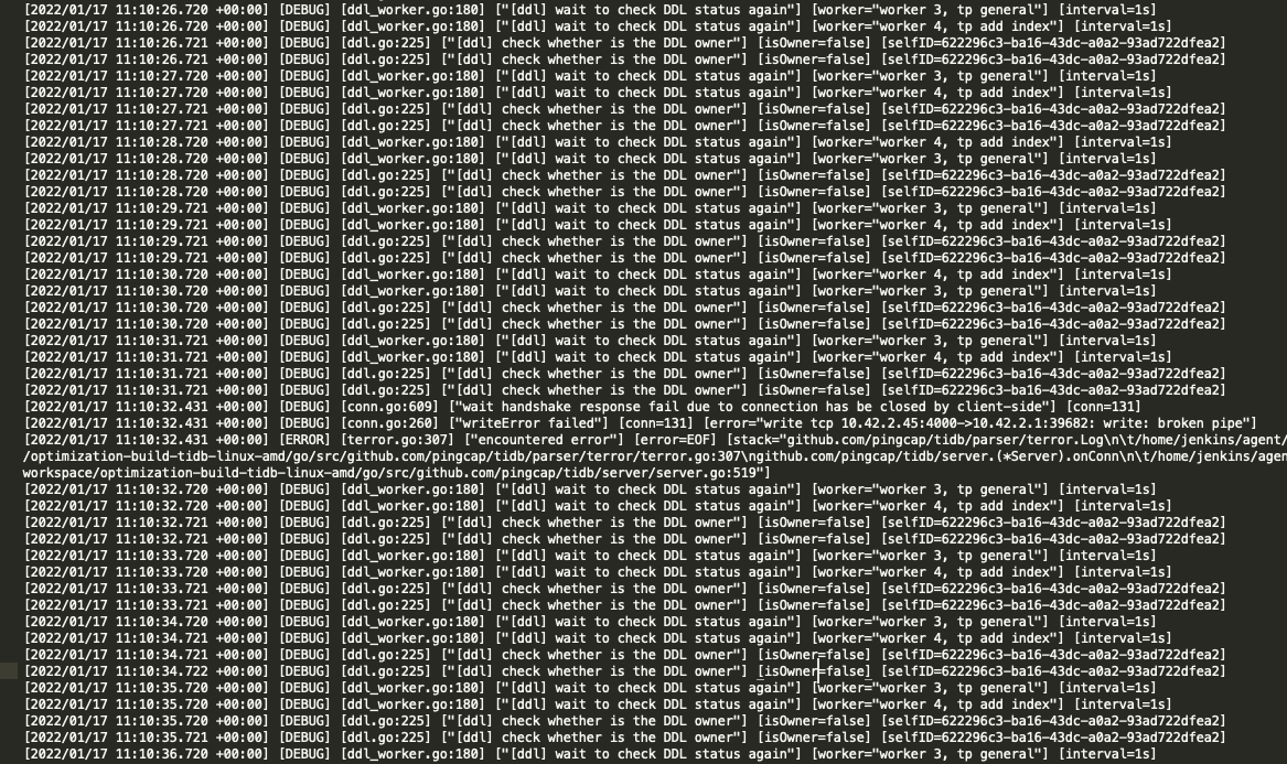

tidb 5.3.0 t大量错误ERROR
部署在k8s容器中,一直会尝试连接10.42.2.1,我也不懂为啥,都没有连接访问
[2022/01/17 11:10:32.431 +00:00] [DEBUG] [conn.go:609] [“wait handshake response fail due to connection has be closed by client-side”] [conn=131]
[2022/01/17 11:10:32.431 +00:00] [DEBUG] [conn.go:260] [“writeError failed”] [conn=131] [error=“write tcp 10.42.2.45:4000->10.42.2.1:39682: write: broken pipe”]
[2022/01/17 11:10:32.431 +00:00] [ERROR] [terror.go:307] [“encountered error”] [error=EOF] [stack=“github.com/pingcap/tidb/parser/terror.Log
\t/home/jenkins/agent/workspace/optimization-build-tidb-linux-amd/go/src/github.com/pingcap/tidb/parser/terror/terror.go:307
github.com/pingcap/tidb/server.(*Server).onConn
\t/home/jenkins/agent/workspace/optimization-build-tidb-linux-amd/go/src/github.com/pingcap/tidb/server/server.go:519”]
写入错误

tidb运行是正常,只是不知道为什么会有这个错误
:ok_hand:看报错,像是客户端 10.42.2.1 断开的连接,建议你先问问你们的 10.42.2.1 是啥地址
我也不懂,这些IP都不是服务,3个节点发送的都不一样,分别是:10.42.1.1,10.42.2.1,10.42.3.1
