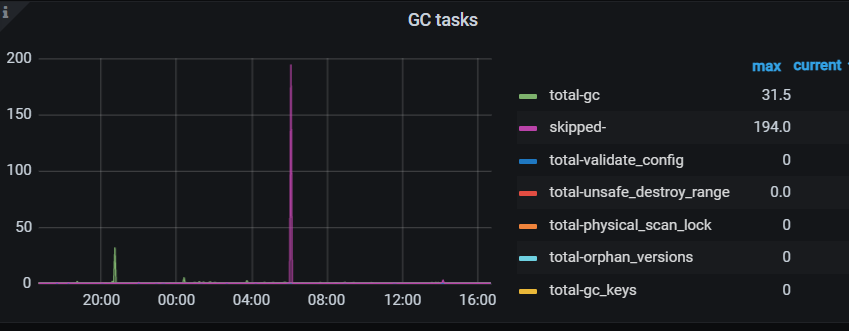

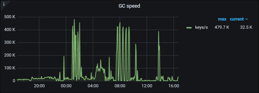

查看gc的参数和运行情况
SHOW config where type='tikv' AND name like '%enable-compaction-filter%'
查看gc.enable-compaction-filter参数值为false
执行SELECT * FROM mysql.tidb WHERE variable_name LIKE 'tikv_gc%'结果如下,可以看到gc是正常运行的
tikv_gc_scan_lock_mode legacy Mode of scanning locks, "physical" or "legacy"
tikv_gc_safe_point 20220328-11:36:36 +0800 All versions after safe point can be accessed. (DO NOT EDIT)
tikv_gc_run_interval 10m0s GC run interval, at least 10m, in Go format.
tikv_gc_mode distributed Mode of GC, "central" or "distributed"
tikv_gc_life_time 24h All versions within life time will not be collected by GC, at least 10m, in Go format.
tikv_gc_leader_uuid 5fda1fdc1880010 Current GC worker leader UUID. (DO NOT EDIT)
tikv_gc_leader_lease 20220329-11:39:36 +0800 Current GC worker leader lease. (DO NOT EDIT)
tikv_gc_leader_desc host:tidb-tidb-prd, pid:21338, start at 2022-03-08 15:47:36.711491545 +0800 CST m=+1.602036133 Host name and pid of current GC leader. (DO NOT EDIT)
tikv_gc_last_run_time 20220329-11:36:36 +0800 The time when last GC starts. (DO NOT EDIT)
tikv_gc_enable true Current GC enable status
tikv_gc_auto_concurrency true Let TiDB pick the concurrency automatically. If set false, tikv_gc_concurrency will be used
