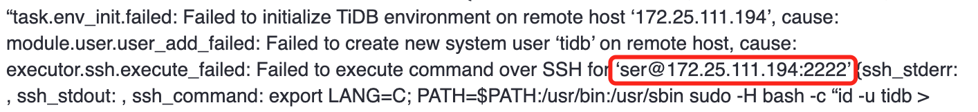

|2020-10-20T16:59:26.788+0800|ERROR|SSHCommand|{“host”: “172.25.111.194”, “port”: “2222”, “cmd”: “export LANG=C; PATH=$PATH:/usr/bin:/usr/sbin sudo -H bash -c “id -u tidb > /dev/null 2>&1 || (/usr/sbin/groupadd -f tidb && /usr/sbin/useradd -m -s /bin/bash -g tidb tidb) && echo ‘tidb ALL=(ALL) NOPASSWD:ALL’ > /etc/sudoers.d/tidb””, “error”: “ssh: handshake failed: ssh: unable to authenticate, attempted methods [none publickey], no supported methods remain”, “stdout”: “”, “stderr”: “”}|
|2020-10-20T16:59:26.788+0800|DEBUG|TaskFinish|{“task”: “EnvInit: user=tidb, host=172.25.111.194”, “error”: “task.env_init.failed: Failed to initialize TiDB environment on remote host ‘172.25.111.194’, cause: module.user.user_add_failed: Failed to create new system user ‘tidb’ on remote host, cause: executor.ssh.execute_failed: Failed to execute command over SSH for ‘ser@172.25.111.194:2222’ {ssh_stderr: , ssh_stdout: , ssh_command: export LANG=C; PATH=$PATH:/usr/bin:/usr/sbin sudo -H bash -c “id -u tidb > /dev/null 2>&1 || (/usr/sbin/groupadd -f tidb && /usr/sbin/useradd -m -s /bin/bash -g tidb tidb) && echo ‘tidb ALL=(ALL) NOPASSWD:ALL’ > /etc/sudoers.d/tidb”}, cause: ssh: handshake failed: ssh: unable to authenticate, attempted methods [none publickey], no supported methods remain”, “errorVerbose”: “task.env_init.failed: Failed to initialize TiDB environment on remote host ‘172.25.111.194’, cause: module.user.user_add_failed: Failed to create new system user ‘tidb’ on remote host, cause: executor.ssh.execute_failed: Failed to execute command over SSH for ‘ser@172.25.111.194:2222’ {ssh_stderr: , ssh_stdout: , ssh_command: export LANG=C; PATH=$PATH:/usr/bin:/usr/sbin sudo -H bash -c “id -u tidb > /dev/null 2>&1 || (/usr/sbin/groupadd -f tidb && /usr/sbin/useradd -m -s /bin/bash -g tidb tidb) && echo ‘tidb ALL=(ALL) NOPASSWD:ALL’ > /etc/sudoers.d/tidb”}, cause: ssh: handshake failed: ssh: unable to authenticate, attempted methods [none publickey], no supported methods remain\

以上是报错日志,从日志看是ssh 免密登录失败或者没有创建tidb用户导致的。
实际上免密登录没有问题 tidb用户也没有问题。
因为上周我用同样的机器、同样的命令、同样的配置文件,安装了 4.0.6 版本的tidb集群,并且安装成功了,今天我清理掉4.0.6的版本 想安装4.0.0的版本看下,结果报这个错误,现在想重新安装4.0.6版本也会报这个错误。
