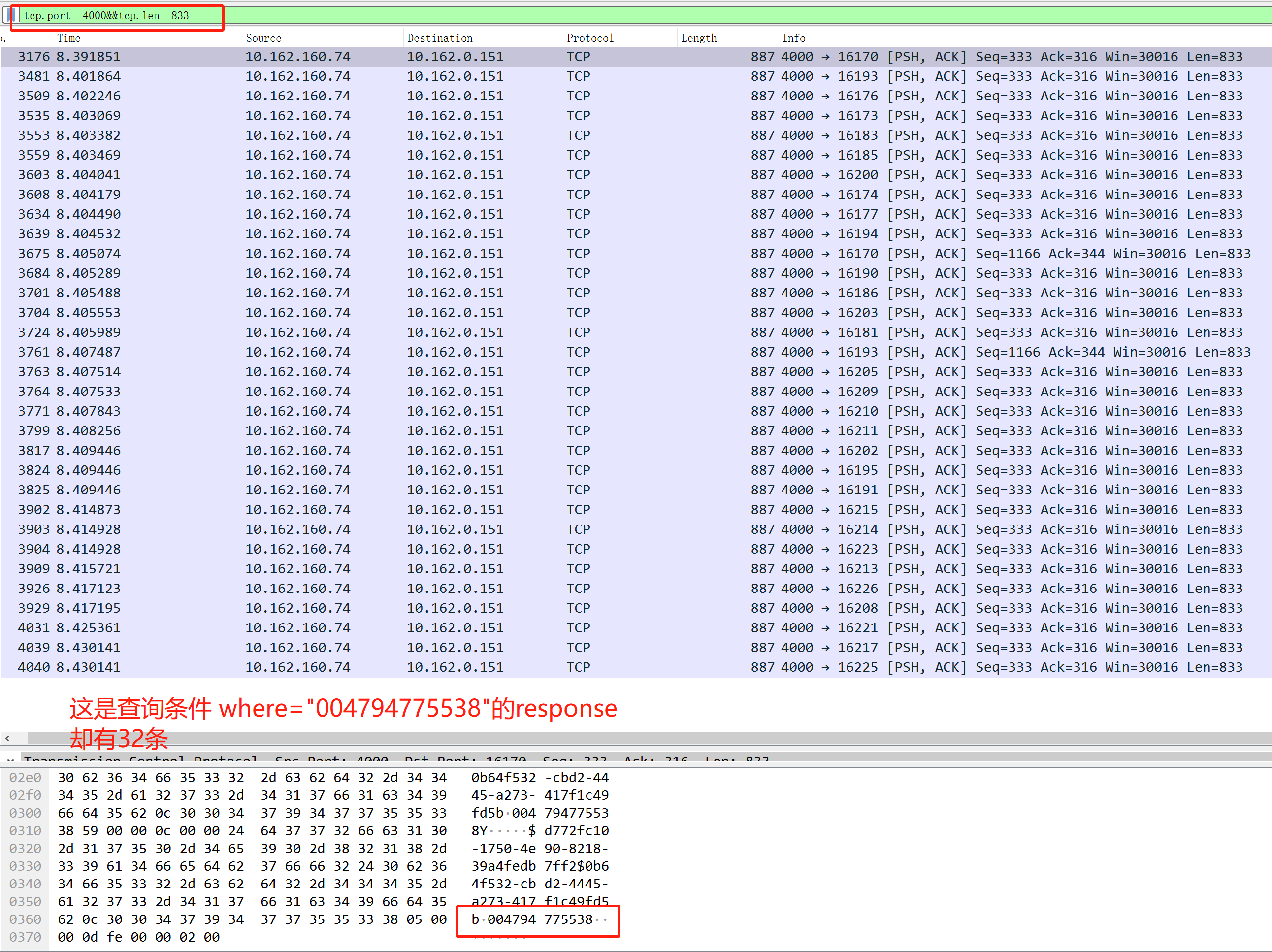

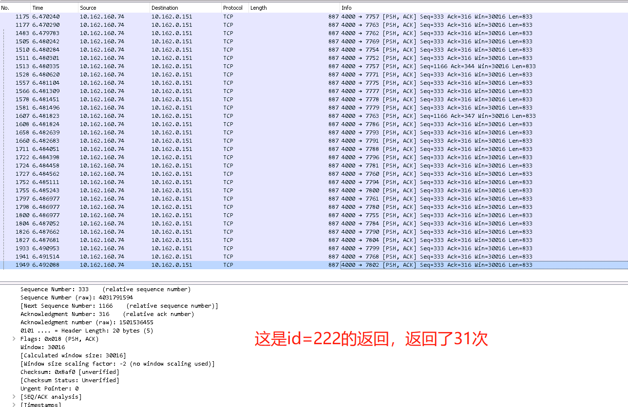

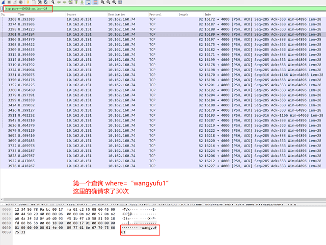

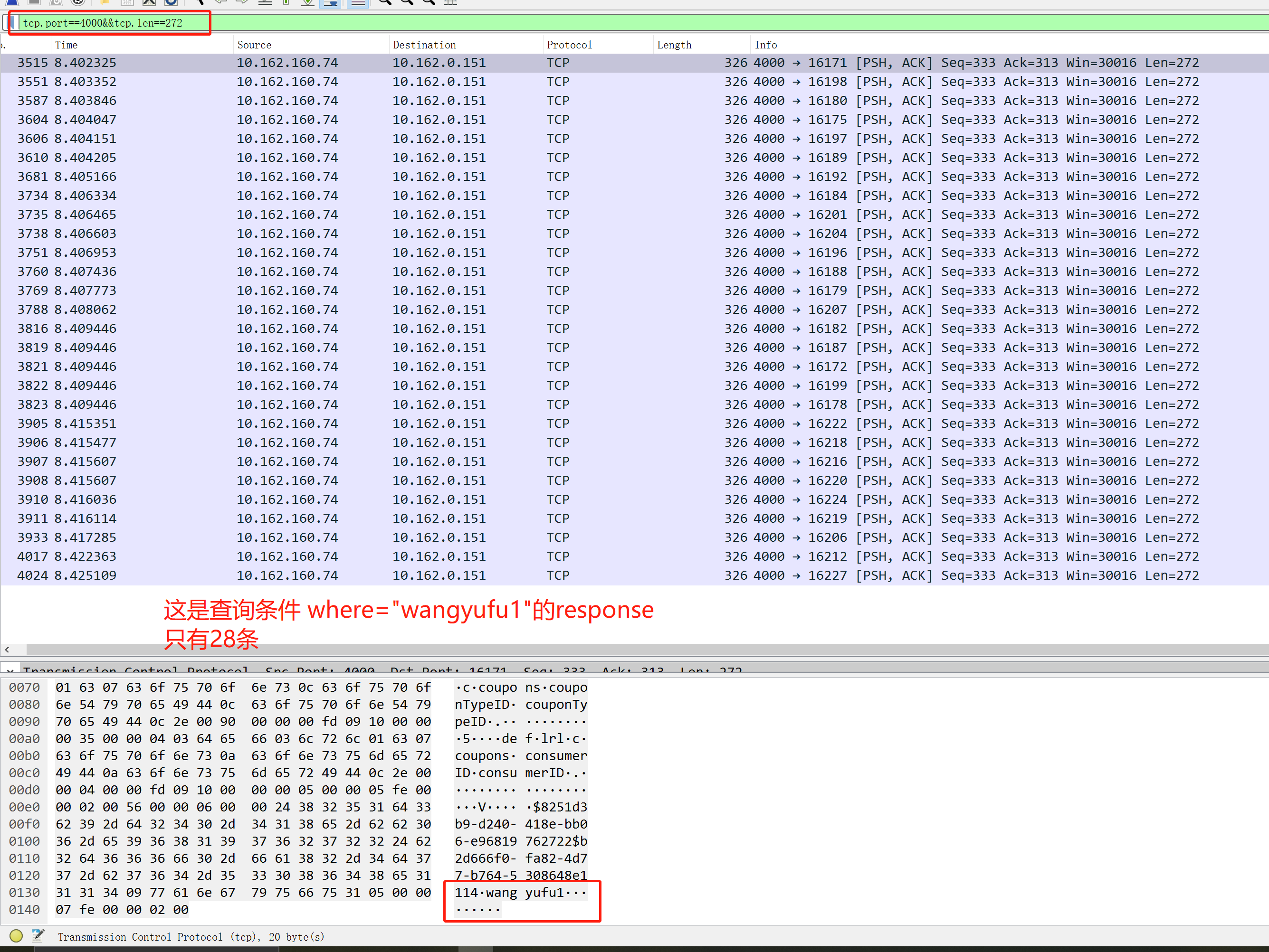

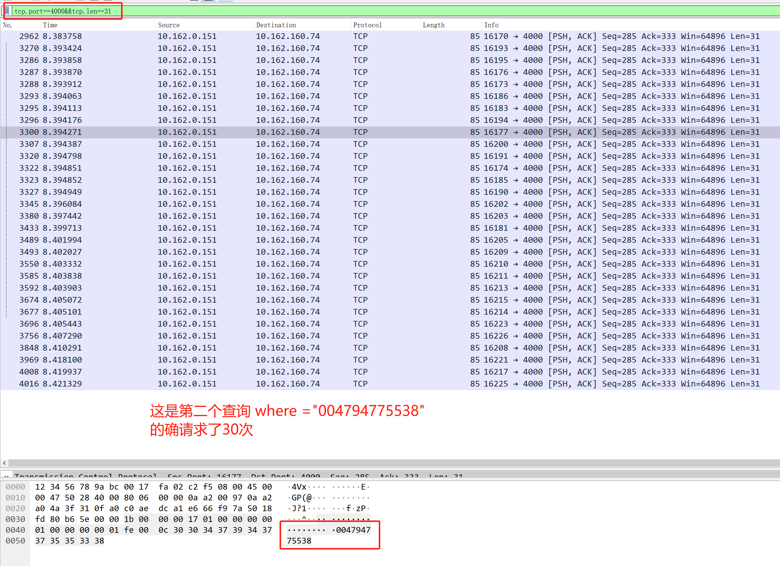

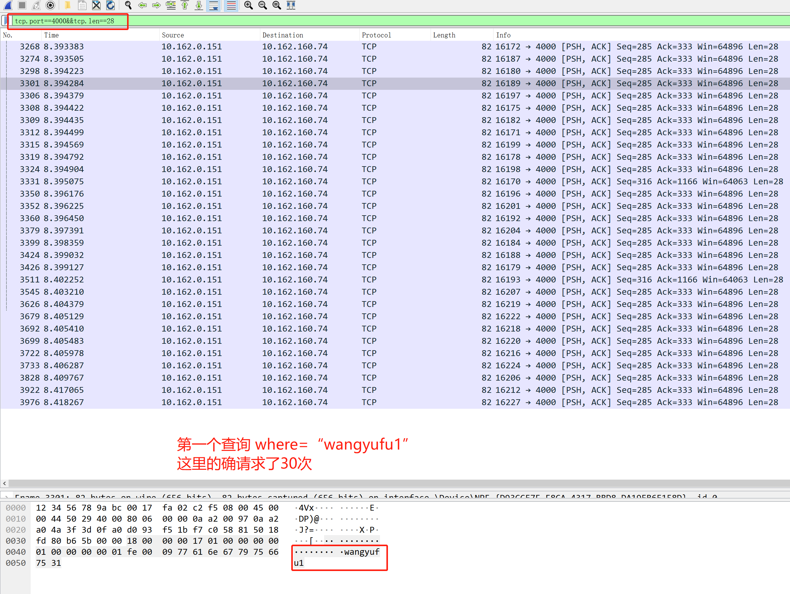

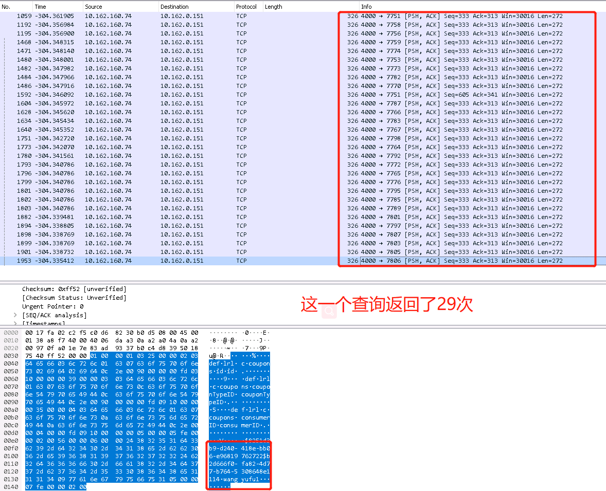

原来怀疑是我代码问题,后面结果各种排查无果,就用 WireShark抓了下包,发现{“111”, “222”}这两个数据的确各发了30次请求,查看Response神奇的事情发生了, 发现上面查询 111结果返回了29次,222返回了31次
所以就发生了上面那个现象,当查询id=1111 得到了一次 id=222的数据,下面有抓包截图

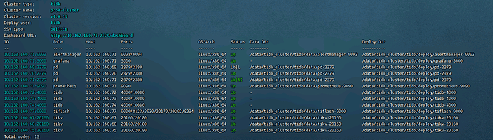

  1. TiUP Cluster Display 信息

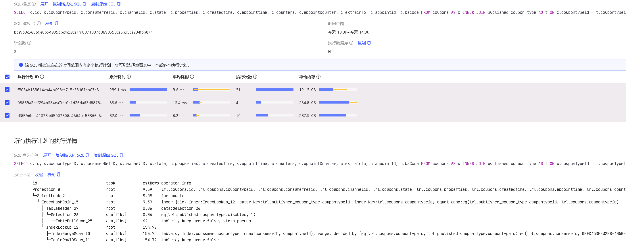

执行计划
	id                        	task     	estRows	operator info                                                                                                                                                                                                                                                                                              	actRows	execution info                                                                                                                                                                                                                                                                                                                                              	memory  	disk
Projection_8              	root     	9.59   	lrl.coupons.id, lrl.coupons.coupontypeid, lrl.coupons.consumerrefid, lrl.coupons.channelid, lrl.coupons.state, lrl.coupons.properties, lrl.coupons.createdtime, lrl.coupons.appointtime, lrl.coupons.counters, lrl.coupons.appointcounter, lrl.coupons.extrainfo, lrl.coupons.appointid, lrl.coupons.bacode	62     	time:9.95ms, loops:2, Concurrency:OFF                                                                                                                                                                                                                                                                                                                       	47.0 KB 	N/A
└─SelectLock_9            	root     	9.59   	for update                                                                                                                                                                                                                                                                                                 	0      	                                                                                                                                                                                                                                                                                                                                                            	N/A     	N/A
  └─IndexHashJoin_15      	root     	9.59   	inner join, inner:IndexLookUp_12, outer key:lrl.published_coupon_type.coupontypeid, inner key:lrl.coupons.coupontypeid, equal cond:eq(lrl.published_coupon_type.coupontypeid, lrl.coupons.coupontypeid)                                                                                                    	62     	time:9.93ms, loops:2, inner:{total:7.42ms, concurrency:4, task:1, construct:103.7µs, fetch:7.18ms, build:51.6µs, join:135.2µs}                                                                                                                                                                                                                           	227.9 KB	N/A
    ├─TableReader_27      	root     	0.06   	data:Selection_26                                                                                                                                                                                                                                                                                          	62     	time:2.28ms, loops:3, cop_task: {num: 1, max: 2.27ms, proc_keys: 62, rpc_num: 1, rpc_time: 2.25ms, copr_cache_hit_ratio: 0.00}                                                                                                                                                                                                                              	3.90 KB 	N/A
    │ └─Selection_26      	cop[tikv]	0.06   	eq(lrl.published_coupon_type.disabled, 1)                                                                                                                                                                                                                                                                  	62     	tikv_task:{time:0s, loops:2}, scan_detail: {total_process_keys: 62, total_keys: 162}                                                                                                                                                                                                                                                                        	N/A     	N/A
    │   └─TableFullScan_25	cop[tikv]	62     	table:t, keep order:false, stats:pseudo                                                                                                                                                                                                                                                                    	62     	tikv_task:{time:0s, loops:2}                                                                                                                                                                                                                                                                                                                                	N/A     	N/A
    └─IndexLookUp_12      	root     	154.72 	                                                                                                                                                                                                                                                                                                           	62     	time:7.03ms, loops:2, index_task: {total_time: 4.52ms, fetch_handle: 4.52ms, build: 1.2µs, wait: 4.9µs}, table_task: {total_time: 20.6ms, num: 1, concurrency: 4}                                                                                                                                                                                         	58.4 KB 	N/A
      ├─IndexRangeScan_10 	cop[tikv]	154.72 	table:c, index:cousumer_coupontype_index(consumerID, couponTypeID), range: decided by [eq(lrl.coupons.coupontypeid, lrl.published_coupon_type.coupontypeid) eq(lrl.coupons.consumerid, 0FEC45DF-328B-4050-BD3A-94A6301E56FB)], keep order:false                                                            	62     	time:4.51ms, loops:3, cop_task: {num: 1, max: 4.43ms, proc_keys: 62, tot_proc: 3ms, rpc_num: 1, rpc_time: 4.41ms, copr_cache_hit_ratio: 0.00}, tikv_task:{time:3ms, loops:2}, scan_detail: {total_process_keys: 62, total_keys: 124}                                                                                                                        	N/A     	N/A
      └─TableRowIDScan_11 	cop[tikv]	154.72 	table:c, keep order:false                                                                                                                                                                                                                                                                                  	62     	time:2.09ms, loops:2, cop_task: {num: 15, max: 1.87ms, min: 930.8µs, avg: 1.13ms, p95: 1.87ms, max_proc_keys: 23, p95_proc_keys: 23, tot_proc: 1ms, tot_wait: 3ms, rpc_num: 15, rpc_time: 16.7ms, copr_cache_hit_ratio: 0.00}, tikv_task:{proc max:1ms, min:0s, p80:0s, p95:1ms, iters:15, tasks:15}, scan_detail: {total_process_keys: 62, total_keys: 70}	N/A     	N/A

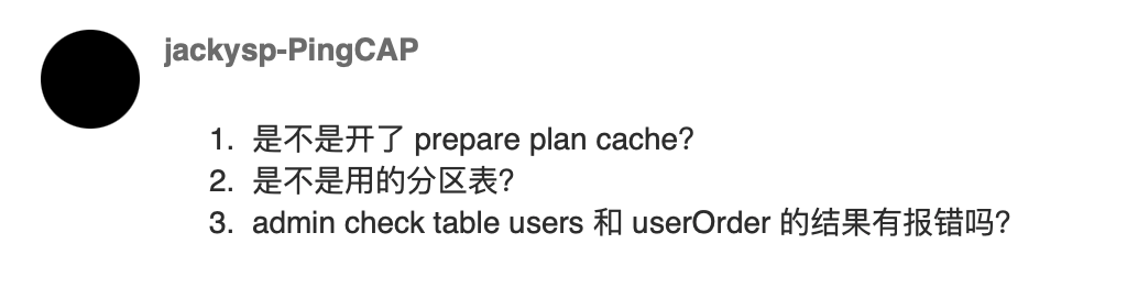

  1. 是不是开了 prepare plan cache?
  2. 是不是用的分区表?
  3. admin check table users 和 userOrder 的结果有报错吗?

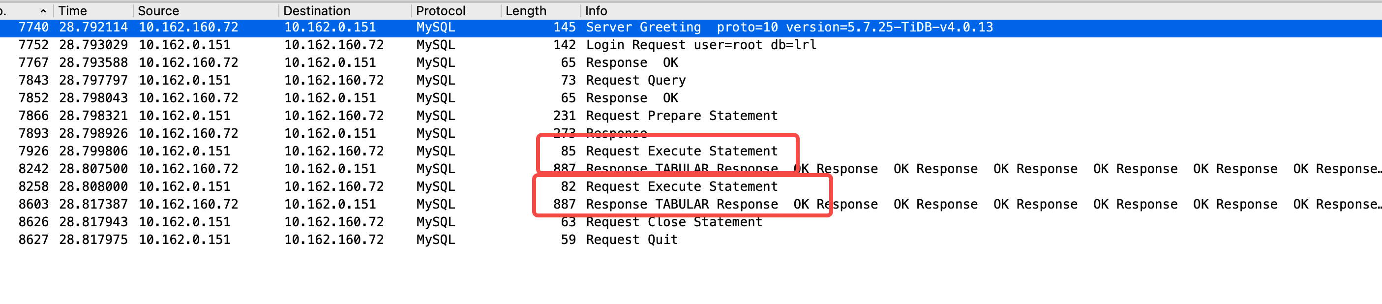

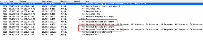

  1. 从 tidb-client.pcapng 里查看,prepare 了 60 次,30 次 wangyufu1 和 30 次Value: 004794775538,但是 resopnse 的时候,29 次wangyufu1 和 31 次 004794775538
  2. 对比发现Des port 5141 这里有些问题
  3. 从客户端来看,您可以确认下,一个程序单线程是否有出现过这种情况,都是多线程时出错的吗?能详细描述下,客户端到db端的链接方法和代码吗?

集群拓扑图一样的吗,附件是我线上系统 tiup cluster edit-config 的配置文件
可能跟数据量也有关系
tidb.config (3.9 KB)
