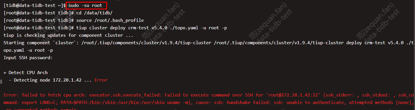

执行tiup cluster deploy test v5.4.0 ./topo.yaml --user root -p命令时报错:
Input SSH password:
  • Detect CPU Arch
    • Detecting node 172.20.1.95 … Error
Error: failed to fetch cpu arch: executor.ssh.execute_failed: Failed to execute command over SSH for ‘root@172.20.1.xx:22’ {ssh_stderr: , ssh_stdout: , ssh_command: export LANG=C; PATH=$PATH:/bin:/sbin:/usr/bin:/usr/sbin uname -m}, cause: ssh: handshake failed: ssh: unable to authenticate, attempted methods [none], no supported methods remain

你好啊老哥,我按照你的办法设置了,但是还是不行,一样的问题
密码没问题的,就是本机root的密码,我是按照文档里说的在单机环境进行测试的。

还是不行,已经可以从tidb用户无密码登录root,但是错误还是没变
