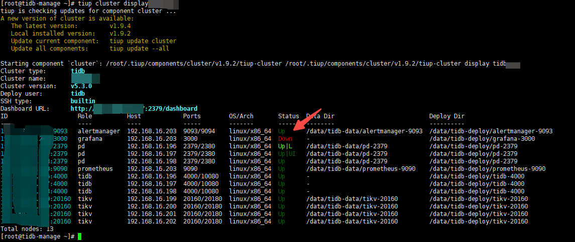

grafana状态为down 启动失败
【 TiDB 版本】5.3.0
【遇到的问题】
【复现路径】
【问题现象及影响】
执行命令tiup cluster start tidb-zj -N ip:3000
报错
Error: failed to start grafana: failed to start: 192.168.16.203 grafana-3000.service, please check the instance’s log(/data/tidb-deploy/grafana-3000/log) for more detail.: timed out waiting for port 3000 to be started after 2m0s
Verbose debug logs has been written to /root/.tiup/logs/tiup-cluster-debug-2022-05-10-10-57-37.log.

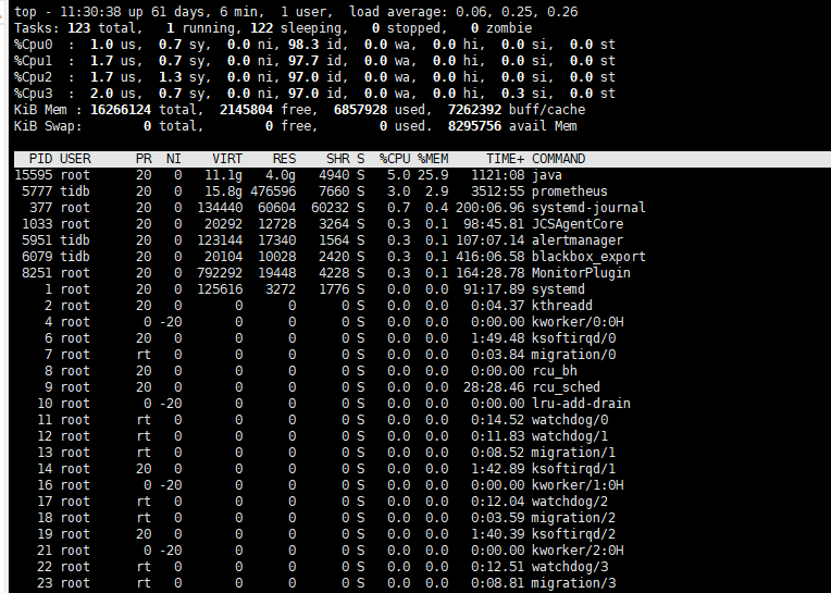

机器的性能怎么样 是不是内存不足导致服务启动慢或者oom?
感觉内存 cpu 还够用。

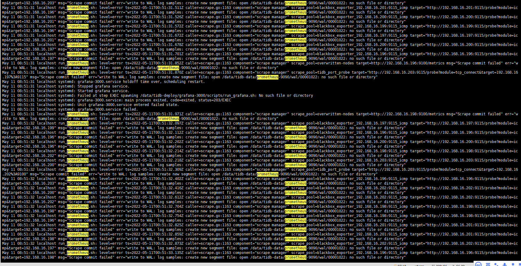

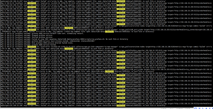

/var/log/message 有没有什么有用的信息:face_with_monocle:
netstat -nlp | grep 3000
返回是空的, 没有占用这个3000端口的。
磁盘是否满了?
磁盘没满。
May 11 08:51:31 localhost systemd: grafana-3000.service holdoff time over, scheduling restart.
May 11 08:51:31 localhost systemd: Stopped grafana service.
May 11 08:51:31 localhost systemd: Started grafana service.
May 11 08:51:31 localhost systemd: Failed at step EXEC spawning /data/tidb-deploy/grafana-3000/scripts/run_grafana.sh: No such file or directory
May 11 08:51:31 localhost systemd: grafana-3000.service: main process exited, code=exited, status=203/EXEC
May 11 08:51:31 localhost systemd: Unit grafana-3000.service entered failed state.
May 11 08:51:31 localhost systemd: grafana-3000.service failed.
