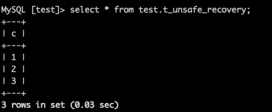

4.查看表数据
select * from test.t_unsafe_recovery;
