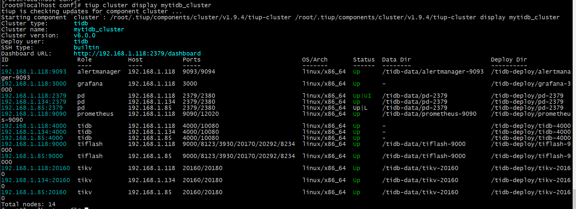

集群状态如下,好像都是正常的
[root@localhost conf]# tiup cluster display mytidb_cluster
tiup is checking updates for component cluster …
Starting component cluster: /root/.tiup/components/cluster/v1.9.4/tiup-cluster /root/.tiup/components/cluster/v1.9.4/tiup-cluster display mytidb_cluster
Cluster type: tidb
Cluster name: mytidb_cluster
Cluster version: v6.0.0
Deploy user: tidb
SSH type: builtin
Dashboard URL: http://192.168.1.118:2379/dashboard
192.168.1.118:9093 alertmanager 192.168.1.118 9093/9094 linux/x86_64 Up /tidb-data/alertmanager-9093 /tidb-deploy/alertmanager-9093
192.168.1.118:3000 grafana 192.168.1.118 3000 linux/x86_64 Up - /tidb-deploy/grafana-3000
192.168.1.118:2379 pd 192.168.1.118 2379/2380 linux/x86_64 Up|UI /tidb-data/pd-2379 /tidb-deploy/pd-2379
192.168.1.134:2379 pd 192.168.1.134 2379/2380 linux/x86_64 Up /tidb-data/pd-2379 /tidb-deploy/pd-2379
192.168.1.85:2379 pd 192.168.1.85 2379/2380 linux/x86_64 Up|L /tidb-data/pd-2379 /tidb-deploy/pd-2379
192.168.1.118:9090 prometheus 192.168.1.118 9090/12020 linux/x86_64 Up /tidb-data/prometheus-9090 /tidb-deploy/prometheus-9090
192.168.1.118:4000 tidb 192.168.1.118 4000/10080 linux/x86_64 Up - /tidb-deploy/tidb-4000
192.168.1.134:4000 tidb 192.168.1.134 4000/10080 linux/x86_64 Up - /tidb-deploy/tidb-4000
192.168.1.85:4000 tidb 192.168.1.85 4000/10080 linux/x86_64 Up - /tidb-deploy/tidb-4000
192.168.1.118:9000 tiflash 192.168.1.118 9000/8123/3930/20170/20292/8234 linux/x86_64 Up /tidb-data/tiflash-9000 /tidb-deploy/tiflash-9000
192.168.1.85:9000 tiflash 192.168.1.85 9000/8123/3930/20170/20292/8234 linux/x86_64 Up /tidb-data/tiflash-9000 /tidb-deploy/tiflash-9000
192.168.1.118:20160 tikv 192.168.1.118 20160/20180 linux/x86_64 Up /tidb-data/tikv-20160 /tidb-deploy/tikv-20160
192.168.1.134:20160 tikv 192.168.1.134 20160/20180 linux/x86_64 Up /tidb-data/tikv-20160 /tidb-deploy/tikv-20160
192.168.1.85:20160 tikv 192.168.1.85 20160/20180 linux/x86_64 Up /tidb-data/tikv-20160 /tidb-deploy/tikv-20160
Total nodes: 14
