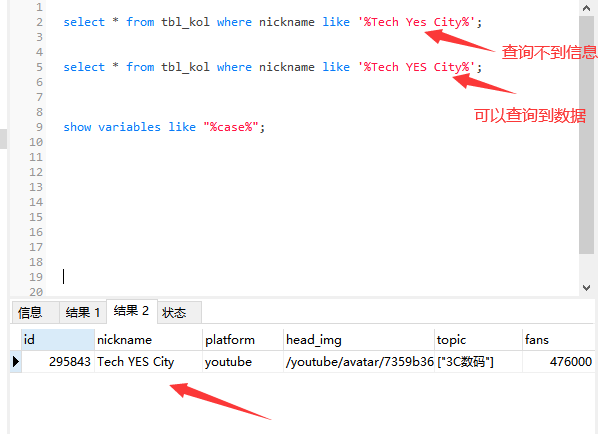

TiDB查询发现区分大小写,这个如何设置不区分?
我们项目最近从mysql8.0.14迁移到TiDB v4.0.8版本,现在发现一个小问题,
模糊查询时,之前mysql是不区分大小写的,但TiDB是区分大小写的,这个需要在哪里设置呢?

这是查询数据的插入语句,
INSERT INTO tbl_kol(id, nickname, platform, head_img, topic, fans, country, home_link, register_time, create_time, update_time, last_json, email, confirm_email, social_links, is_establish_cooperation) VALUES (295843, ‘Tech YES City’, ‘youtube’, ‘/youtube/avatar/7359b36d1a241615129230d604c326b706734c87.jpg’, ‘[“3C数码”]’, 476000, ‘Australia’, ‘https://www.youtube.com/channel/UC9Tn-atYOt8qZP-oqui7bhw’, NULL, 1599045374, 1609690531, ‘{"_values": {“avatar”: “https://yt3.ggpht.com/ytc/AAUvwnjl112HuZoI6kly4k3OaI5wzc6iF-1XJzoj3FhIzA=s900-c-k-c0x00ffffff-no-rj”, “channel_id”: “UC9Tn-atYOt8qZP-oqui7bhw”, “country”: “Australia”, “email”: [“bryan@techcity.tv”], “fans”: 476000, “home_link”: “https://www.youtube.com/channel/UC9Tn-atYOt8qZP-oqui7bhw”, “nickname”: “Tech YES City”, “platform”: “youtube”, “signature”: “Gaming PCs with the best bang for buck, should you get a AMD ZEN 3 Ryzen? Maybe an NVIDIA RTX 3080 over a 3070? Or avoid NVIDIA and go BIG NAVI with the RX 6900 XT or 6700? If you’re asking these questions, you’re in the right place. Benchmarks, in depth reviews, comparisons on all the latest tech and even compared against used Intel XEON tech for the best price performance.\ \ For all business inquiries please contact via using e-mail address below.\ \ For all sponsorship inquiries please inquire here - bryan@techcity.tv\ \ For sending me over random gear to unbox in vlogs, or test, or something crazy then the PO is:\ \ Bryan B.\ PO BOX 546\ NERANG QLD 4211\ Australia”, “social_links”: {“facebook”: “https://www.facebook.com/TechYESCity”, “instagram”: “http://www.instagram.com/techyescity”, “twitter”: “https://www.twitter.com/techyescity”, “youtube”: “https://www.youtube.com/channel/UC9Tn-atYOt8qZP-oqui7bhw”}, “total_views”: “106728766”, “user_created”: “Dec 28, 2007”, “verified”: 1, “video_count”: “1362”}}’, ‘[“bryan@techcity.tv”]’, NULL, ‘{“facebook”: “https://www.facebook.com/TechYESCity”, “instagram”: “http://www.instagram.com/techyescity”, “twitter”: “https://www.twitter.com/techyescity”, “youtube”: “https://www.youtube.com/channel/UC9Tn-atYOt8qZP-oqui7bhw”}’, 1);

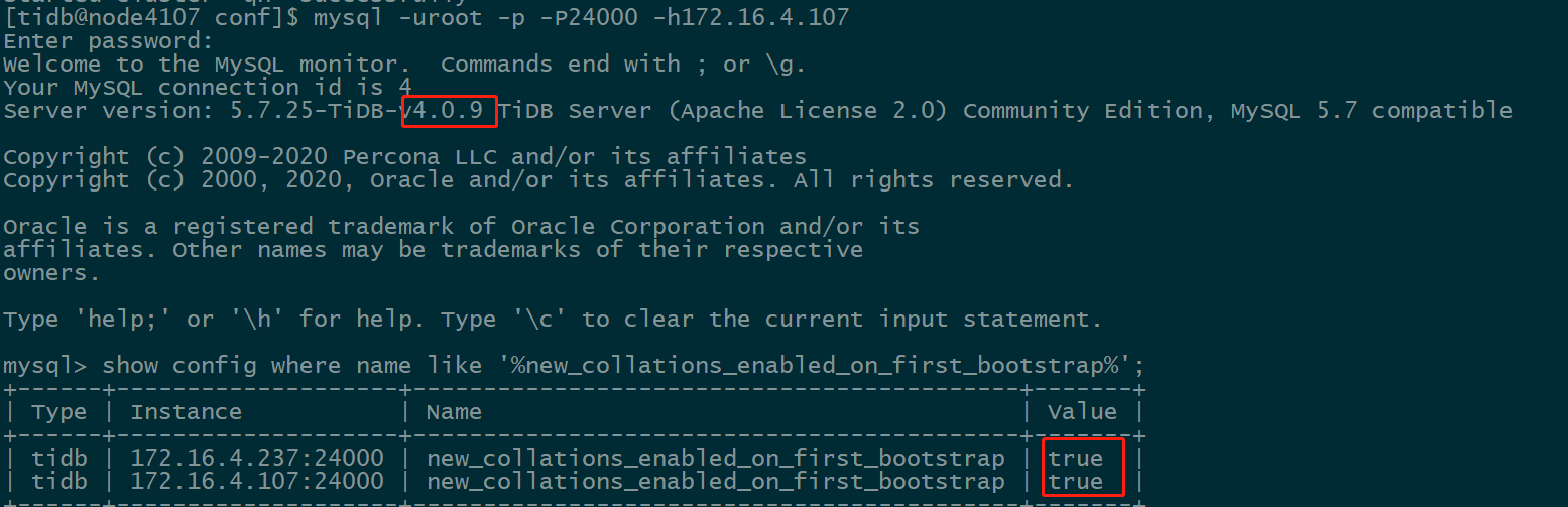

https://docs.pingcap.com/zh/tidb/stable/tidb-configuration-file#new_collations_enabled_on_first_bootstrap
注意看下注意事项。
java 的具体报错建议追下代码,为了更好地开发,建议做一些处理。
navicat连接tidb数据库查询报的错误,还没到代码层面
  • 用于开启新的 collation 支持
  • 默认值:false
  • 注意:该配置项只有在初次初始化集群时生效,初始化集群后,无法通过更改该配置项打开或关闭新的 collation 框架;4.0 版本之前的 TiDB 集群升级到 4.0 时,由于集群已经初始化过,该参数无论如何配置,都作为 false 处理。
上面的错误是new_collations_enabled_on_first_bootstrap参数导致的吗?安装集群之后是无法更改这个参数吗?
大佬,改这个参数报错呢?还有其他解决办法吗?
是的,只能重建集群把这个参数加上才行。否则当前需求无法满足。
如果报错建议把参数改回去试下呢,已经初始化的集群已经不能使用这个参数了。
这边测试没有这个问题,Navicat 版本如下:
PS:不知道 Navicat 使用什么版本,直连 tidb-server 应该不会有报错吧。

https://docs.pingcap.com/zh/tidb/stable/production-deployment-using-tiup
已经解决了,谢谢,在以下节点增加配置即可
server_configs:
tidb:
new_collations_enabled_on_first_bootstrap: true
