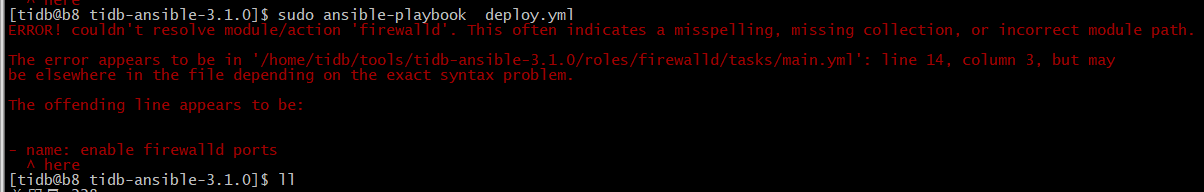

新接手的一个项目,据说是停掉后 业务异常,然后手动启tidb启不来。
启动及报错信息如下:
[tidb@b8 tidb-ansible-3.1.0]$ sudo ansible-playbook start.yml

fatal: [192.168.10.101]: FAILED! => {“attempts”: 20, “changed”: false, “msg”: “Unsupported parameters for (ansible.legacy.uri) module: return content Supported parameters include: attributes, body, body_format, client_cert, client_key, creates, dest, follow_redirects, force, force_basic_auth, group, headers, http_agent, method, mode, owner, remote_src, removes, return_content, selevel, serole, setype, seuser, src, status_code, timeout, unix_socket, unsafe_writes, url, url_password, url_username, use_proxy, validate_certs”}

[192.168.10.101]: Ansible FAILED! => playbook: start.yml; TASK: wait for region replication complete; message: {“attempts”: 20, “changed”: false, “msg”: “Unsupported parameters for (ansible.legacy.uri) module: return content Supported parameters include: attributes, body, body_format, client_cert, client_key, creates, dest, follow_redirects, force, force_basic_auth, group, headers, http_agent, method, mode, owner, remote_src, removes, return_content, selevel, serole, setype, seuser, src, status_code, timeout, unix_socket, unsafe_writes, url, url_password, url_username, use_proxy, validate_certs”}
