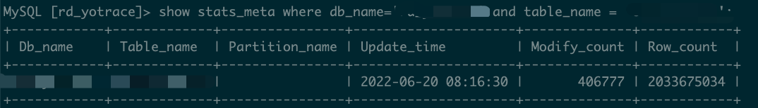

健康度 99
多谢指点:

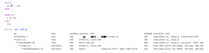

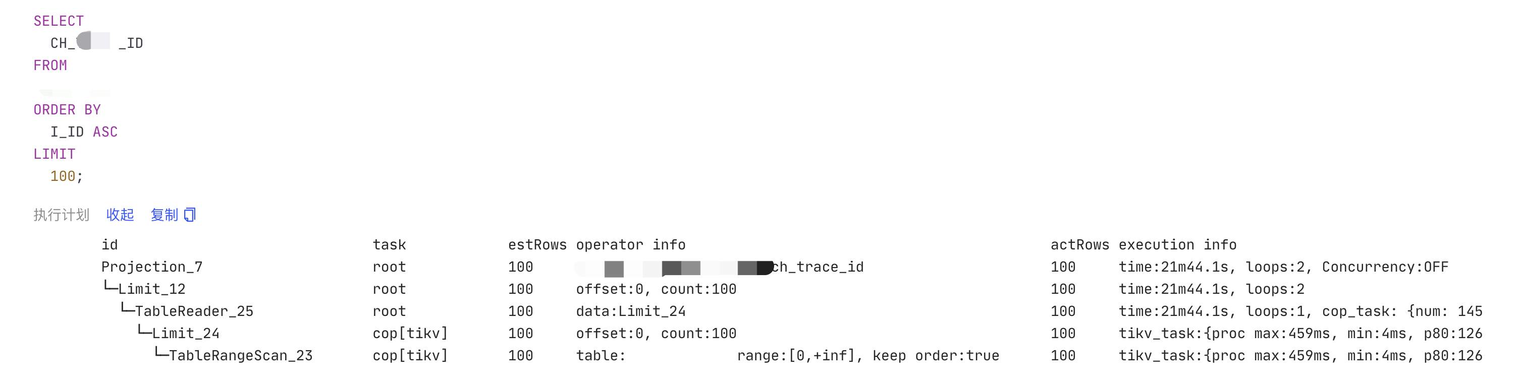

  2. dashboard上的执行计划:(今天的,sql每次要执行20min左右,只能提供相对新鲜的analyze)
    PS: i_id为主键。
SELECT CH_ID FROM tb1 ORDER BY I_ID ASC LIMIT 100;
	id                       	task     	estRows	operator info                                     	actRows	execution info                                                                                                                                                                                                                                                                                         	memory 	disk
	Projection_7             	root     	100    	db1.tb1.ch_trace_id                	100    	time:21m44.1s, loops:2, Concurrency:OFF                                                                                                                                                                                                                                                                	6.62 KB	N/A
	└─Limit_12               	root     	100    	offset:0, count:100                               	100    	time:21m44.1s, loops:2                                                                                                                                                                                                                                                                                 	N/A    	N/A
	  └─TableReader_25       	root     	100    	data:Limit_24                                     	100    	time:21m44.1s, loops:1, cop_task: {num: 14518, max: 459.6ms, min: 285.2µs, avg: 88.5ms, p95: 183.5ms, max_proc_keys: 100, p95_proc_keys: 0, tot_proc: 21m10s, tot_wait: 5.29s, rpc_num: 14518, rpc_time: 21m24s, copr_cache_hit_ratio: 0.12}, backoff{regionMiss: 15.3s}                              	5.19 KB	N/A
	    └─Limit_24           	cop[tikv]	100    	offset:0, count:100                               	100    	tikv_task:{proc max:459ms, min:4ms, p80:126ms, p95:188ms, iters:14520, tasks:14518}, scan_detail: {total_process_keys: 100, total_keys: 4875306766, rocksdb: {delete_skipped_count: 3947646, key_skipped_count: 4883560764, block: {cache_hit_count: 124342, read_count: 3390687, read_byte: 16.9 GB}}}	N/A    	N/A
	      └─TableRangeScan_23	cop[tikv]	100    	table:tb1, range:[0,+inf], keep order:true	100    	tikv_task:{proc max:459ms, min:4ms, p80:126ms, p95:188ms, iters:14520, tasks:14518}, scan_detail: {total_process_keys: 0, total_keys: 0, rocksdb: {delete_skipped_count: 0, key_skipped_count: 0, block: {cache_hit_count: 0, read_count: 0, read_byte: 0 Bytes}}}                                     	N/A    	N/A
这里两个值差别很大,要么就是 gc 问题,要么就是版本还多。

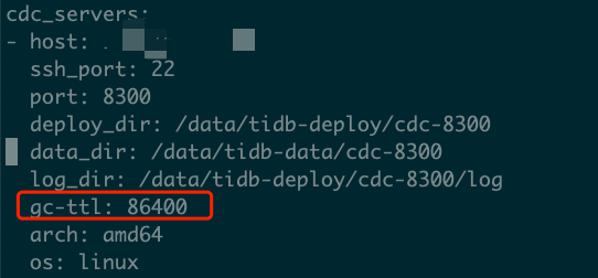

tidb 集群开启了 ti-cdc,但是这个表没有使用cdc同步。
gc-ttl = 86400 (1天)
gc相关变量:tidb_gc_life_time=8h; tidb_gc_run_interval=10m0s
