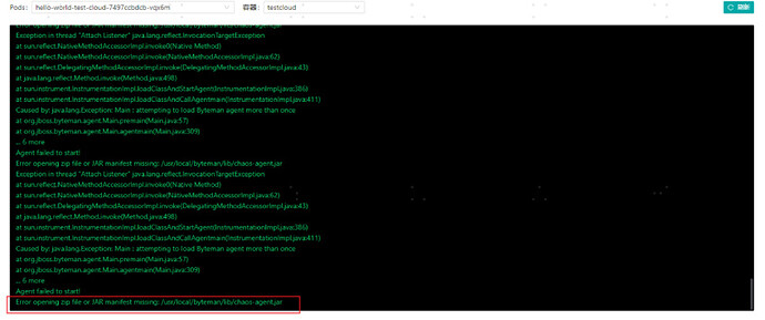

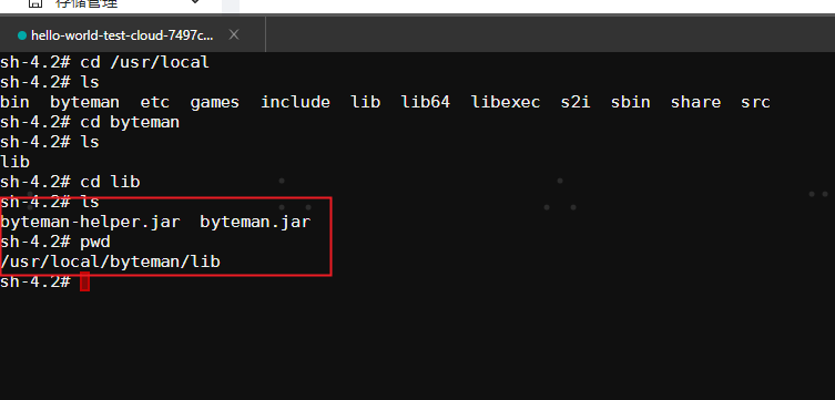

Failed to apply chaos: rpc error: code = Unknown desc = com.sun.tools.attach.AgentLoadException: 102 com.sun.tools.attach.AgentLoadException: 100 at jdk.attach/sun.tools.attach.HotSpotVirtualMachine.loadAgentLibrary(HotSpotVirtualMachine.java:108) at jdk.attach/sun.tools.attach.HotSpotVirtualMachine.loadAgentLibrary(HotSpotVirtualMachine.java:119) at jdk.attach/sun.tools.attach.HotSpotVirtualMachine.loadAgent(HotSpotVirtualMachine.java:147) at jdk.attach/com.sun.tools.attach.VirtualMachine.loadAgent(VirtualMachine.java:538) at org.chaos_mesh.agent_installer.Install.injectAgent(Install.java:255) at org.chaos_mesh.agent_installer.Install.main(Install.java:48) : exit status 1
容器日志报以下错误:
