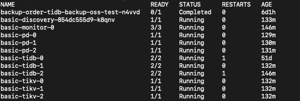

【现象】

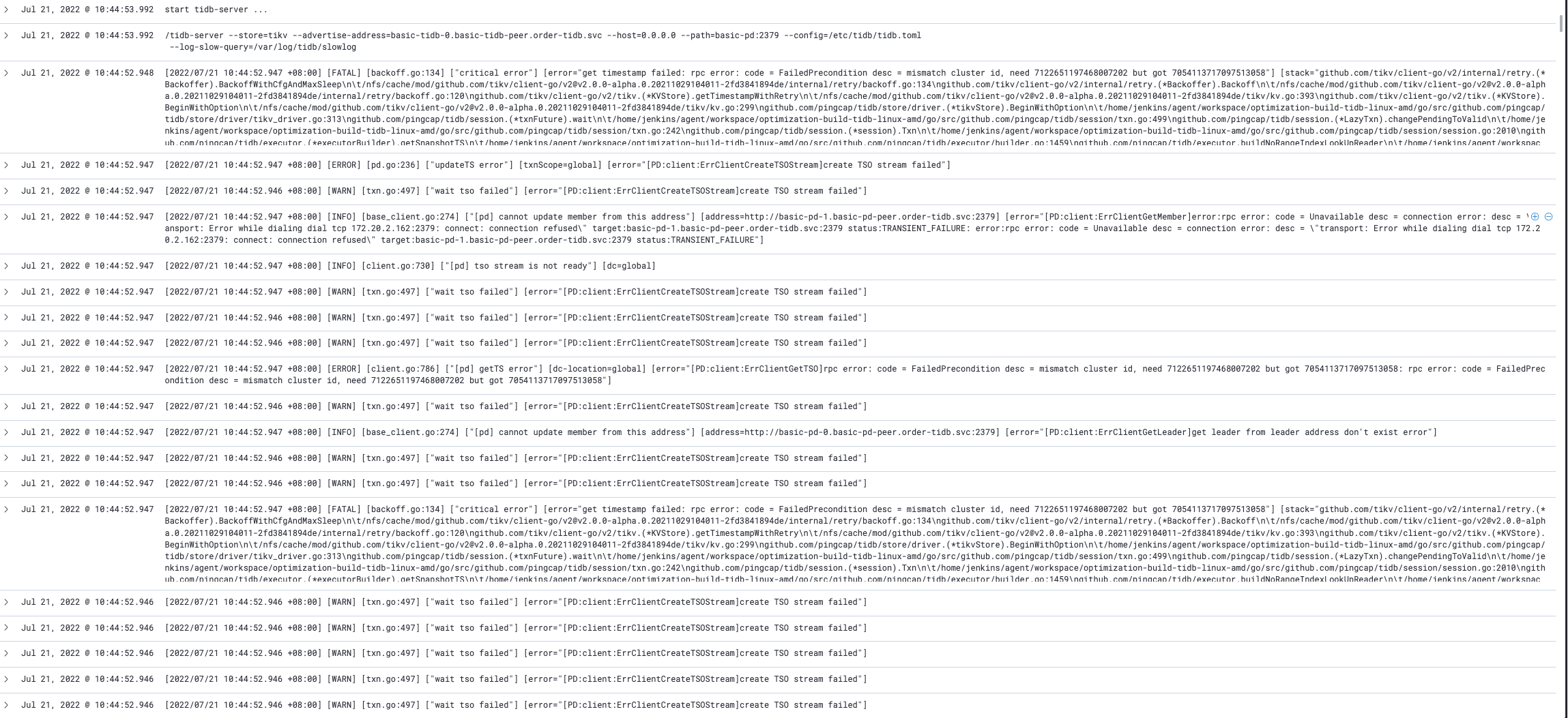

测试环境3个pd节点部署在同一机器上,机器故障后pd集群在别的机器重启了。tikv使用的pvc没有变化但是所有数据都丢失,启动了一个新的tidb集群([“critical error”] [error="get timestamp failed: rpc error: code = FailedPrecondition desc = mismatch cluster id, need 7122651197468007202 but got 7054113717097513058)。

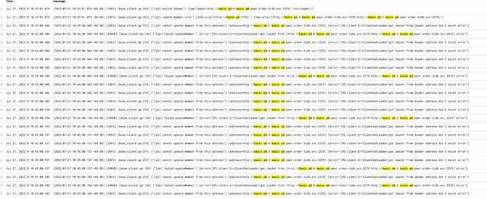

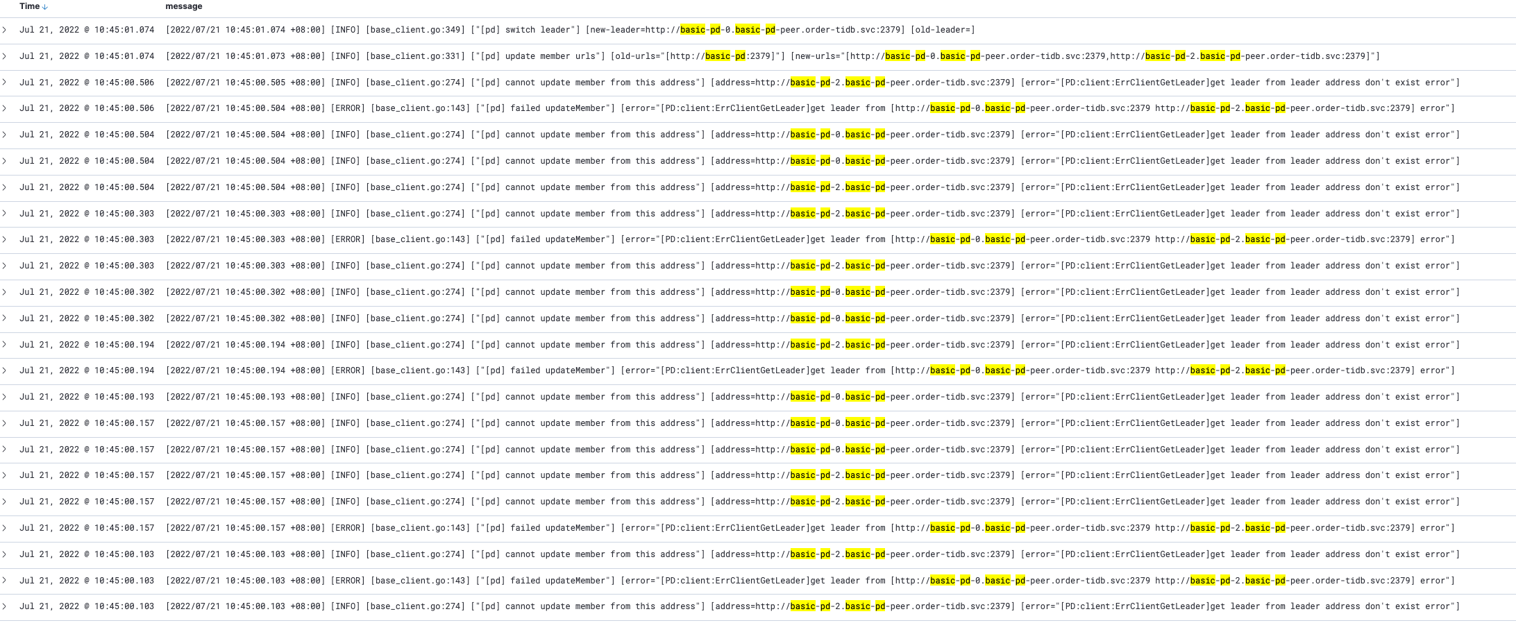

日志写入了kibana,集群重启的时间点的日志:

我参照这里(https://docs.pingcap.com/zh/tidb-in-kubernetes/stable/pd-recover)用7054113717097513058作为cluster_id基于pd-recover重建了pd集群,然后tikv集群起不来了。。
[2022/07/21 14:52:27.557 +08:00] [ERROR] [server.rs:1052] [“failed to init io snooper”] [err_code=KV:Unknown] [err="“IO snooper is not started due to not compiling with BCC”"]
[2022/07/21 14:52:27.668 +08:00] [INFO] [mod.rs:227] [“Storage started.”]
[2022/07/21 14:52:27.671 +08:00] [FATAL] [server.rs:732] [“failed to bootstrap node id: “[src/server/node.rs:241]: cluster ID mismatch, local 7122651197468007202 != remote 7054113717097513058, you are trying to connect to another cluster, please reconnect to the correct PD””]
