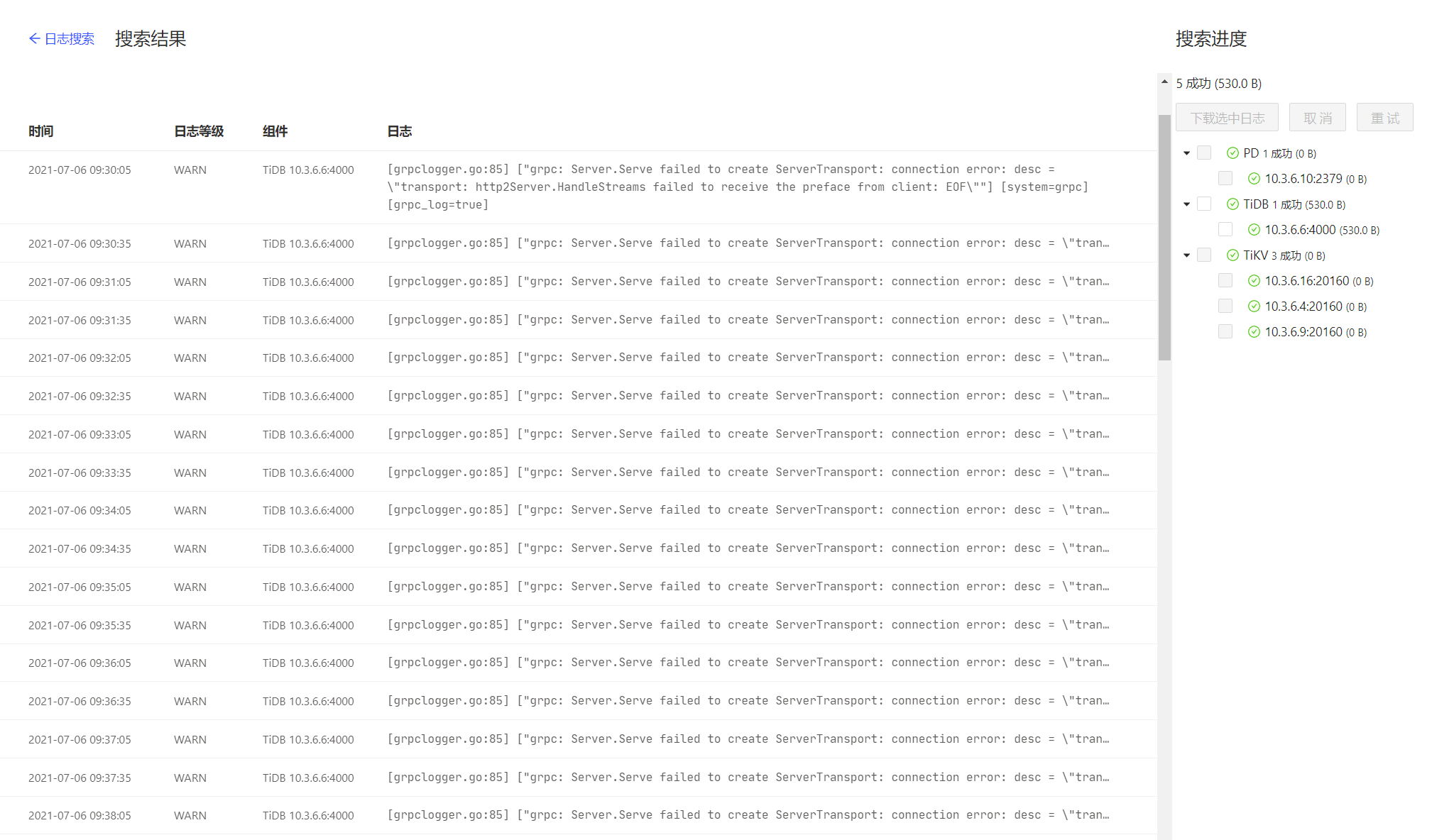

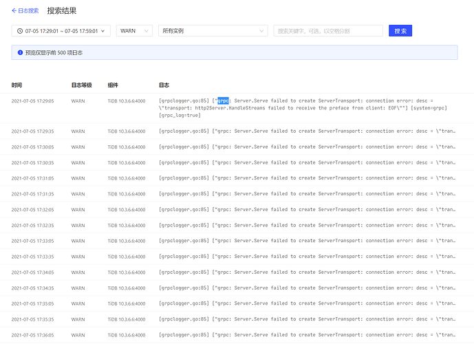

[grpclogger.go:85] [“grpc: Server.Serve failed to create ServerTransport: connection error: desc = "transport: http2Server.HandleStreams failed to receive the preface from client: EOF"”] [system=grpc] [grpc_log=true]

[grpclogger.go:85] [“grpc: Server.Serve failed to create ServerTransport: connection error: desc = “transport: http2Server.HandleStreams failed to receive the preface from client: EOF””] [system=grpc] [grpc_log=true]
类似这样的,这个貌似是个bug,但是不影响使用

是 v5.1.0 中一个已知的 bug ,可以参考这个帖子:
