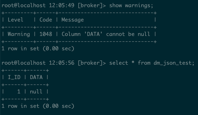

show warnings;
| Level   | Code | Message                      |
| Warning | 1048 | Column 'DATA' cannot be null |
select * from dm_json_test;
| I_ID | DATA |
|    1 | null |
